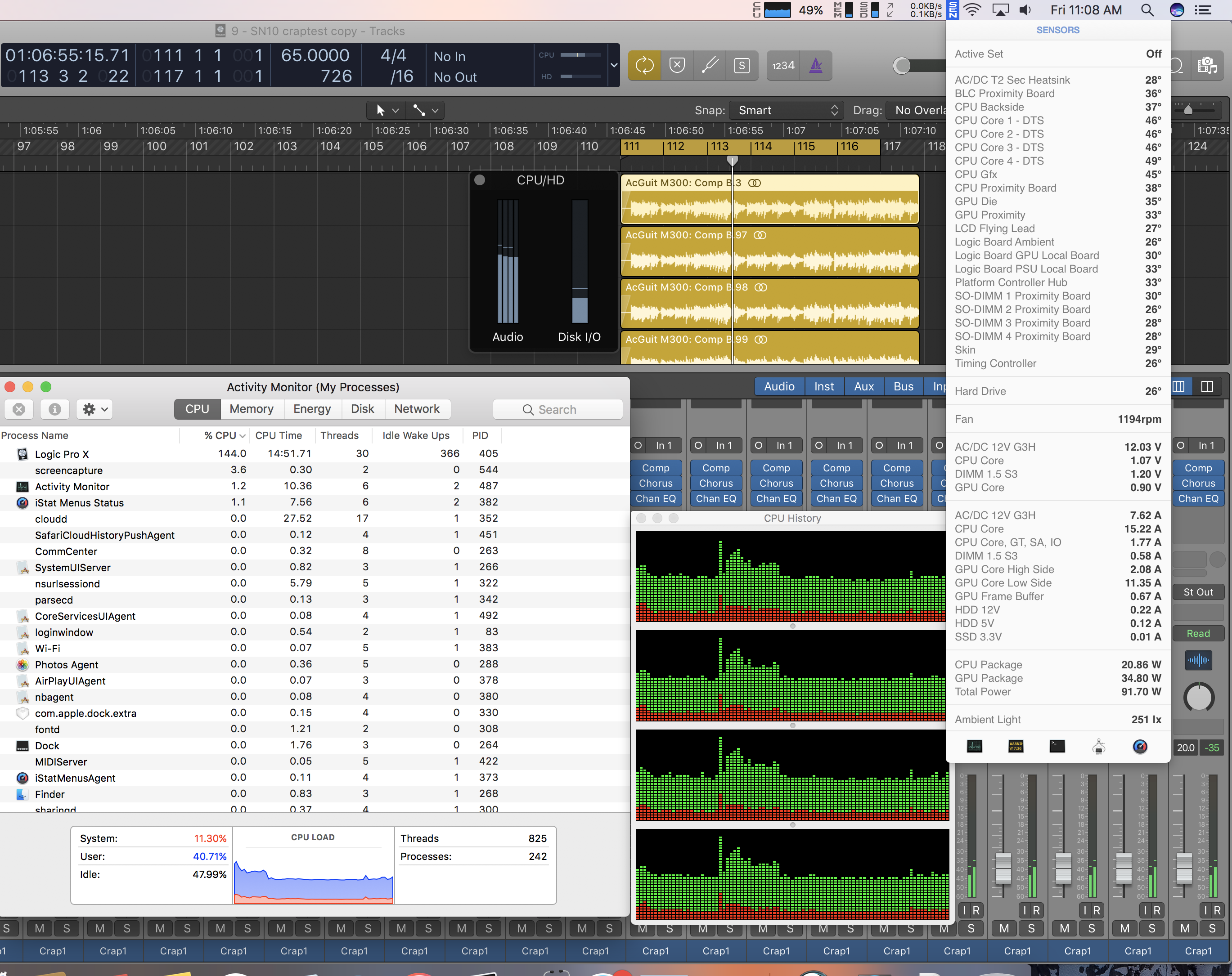

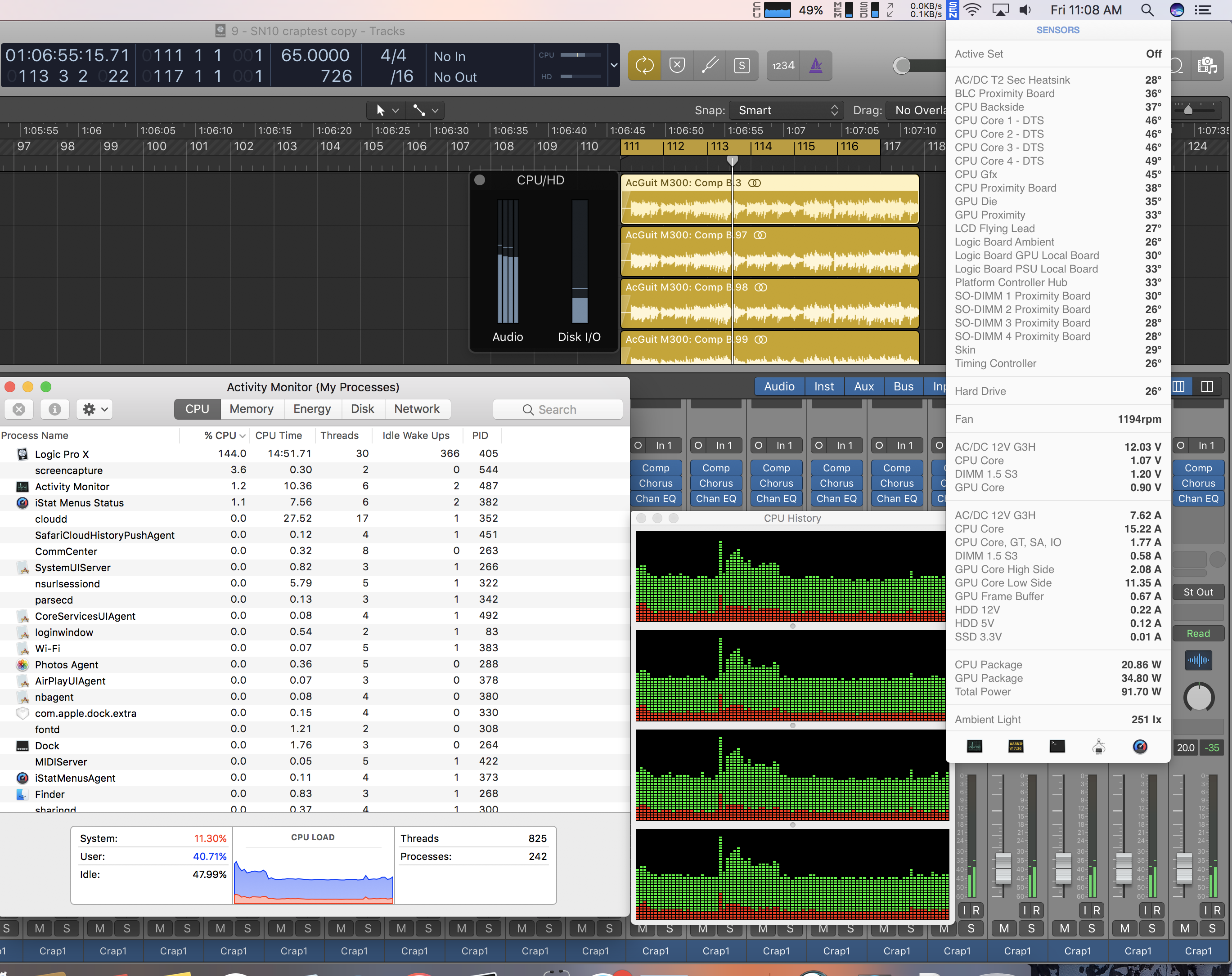

I have done some testing on the 7500 and 7700K. The big thing is that the cooling system for all of the iMacs is the same. It does a phenomenal job on the 7500 (i5 3.4GHz). 100% load gets to 60degC from about 40degC at idle. Fan never moves off of 1200rpm. The 7700K will go to maximum fan somewhere between 30% and 50% load. Still working on where this cut off is.
In Logic - I ran a 100 Audio track test with 4 drummers a reverb and 300+ plugins. 50% load on the i5, 50degC CPU. Same test on the i7 29% load, 77 to 88degC peak temps. The i7 was already close to where the fan would ramp up, the i5 had 50% more CPU to go.
I am currently checking ProTools performance and in general am finding the same trend - not ready to publish this yet though.
WRT video encoding (music videos) - all I do is 1080P camera + audio from logic or Pro Tools that is put together in iMovie or now Davinci Resolve for 720P Youtube videos. A 12minute video encode was 12% faster on the i7/580 vs the i5/570. 4min 20 sec vs 3 min 50sec. The fan kicked on after 2 minutes of the i7 - i5 never went above 60degC. Its not a bad fan but for audio mixing or recording I tolerate nothing above the idle 1200rpm...
my 2 cents 🙂
