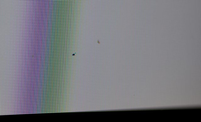

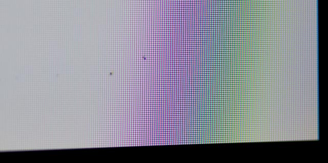

I have the absolute worst Apple luck, or they have the worst quality control. I am trying not to be livid, but good LORD this is really disappointing.
I just unloaded the iMac and got it all setup on the desk, started it, went through the boot process, and down on the bottom of the screen, in the right corner, I notice three "dots" all clustered together. I don't think this are stuck pixels -- it looks like dust got between the screen and the glass.
FFS
Pictures attached. I am very, very bummed right now as I know this will now be another 2 week turnaround, and there is no point in setting this up.

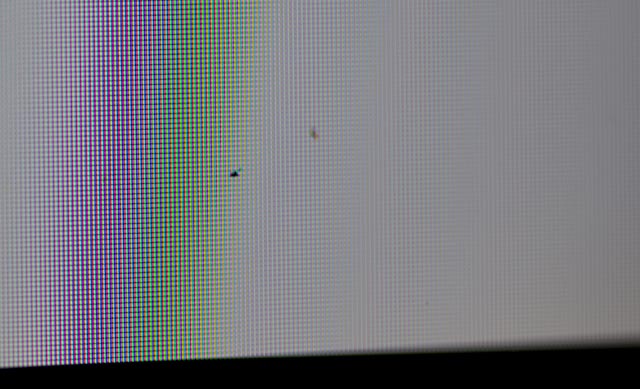

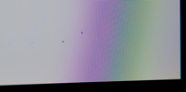

FFS

what are those purple/green stripes on there? Yeah if you think it's just dust, get yourself 2 suctions cups from an autoparts store, pull that sucker off, blow it off, and glass back in.
bah, if its just dust i'd pull the glass and clean it, stuck pixels on the other hand, send it back.
it's not hard to pull the glass, follow the ifixit.com instructions with the suction cups.
I've removed it before on my 24" iMac, not difficult, but seems daunting.
might be longer than 2week wait time, and it may come with stuck pixels next time.😎
