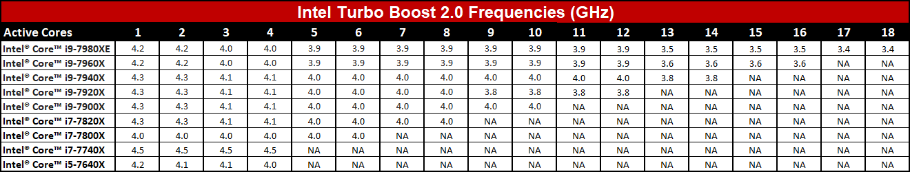

FYI on the turbo speeds at specific core usage, per http://www.pcgamer.com/full-details-for-intels-core-i9-processor-lineup/:
Pretty damned good really. We'll see if the iMac Pro can keep the i9-7980XE (edit, rather its xeon equivalent) and its 165W cool enough to keep it running at 3.4GHz with 18 cores active, but if so, that's damn impressive. The internet seems full of people hating on Intel for the low "base" clocks on these compared to Threadripper (and its 3.4 GHz base 16 core), which seems odd since this typical behavior for intel to have "base" clocks that your CPU never really operates at.
