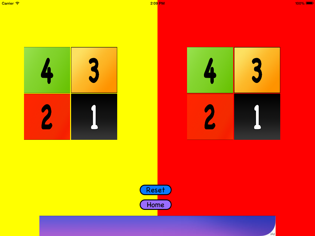

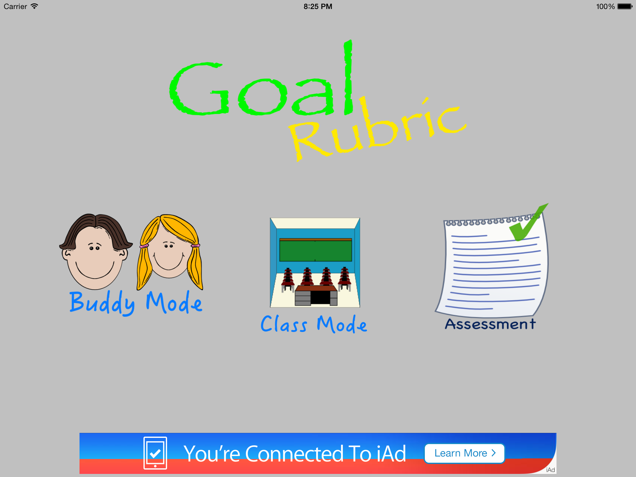

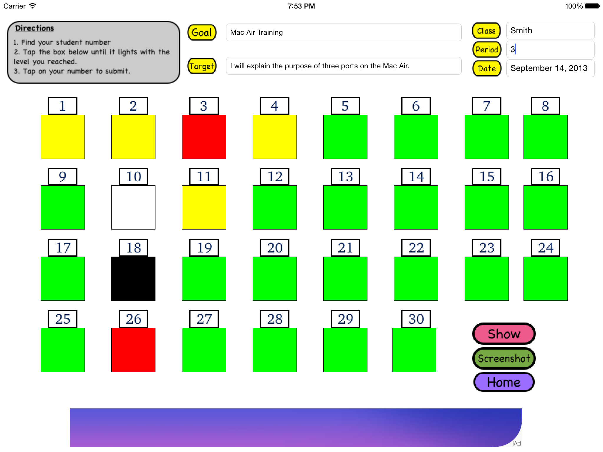

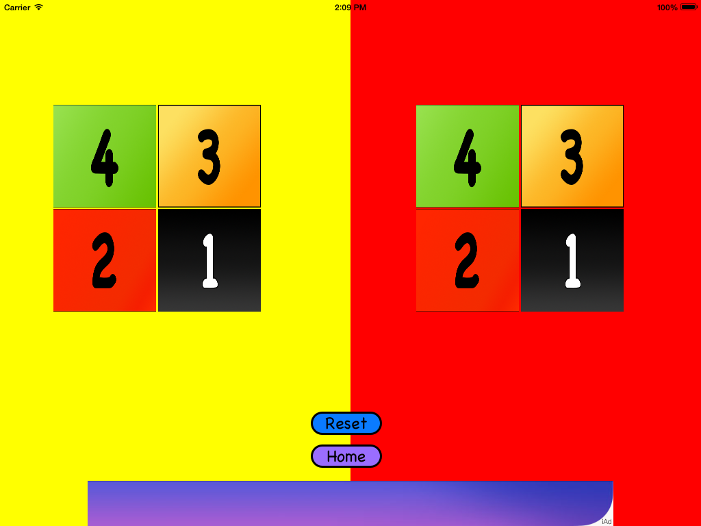

Can you provide screenshots of what your screen looks like with and without an ad? That should give us an idea of what we're dealing with. Thanks.

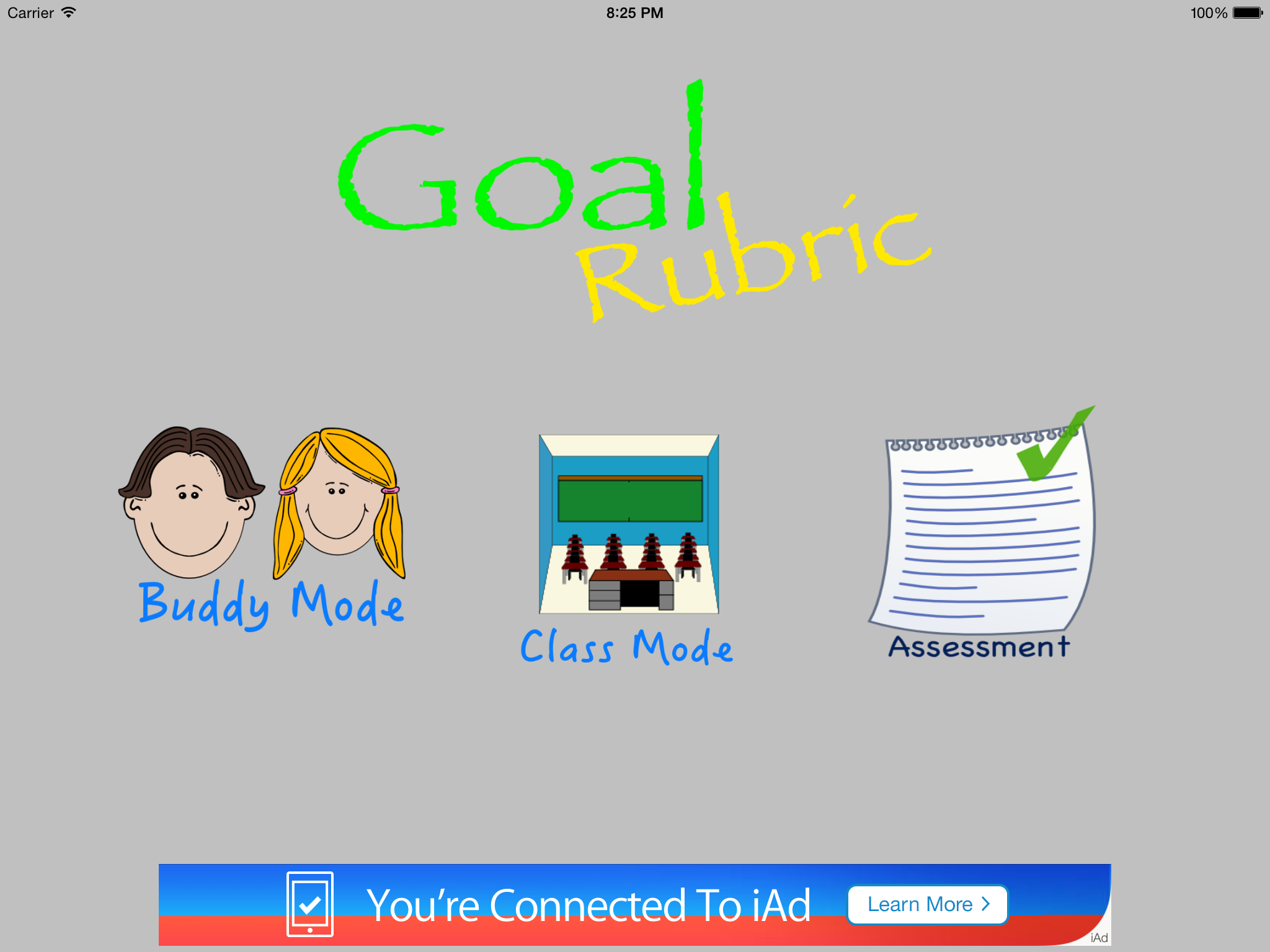

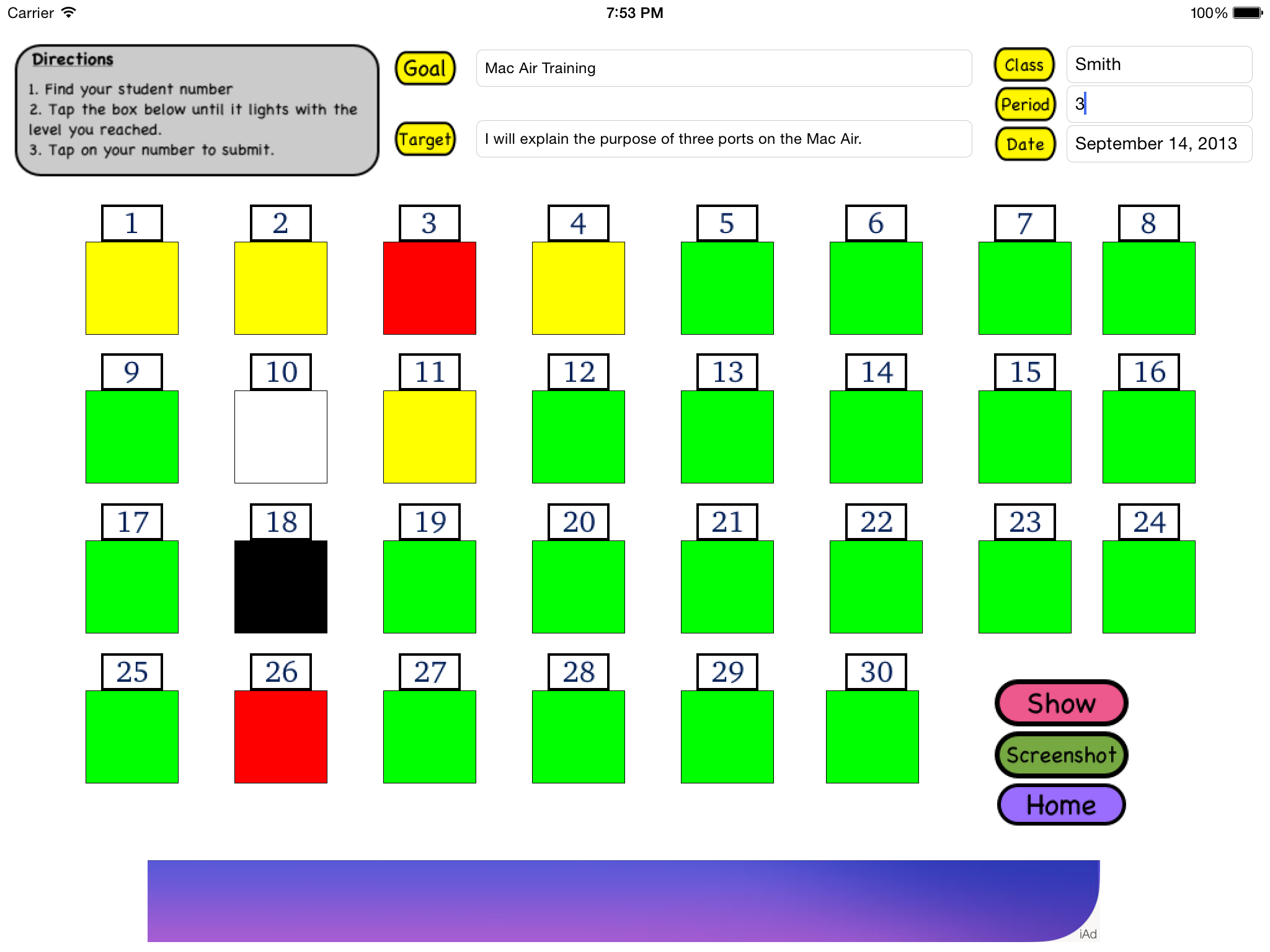

I'll try to get a few tomorrow. But to describe it is pretty basic. When iAD is not working, it's a white rectangle.
What confuses me is that my other app has been approved with the exact same iAd coding lol
Your earlier app must have slipped through the cracks, leaving a white rectangle is the issue, as far as i know.
Yeah, I just resubmitted my other app to fix the issue.

However, now my issue is (which I commented on the tutorial asking) is that in my app you have a main screen and then you have three other screens. You arrive there via modals on a button press. My three sections are "buddy mode", "assessment mode", and "class mode". When I code it in with the above tutorial, it does not load on the title screen. That is fine since once I click into a mode the ad will load up. However if I go home, and then into another mode...an ad does not appear... any suggestions to get ads on all three of my modes?
app is in the iPad store "Goal Rubric"--free
