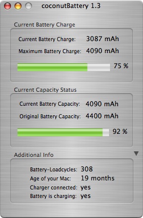

Download this awesome app - coconutBattery.
http://www.coconut-flavour.com/coconutbattery/
Upon loading it up you'll be presented with a similar window to this:
Compare the original battery capacity to the current one. If it's low then you will need to replace the battery.
excellent app but my mac was bought in April ? i doubt it is really 19 months old ?
That's cool, but unfortunately it requires Tiger. So what should I do with my $100 -- upgrade to Tiger or get a new battery?
I highly suggest getting Tiger. You never know, it may fix your problems. If your battery is knackered you generally know about it because it doesn't last very long on a single charge (as in <1 hour).
