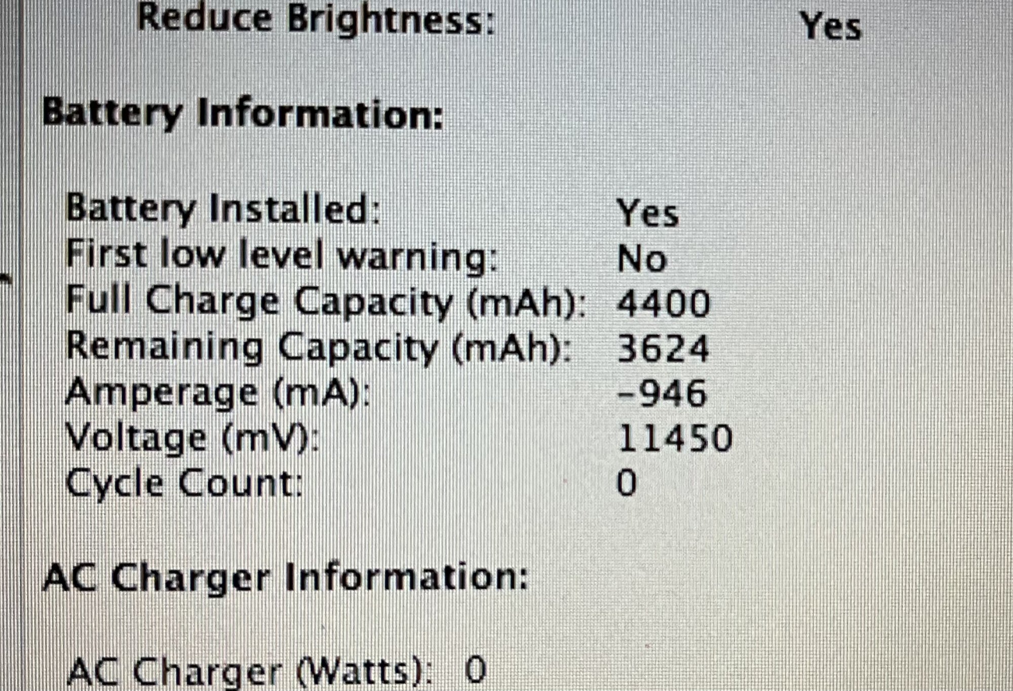

Interesting. This one has a low cycle count

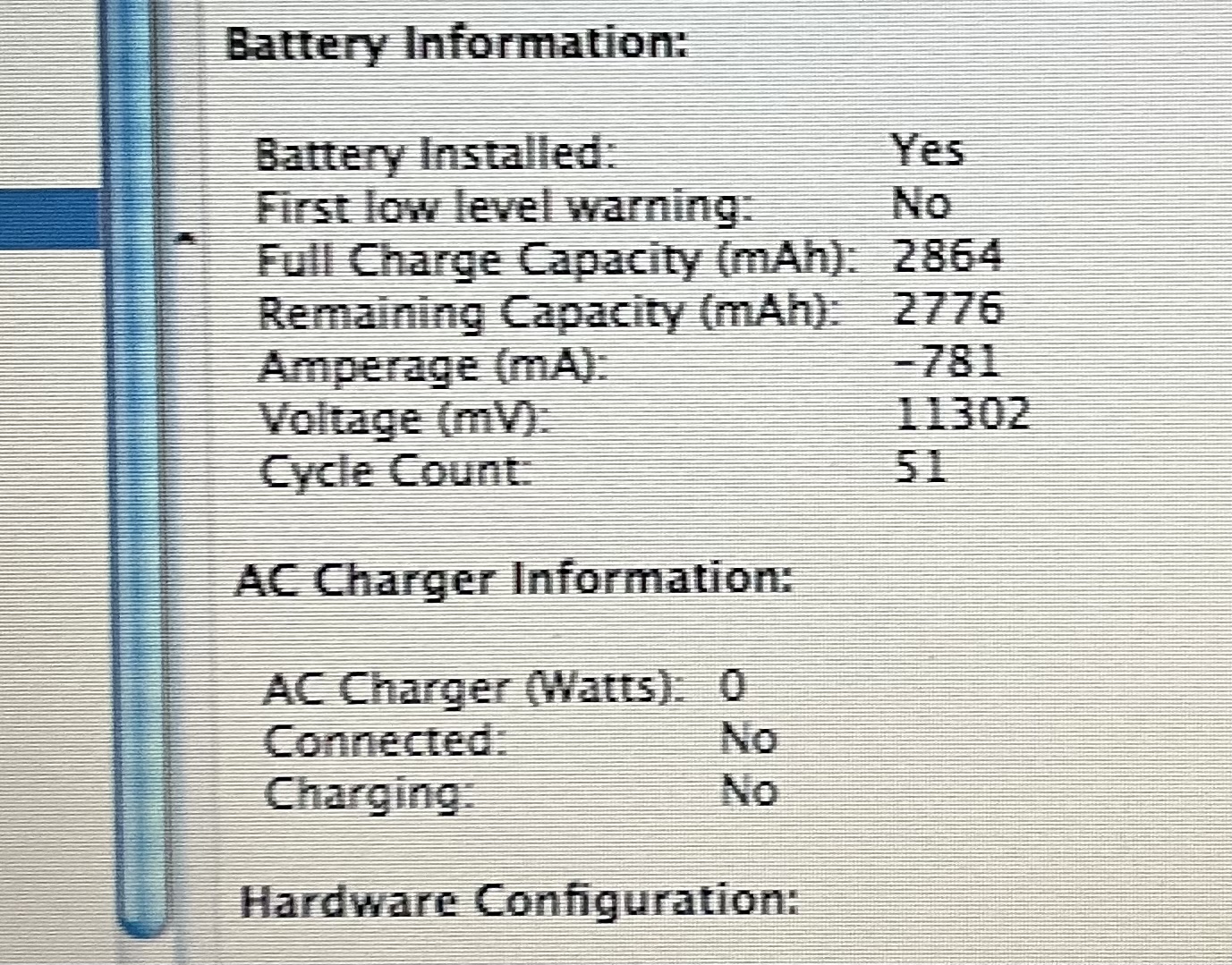

This is the other battery but it’s hard to believe the cycle count is 0. Physically, it’s dirty, scratched, etc. It looks like it lived a hard life.

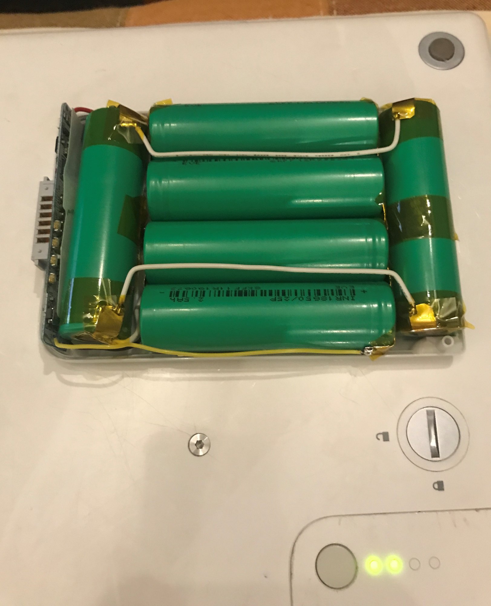

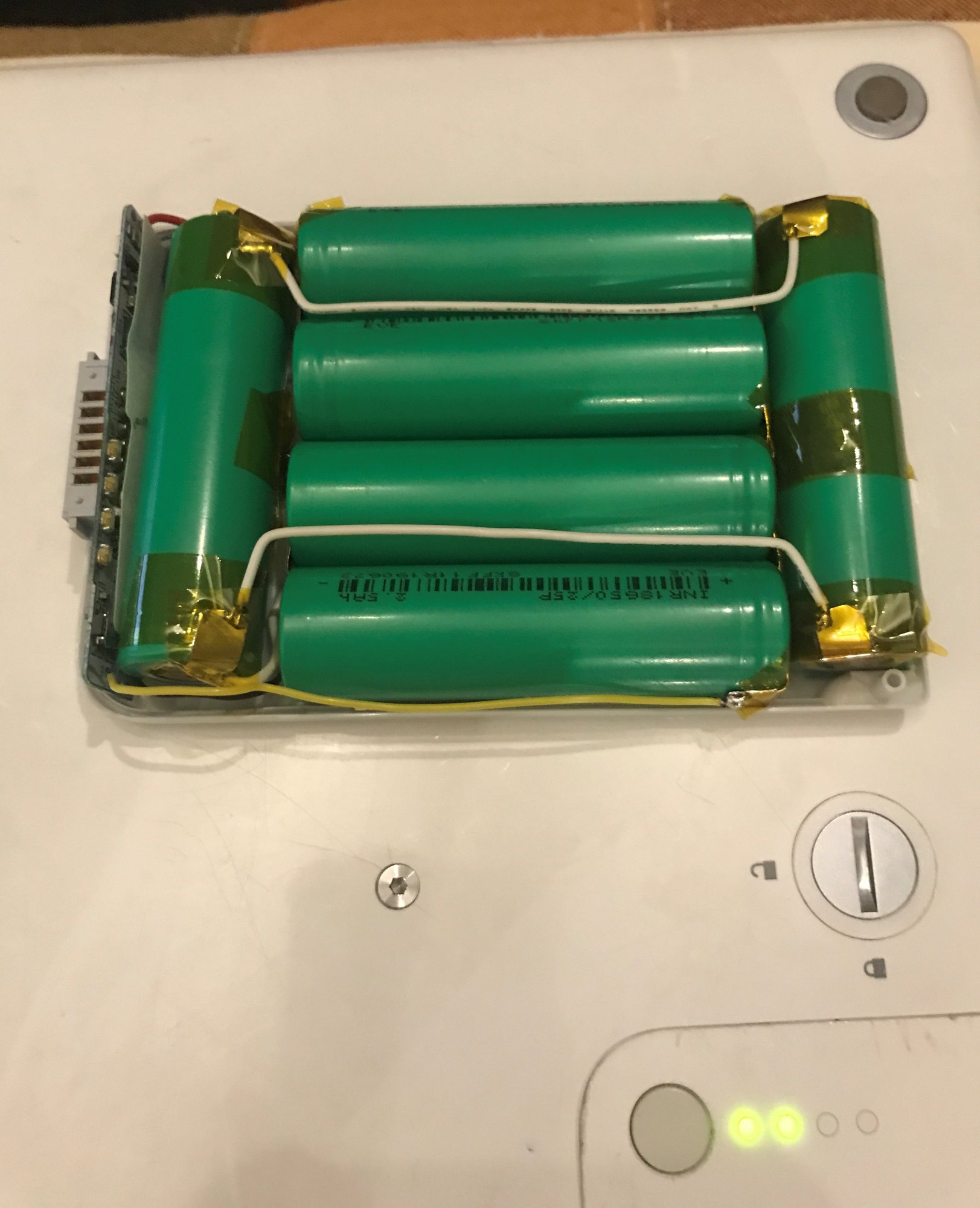

I bought some of those batteries from the same eBay seller. I don't know if it is proper to calibrate them, but I found it mentioned to do many times in my Internet search. I figure, if it is "VERY VERY old advice," then it matches the very old battery packs. I think the calibration only makes the BMS (Battery Management System) PCB inside the battery pack calibrate and send the data to the computer, where the System Profiler can show the results and the battery icon can display the % or time left. I don't think it is to rejuvenate the cells, and in fact, I found it true that a full cycle of discharge/charge reduces the Remaining Capacity number. I did it a couple times to see if it would calibrate it better but I think once is probably enough (if at all).
The reason I bought those batteries was to see if I could rebuild one using new lithium ion cells. Those batteries are about 20 years old so I didn't expect them to have any life, but I figured if the case and BMS inside was still good, I would put in new cells. I did that to one and it now works like a new battery. I posted a few days ago asking about a second battery that I rebuilt that won't calibrate. Nobody has answered my post, though. The cells I put in are brand new but I may have damaged the BMS or it may have been bad already. If you want any information regarding how I rebuilt the battery packs, I'd be glad to answer.

Do you have to solder or spot weld?

I made a spot welder with a car battery as shown on some YouTube videos.
I think you're right. if the batteries you got are working well, you should just use them for as long as they last. I bought a second set of two that just arrived today and one seems to be pretty good so I'll use it for now. It's really kind of involved to rebuild them. Before that, I bought a 3rd party battery on Amazon for $65 and it wouldn't even charge up all the way. I returned it but had to pay $10 for shipping back. That made me learn how to rebuild them.
