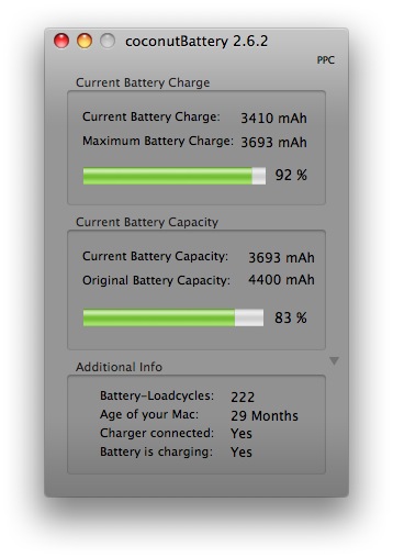

If it'll help, here's what Coconut Battery says right now:
Did you try resetting the PRAM? Also the battery will not charge if it's at 95% or more.
Haven't tried resetting the PRAM yet, but I'll give it a shot.
How does it get up to 100% charge, if it won't charge past 95% or more? When I turned it off earlier, I'm pretty sure it was at 99% and said "finishing charge."
If you take your laptop off the AC adapter for a few minutes and drain it down to say 95% and then plug it back in, it will not charge battery. You have to take it off the charger to drain it further down before it will charge back up. Sorry if I didn't explain that correctly. It's also good to drain your battery completely at least once a month to keep the battery "healthy".
I know when one of my batteries wasn't reading accurately, I did the PRAM reset but I kept it held down until it restarted about 5 times since it didn't work with just one reset. Hope this helps.
Wow, so the "battery is not charging" thing is normal? I'll explain what I was doing a little better. I was sitting in the recliner in the living room with the iBook plugged in. Since we don't have a table there, I got up and unplugged the iBook and took it over to the coffee table, so that I could have a cigarette and then about 10 minutes later, I plugged it back in and it was at about 91% and it said "battery is not charging," so as I said earlier, I tried my MaCally power adapter and it did the same thing, so I then unplugged it for a few minutes, then plugged it back in and it started charging.
So I guess this could be normal, if I understood correctly. I'm pretty sleepy and I think I'm getting the flu, so I'm a bit "foggy" at the moment. 😛
EDIT: I ended up going ahead and resetting the PRAM on the iBook (which I'm typing this on) and I'm running it off the battery right now. Gonna run it for a little bit more tonight on the battery, then do it some more when I wake up and go ahead and run it down and charge it back up again. I'll report back.
Okay, I ran the battery all the way down to empty, then plugged in the power adapter and just as I figured, it said "battery is not charging." It was showing that the power adapter was connected, though. I then shut down the iBook and took the battery out and put it back in, turned it on and it is now charging. Man, this is puzzling. Does it sound like I need a new battery or what? This battery holds an awesome charge (around 4 1/2 hours of normal use) so I don't think that's the case.
If anyone has any ideas what could be causing this issue, I'd be very grateful. Thanks in advance. 😎
EDIT: I've came to the conclusion that the "issue" I was experiencing is most likely just normal behavior. Usually, when I unplug the power adapter and run off battery power for a few minutes, then plug the power adapter back in, it'll say "battery is not charging" for a couple of minutes, then it'll start charging. This is probably just normal. I've never really had a laptop that I've used (or loved) as much as this iBook and I'm figuring that I was just reading too much into it, as I usually do. 😛
