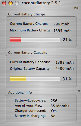

I am having some issues with my battery this is the life I am getting on my ibook battery is this normal for iBook G4s? Also next to my battery, underneath the lock is this big spot that looks like tiny cracks in the casing. That spot also feels like it is coming out of the casing... is this covered under warranty?
Any answers or advice would be much appreciated thanks a lot everyone for your time!

As long as your iBook is still under warranty, you should be able to get a replacement battery. If you call Applecare, they'll ask questions about battery cycles and capacity. With those numbers, they should send a replacement along with a pre-paid return box for the old battery. I recently had my battery replaced -- it wasn't nearly as bad as yours, and the process was very easy.
Can't comment on the cracks.

If this is your original battery, it's served you very well. Your iBook is nearly 3-years old and yes, unfortunately, all batteries fade and die. It is not covered by any warranty at this age. Go buy a new one yourself and hope that you get another three years of reliable use from it. My iBook G4 is on its second battery, and that second one is up to 330+ charge cycles, and it's just slightly better than what yours is showing. Time to spend some $$$. :apple:
