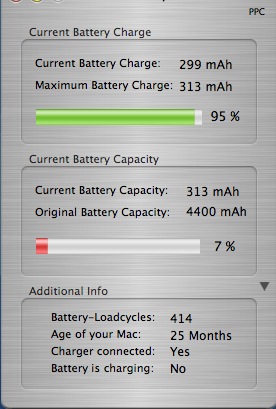

I've noticed a strange problem with my 2 year old iBook the past few months. When I connect the charger, the LED light would go to the usual amber charging color, but then it would flicker to a dark red, and then to a green (although not fully charged), back to amber again, etc. repeat. During this time, the battery indicator would show "Calculating..." at the top, and would stay that way for about 3 minutes until a time showed. The LED flickering would continue while the charger is plugged in. Is this just a sign of old age, or should I be worred about an electrical/battery problem?
Here's the current battery stats, if that would help:

It could be the battery. At 415 cycles, yours is getting old. Did you battery qualify for the replacement program, and if so, did you replace it?
https://support.apple.com/ibook_powerbook/batteryexchange/main?id=qp
It might be time for a new battery regardless. If your max charge is only 313 mAh, you can't be getting good battery life.
what program is that? thanks
That's CoconutBattery. Not yet fully compatible for Leopard.

with 7% battery health left, i wonder how long can you run the notebook on battery??
