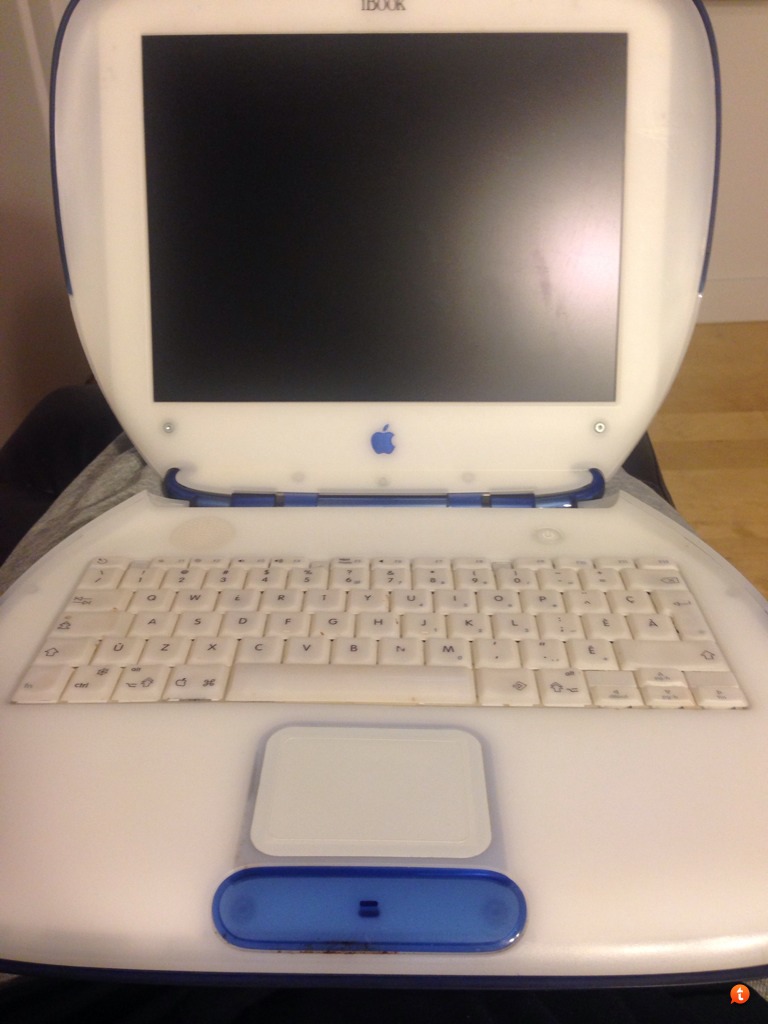

I just picked up a blue clamshell for $20. When I tried it out at the buyers it was finicky but turned on and worked just fine. Bring it home and I can't get it to power on. Battery is long dead but I have the correct power adapter from my other clamshell. No charging light comes on and it won't boot. I've tried pressing the reset, also the Pmu and still nothing. Am I now the proud owner of a cool paperweight?

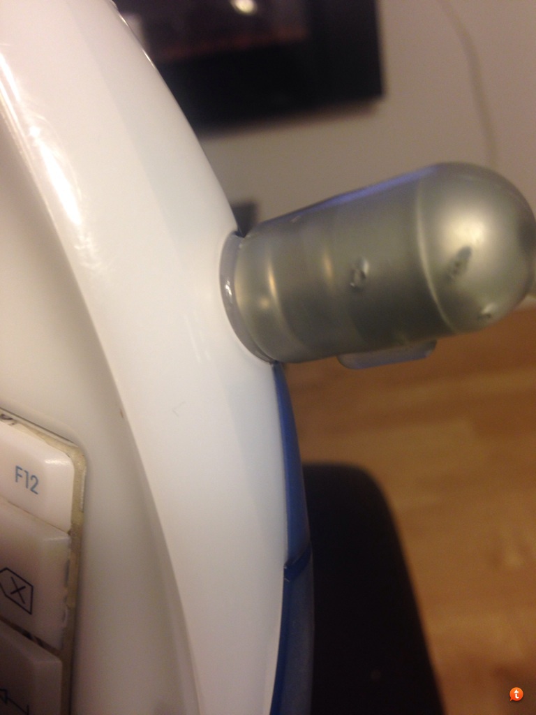

Nope no noise, I did notice last night where it plugs in got a bit warm.
I would replace the DC-in board. Symptoms are: You hear it buzzing or a cap buzzing, it gets hot (I burned myself on a DC-in board on my first iBook once 😀), If you twist around several times and it changes colors briefly, extremely hot adapter after a while, etc. Also, one easy way to check is digging into the iBook and checking the jack into which the DC-in board plugs in, and seeing if a multimeter detects voltage. If not, it is indeed your DC-in jack.
