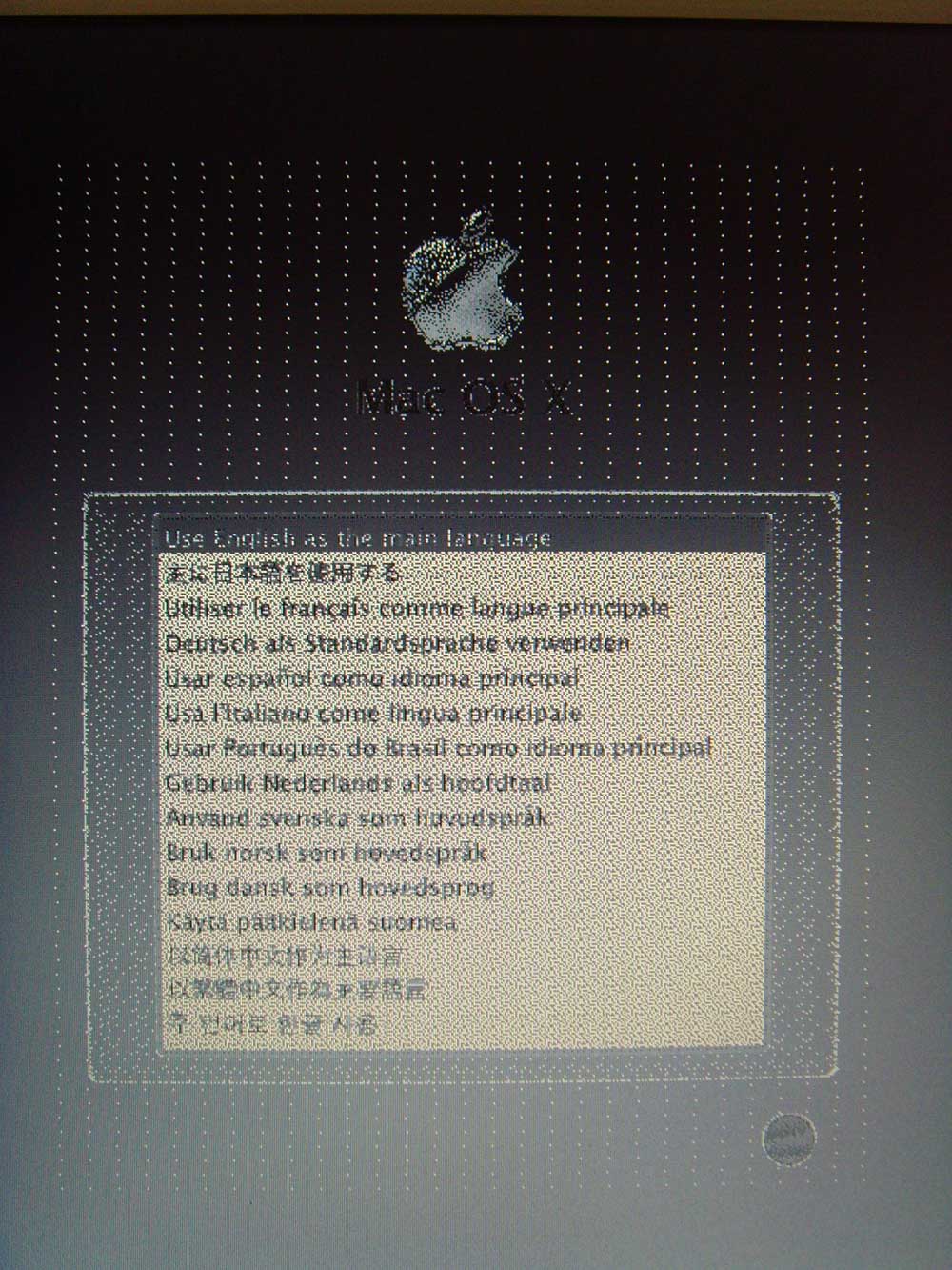

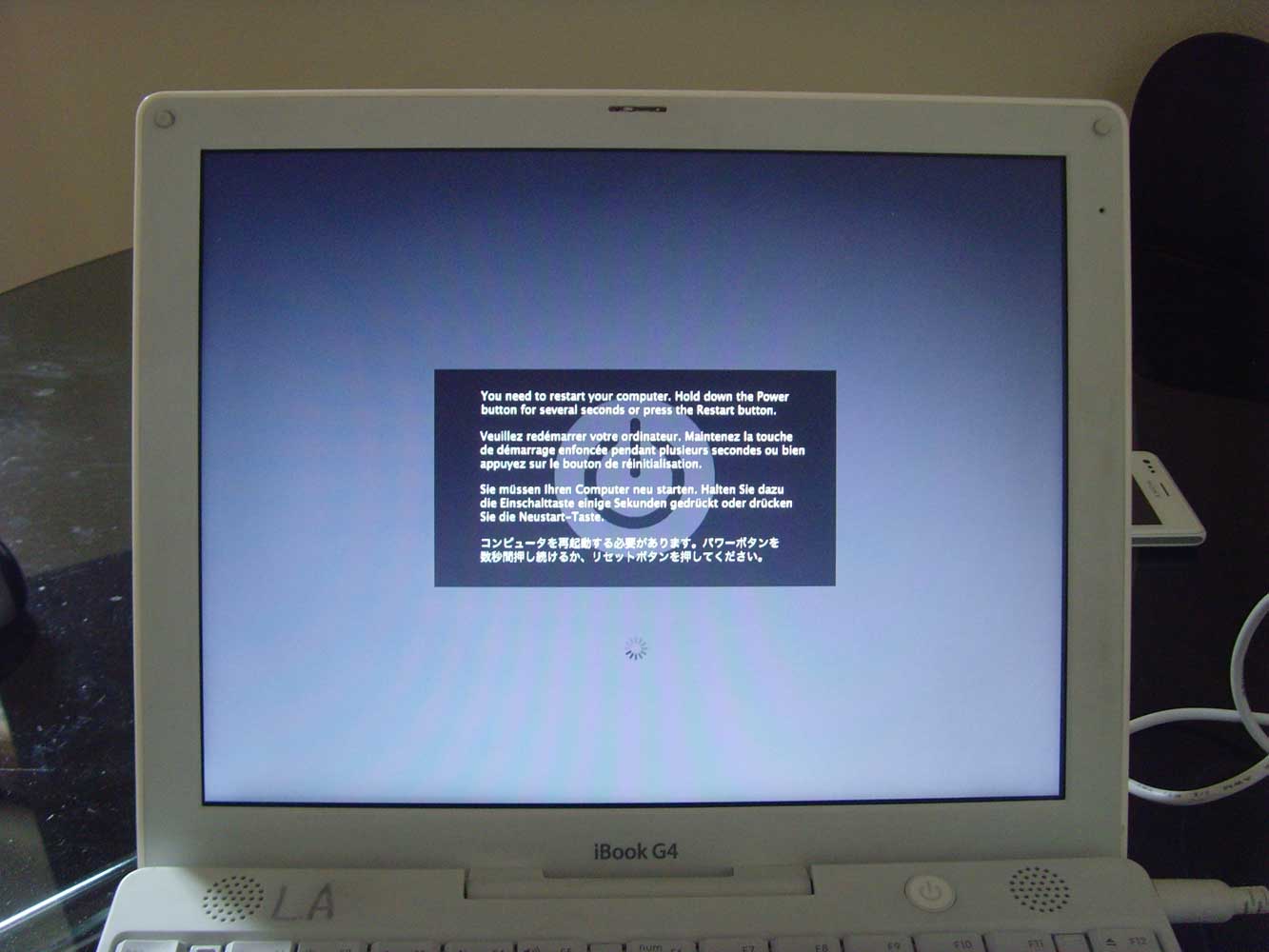

Ok...I've just bought an iBook from ebay, 1.33/512Mb 12" and run into problems straightaway. Turning it on, it started a self install of Leopard (from an image on a separate partition) but on first reboot got the dreaded crash screen (attached). After a few unsuccessful restarts I decided to install Tiger (which is what I'd have done soon enough anyway with only 512 RAM) but got exactly the same crash - goes through the install but crashed when booting from the hard drive. Tried again but this time zeroed out the drive to hopefully flag any bad sectors - same result. Tried again but this time got the garbled screen, so zapped PRAM, removed battery, held power button for 10 secs - back to normal screen but still crashed at first reboot.
Next, put iBook into target disk mode and ran DiskWarrior from my G5 over it for any disk errors but all appeared fine, so installed Tiger from the G5. All went well, with the G5 booting into Tiger from the iBook drive.
Restarted iBook and again, crash at boot.
Any ideas? The target disk install would indicate the hard drive is healthy but the iBook can't start from it - is there some hardware conflict that only occurs when booting from the hard drive?

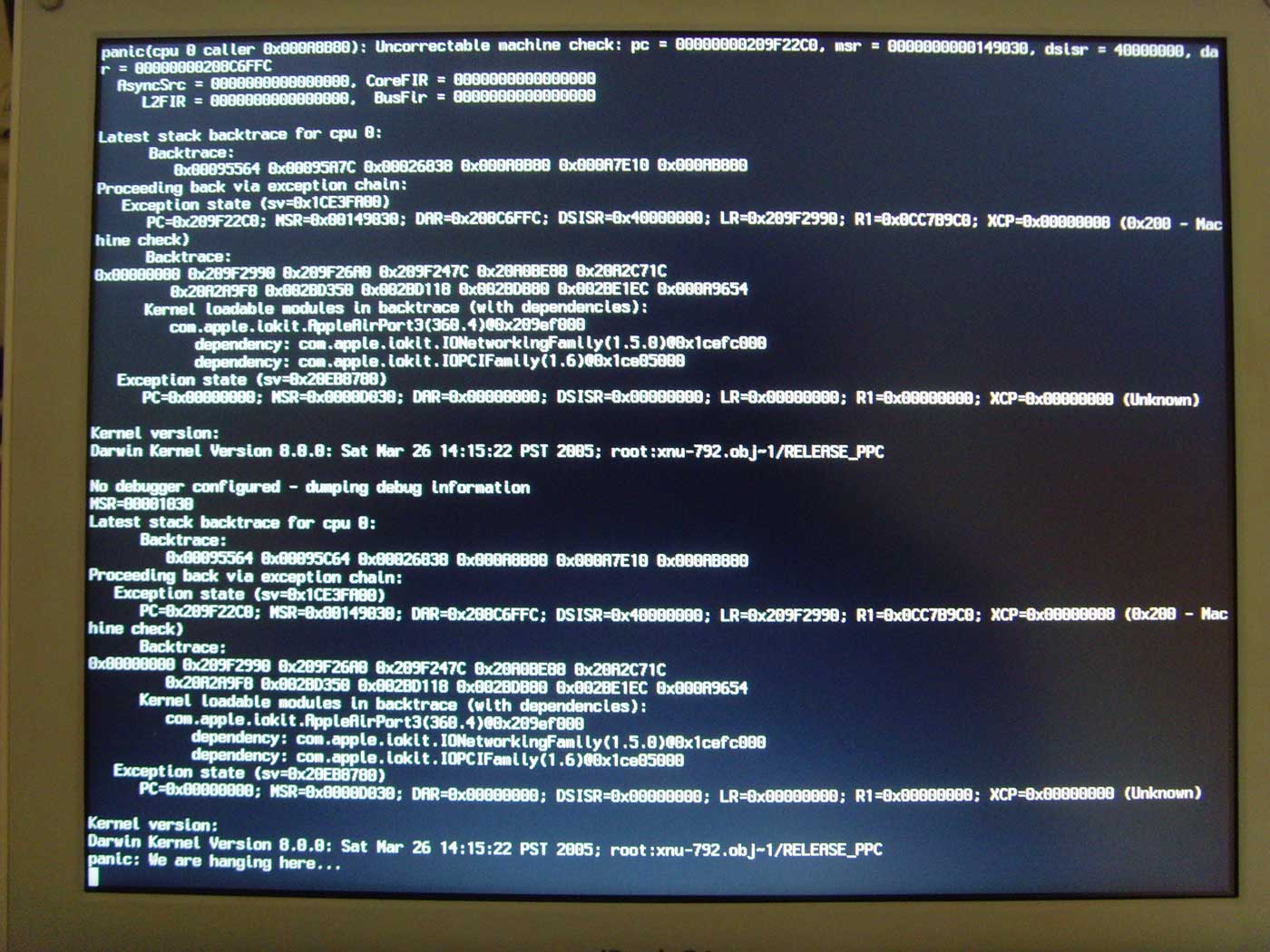

A little progress..whereas open firmware verbose crashed, command v does get me a text output...no need to decipher what the "hang" message means!

If anyone speaks Unix, this is the dialogue at halting (attached)

I don't "speak unix" so can't read anything into that.
With that said, you might try booting into single user mode(command+s) and, assuming it boots, run fsck by typing /sbin/fsck -fy

Yes, that works - reports disk ok but when I continue to boot in single user the system hangs. Guess there some motherboard damage somewhere?
That Looks like its caused by the iBook G4s Built in Wifi Card its a Known problem with this model of ibook G4 Try removing the wifi card from the logic board it should stop the kernel panics
I also agree that it is the Airport card as this has caused trouble in a iBook I had to work on for a customer 🙂 It usually isn't the actually an Airport card issue but actually a Logic Board issue, so at the trade of a working computer you will have to use ethernet

LightBulbFun and Orizence, looks like you're right - from what I've read online it is the airport issue that so many have already suffered with. I dug deeper to see if I could disable the card in software as I'm still reluctant to crack that case open and found someone who had success booting their iBook by putting pressure on the case near the option key, then overwriting the airport kexts in the System Extensions folder. I did the same apart from I moved the kexts instead of replacing them with duds and so far it appears to have worked through a few restarts. As to whether it's the missing kexts or the pressure under the keypad has bent the card connector a little, I wont know until I turn it on again later. Worse case is I'll have to open it up and remove the card.
