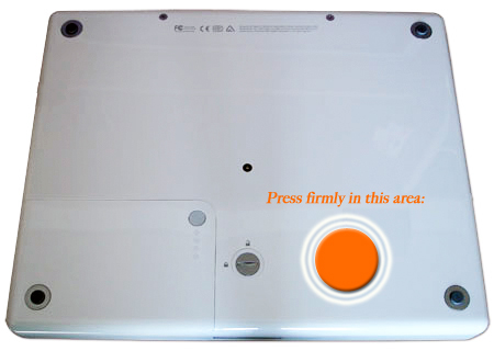

Flip it upside down and near the battery release mechanism just to the right of the battery, press firmly down into the plastic. Now see if it boots up 🙂
These are notorious for their faulty GPUs and over time the chips would separate from the logic board. Applying pressure seats the solder ball joints back together allowing the iBook to work again. You can also put a "shim" on the inside to keep pressure on that GPU chip. This will only work for so long. You could also always try a heat gun and try to reflow the solder.

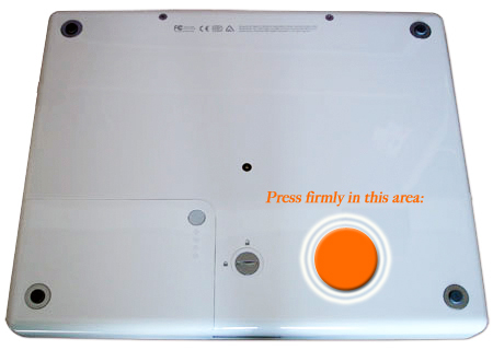

pressure applied, nothing, but will get a heat gun on it though. seems as though that's what it is.
cheers for the help.
