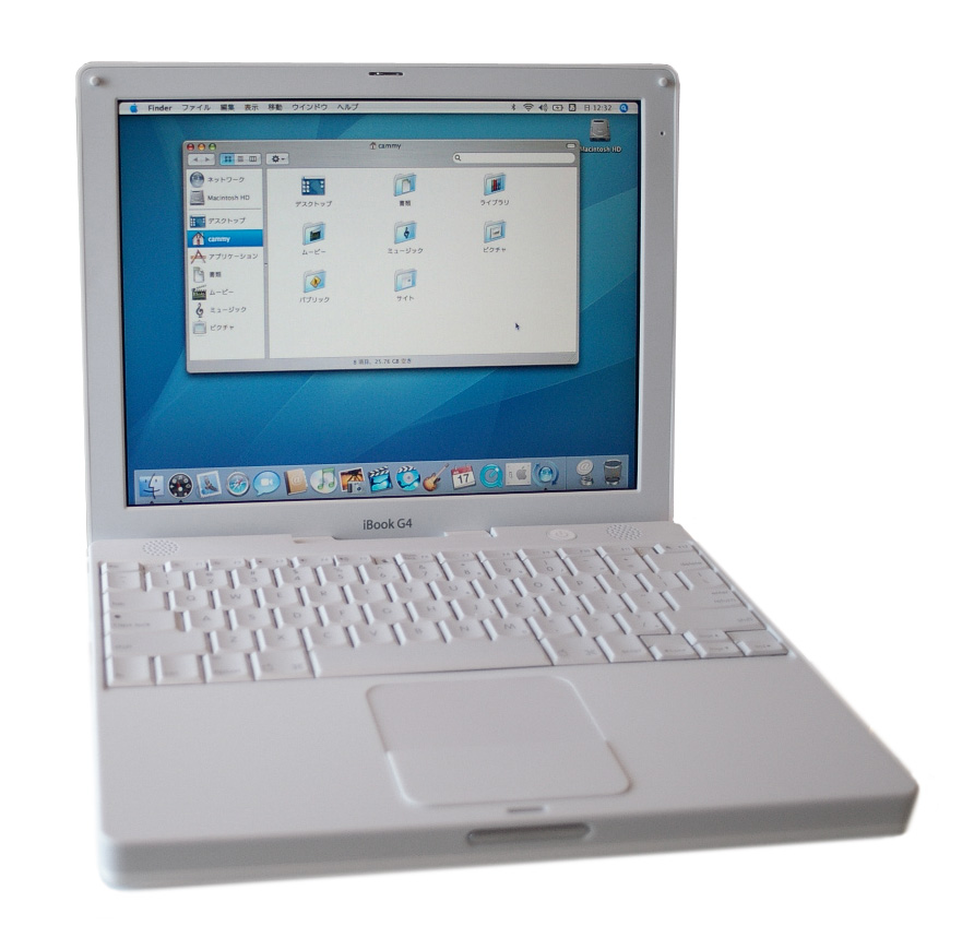

First of all is this an iBook G3? I am totally new to Apple in general other than my iPhone.
So this will be my first mac. It is being offered for $100 because the screen will no longer show. The seller says he can sometimes get the screen to come on but not for longer than five minutes. Is it worth it to pick up and mess around with and try to fix? How much will it cost to fix if I take it in somewhere?

The G4s don't have the translucent keyboard and they say "iBook G4" on the bezel; it's a G3...
