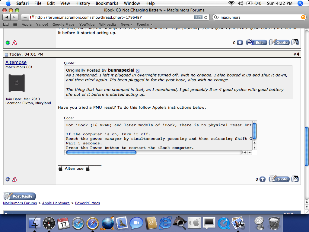

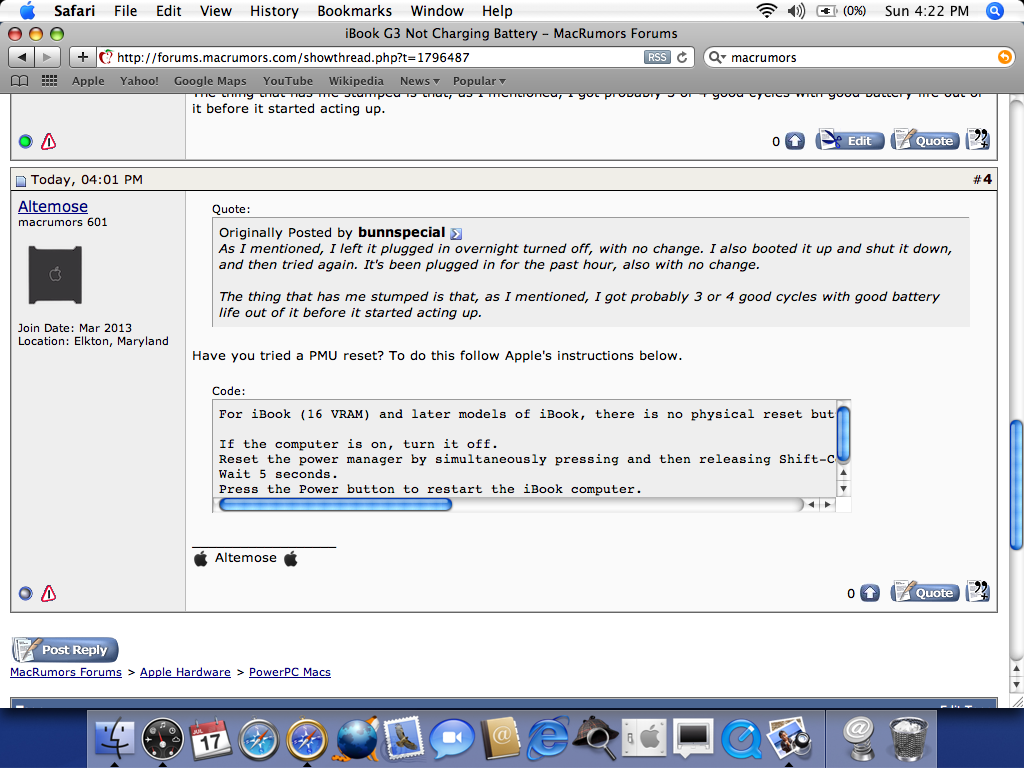

Have you tried a PMU reset? To do this follow Apple's instructions below.
Code:
For iBook (16 VRAM) and later models of iBook, there is no physical reset button.
If the computer is on, turn it off.
Reset the power manager by simultaneously pressing and then releasing Shift-Control-Option-Power on the keyboard. Do not press the fn (Function) key while using this combination of keystrokes.
Wait 5 seconds.
Press the Power button to restart the iBook computer.
A PMU reset was a good idea, but still no luck

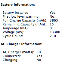

Unfortunately, the replacement is a no-go. It will not even turn the charger LED amber...
I did try going through and burnishing the contacts in the battery compartment with a pencil eraser to take care of any potential dirty or corroded contacts. Still no luck.
I'm hoping that this is just another bad battery, and not a problem with the computer.

Just thought I'd give an update to this...
I managed to find one of the aftermarket 65w chargers kicking around at school and was able to borrow it for an evening to check it with my computers. This charger also charged my TiBook fine, but gave the same symptoms I'm describing with the iBook.
I emailed the company that I bought the battery from, and they sent me a second battery out immediately. The second battery worked fine with both generic charger, and with my 45 watt TiBook charger.
I now have the proper 65 watt Apple-branded charger in hand, and am getting the same results-it will not charge the OEM battery or the first replacement, but will charge the second just fine.
So, I think that my issue was likely a combination of a now-dead OEM battery, along with a bad aftermarket battery.
With the good aftermarket battery, the battery life is surprisingly long. I've been getting in the range of 3-4 hours, depending on just how heavily I'm using it and whether I'm running under OS X or OS 9(the battery seems to last longer under OS 9).
