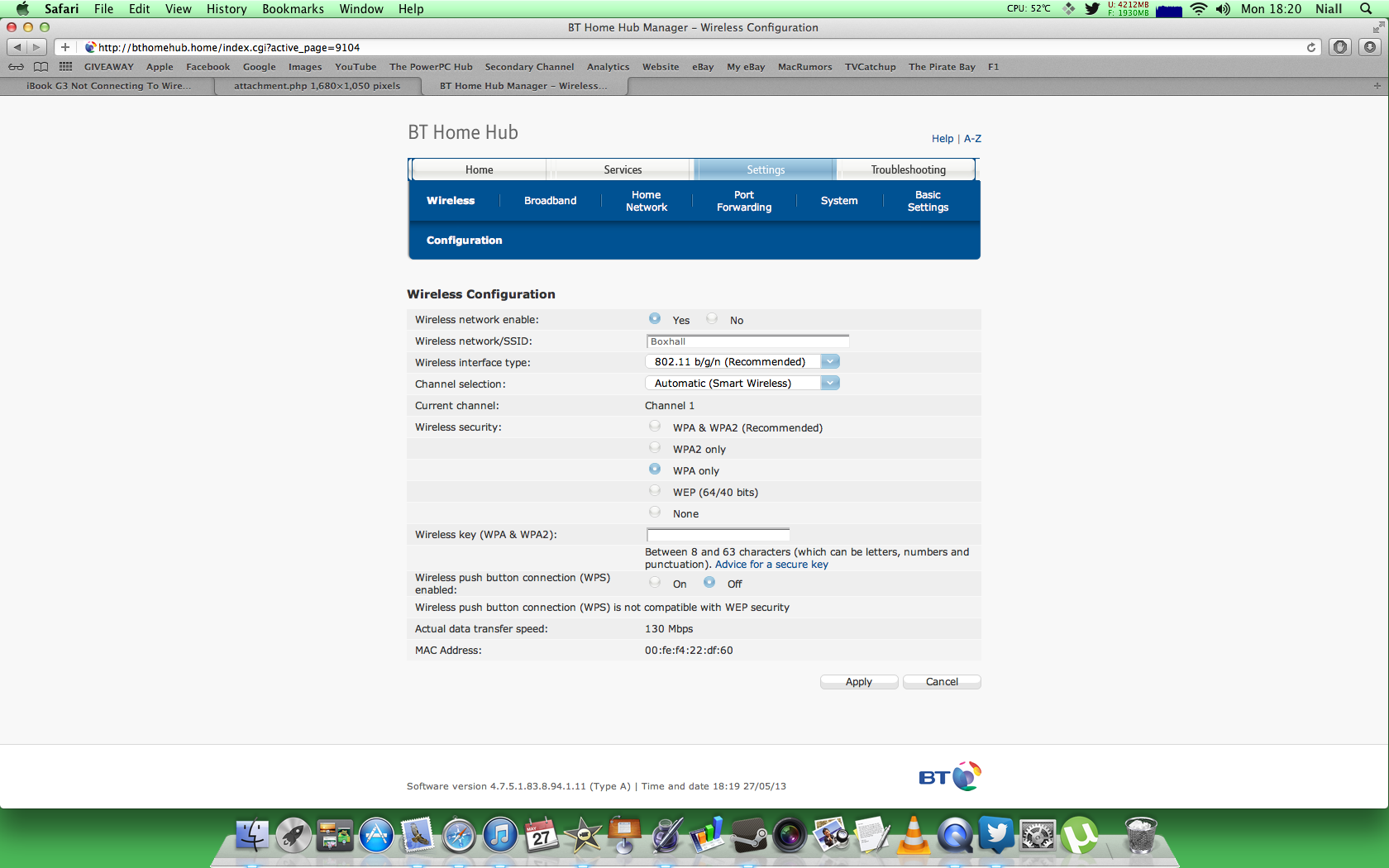

The network is running WPA and not WPA2, correct?
Is the Wireless Access Point you are trying to connect to (your router or whatever you use) set up for a mixed network?
You can have WPA or no encryption but if you are running a 802.11G (or N) network only the your iBook will never connect. You need to run a mixed mode of 802.11A/B/G/N to enable your iBook to connect to the WAP.
Yep, it's set to b/g/n.
Encryption? AES or TKIP?
I find that if I have mine set to AES my son's TiBook cannot connect.
I was wondering that - however there doesn't seem to be an option to change between TKIP & AES.
I thought TKIP comes w/ WPA2 & AES w/ WPA?
EDIT - just found some more info; the homehub (router) defaults to AES when WPA or WPA/WPA2 are selected - the only way to get to TKIP is to choose WPA2 only.
