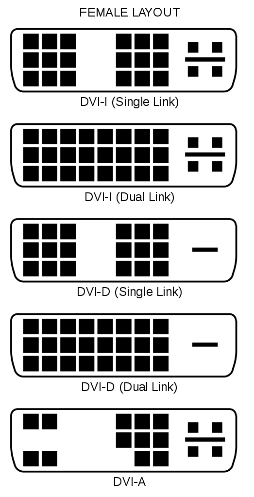

Refer to this chart to see what kind of connector you're looking at:
If you have DVI-I (instead of DVI-D as you've stated), you might be able to use a passive cable to connect your monitor as you've outlined.
If you actually have DVI-D, you'll need an active signal adapter to make it happen.
It might be more cost-effective to get two adapters: one to adapt VGA to HDMI (actively), and another to adapt HDMI to DVI-D (passively).
