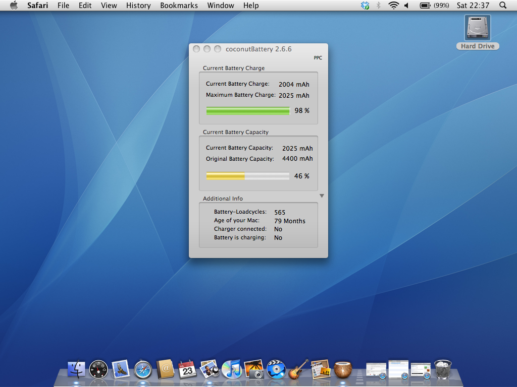

I have done allready, i keep killing the battery, charging it up, and then using it up.
I ran coconut, and got these results...

Ah, okay, cheers guys.

my two cents after supporting 100's of ibooks over lots of years.
i've had several batteries with the same symptoms after long periods of sitting on a shelf out of a system.
50% chance that a cell is dead, the battery will no longer function, recycle and replace is the only fix.
50% chance that the cal/recal sequence will need to be run 10-15 times to get the battery back to a happy place.
it's been about 1 out of 2 that would actually start to work again after several (lots) of drain/charge cycles. make sure you go to 'system preferences>energy saver' and click the battery tab and set both the screen and sleep to 'never' so the thing won't try to save it self when draining the battery. i had one that got to zero percent remaining, and then ran for another 1.5 hours while playing a movie...
if it works after lots of cycles or you replace the battery, remember to change the 'energy saver' settings back! best of luck.
