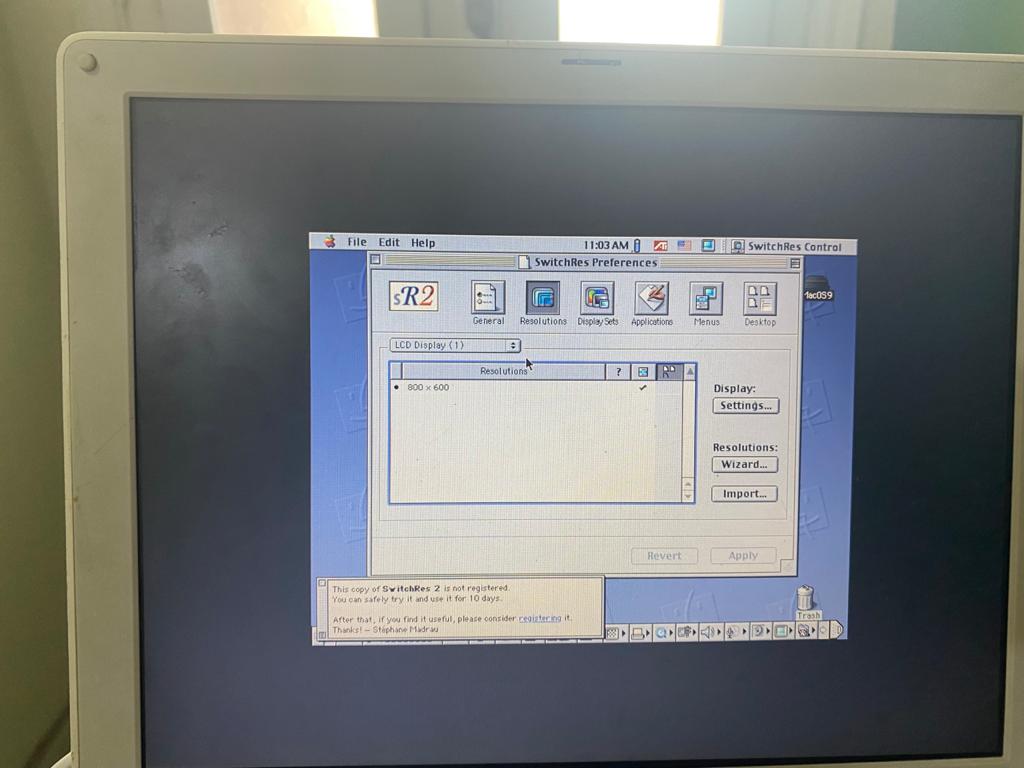

i managed to install Mac OS 9.2 finally after trying several times for weeks
by flowing this http://mac-classic.com/articles/mac-os-9-on-unsupported-systems/

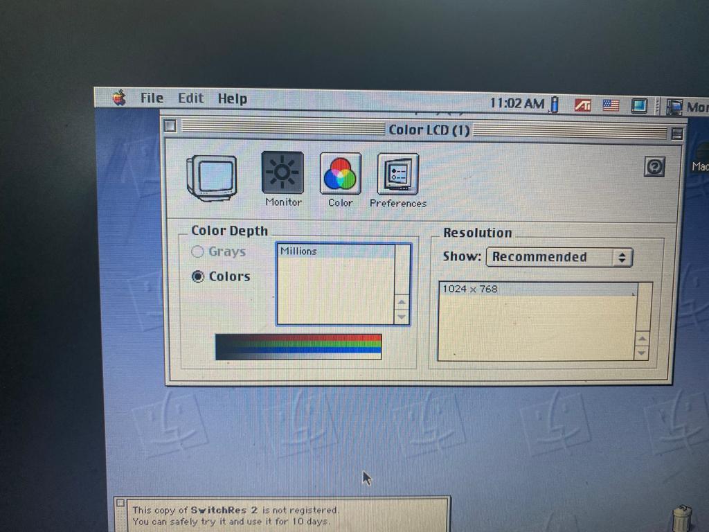

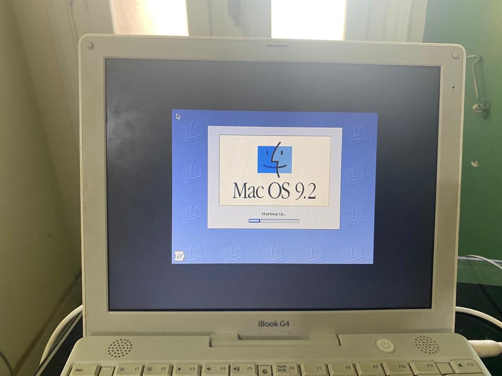

and it works except wifi of course and another thing that is annoying me and it is the resolution it is fixed to 640x480
it is showing that it is 1024X768 but it is actually 640x480 and wont change i tried several ATI 9200 drivers with nothing
so this is my spec https://everymac.com/systems/apple/ibook/specs/ibook_g4_1.0_12.html
i hope anyone could help me to fix resolution
PLS/ every thing working great except 2 things as i mentioned but trying to reset NVRAM Spoils everything and does not make Mac boot
i forgot to mention that i use SwitchRES 2 with nothing
You need the 'NDRV' and other drivers I hacked for the R9200M.
Sadly, no one has made any drivers for the AirPort Extreme card for OS 9, requires knowledge , not hacks, would have to build the wifi stack for 802.11g from the Linux or other open source drivers.
Wouldn't be too hard if we where talking OS X, but not a whole lot of skilled programers doing anything with OS 9 for the last 20 years, so don't hold your breath.
thanks alot it works , and ethernet works also not wifi but at least one of them works
