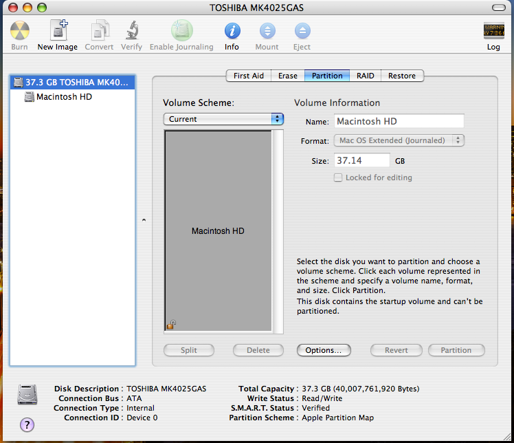

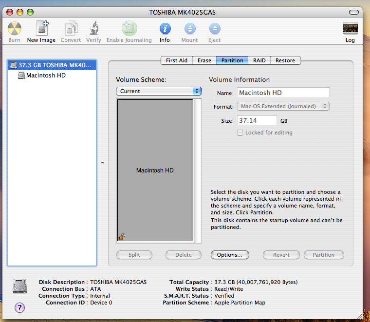

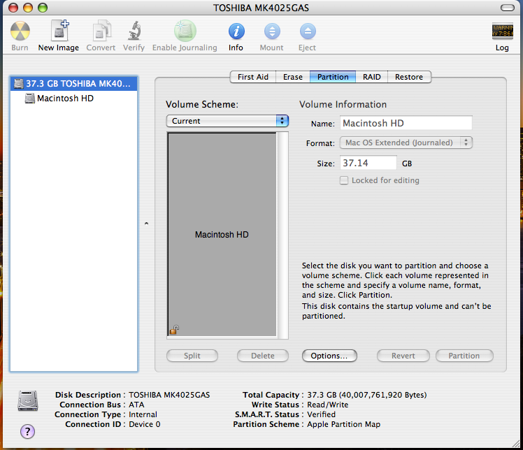

Well, I went to disk utility and clicked on the partition tab of the 40GB drive like you said, but I saw no box for OS 9 drivers installed. Also, I am on a G4, and OS 9 cannot be installed, it is impossible. So would their really be OS 9 drivers anyway?
It may not show the OS 9 Drivers checkbox if the machine it's running on cannot natively boot it. But it will still show it if they are installed. In your case, they do not appear to be installed.

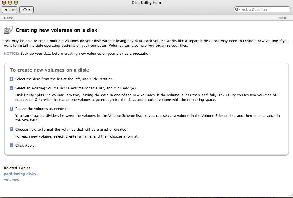

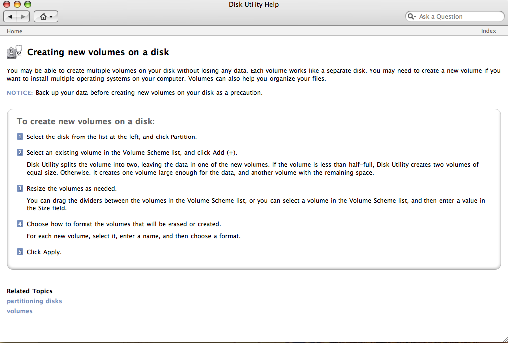

You're reading the help files from 10.4.11, which does support nondestructive partitioning. I don't think 10.4.2 does. It was a feature added on with the creation of Boot Camp.

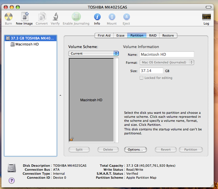

The problem is: you can't do it straight from disk utility. I think you have to boot up from the disks if you want to partition. see:
