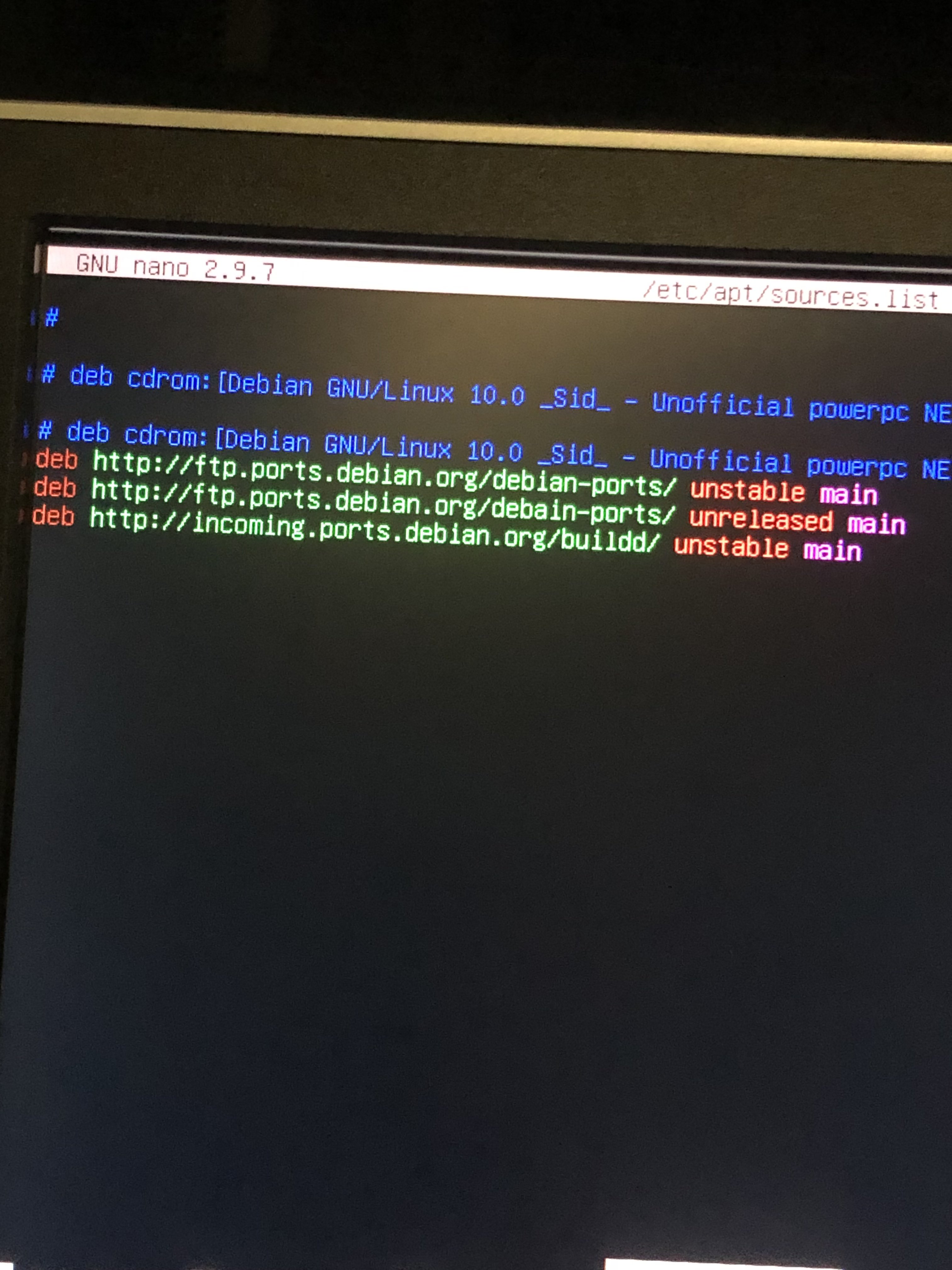

Ok I’ll try your suggestion now what about the Mac mini that built I can’t update the repos as I’m getting no pub key errors and more
Post you apt sources.list

I see the typo and fixed it but same error
[doublepost=1567636399][/doublepost]
Looks good there, it may have something to do with the installer image you are using.

You need to go ahead and edit you apt sources so you can install yaboot, it's not installed.
The config you posted before should work.
