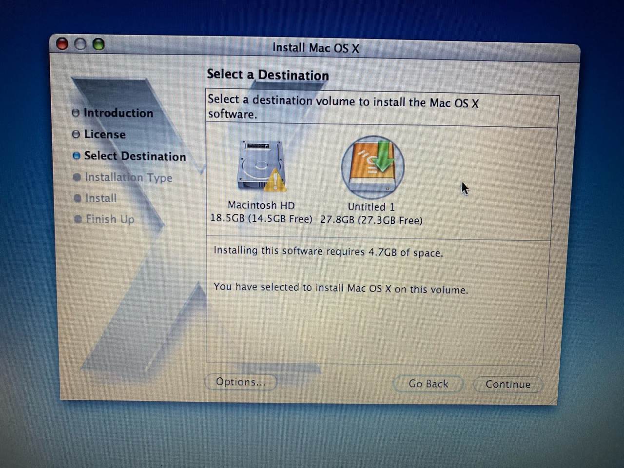

Maybe I’m misunderstanding, but can’t you just run the installer from another machine, using target disk mode?
I did this recently for an iBook which had a flaky CD drive.
Reactions: AphoticD
That's actually a very good point. I'll give that a go with the 10.4.6 image!

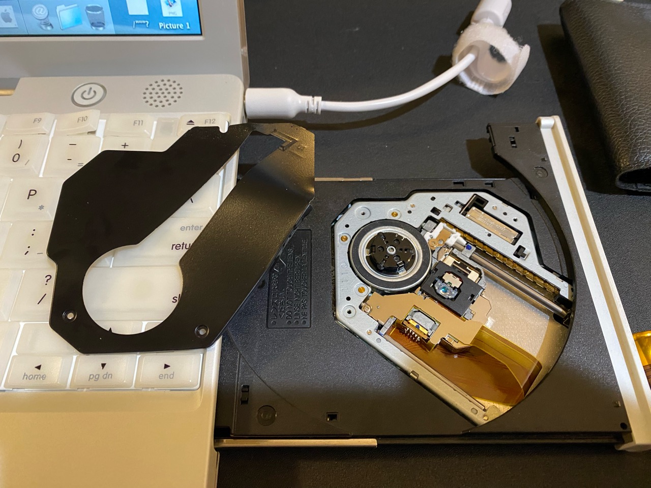

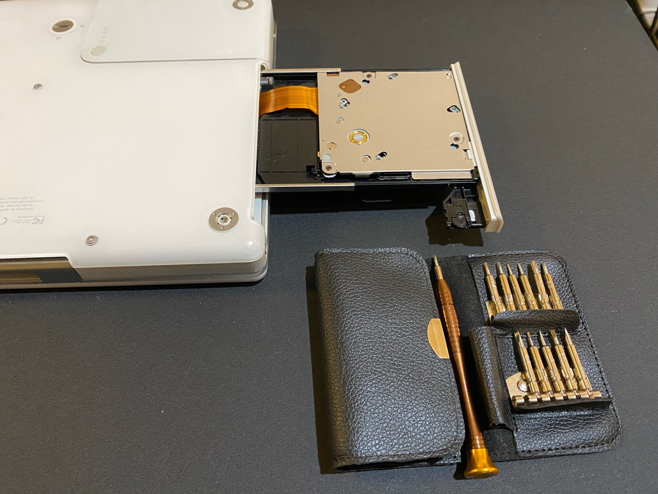

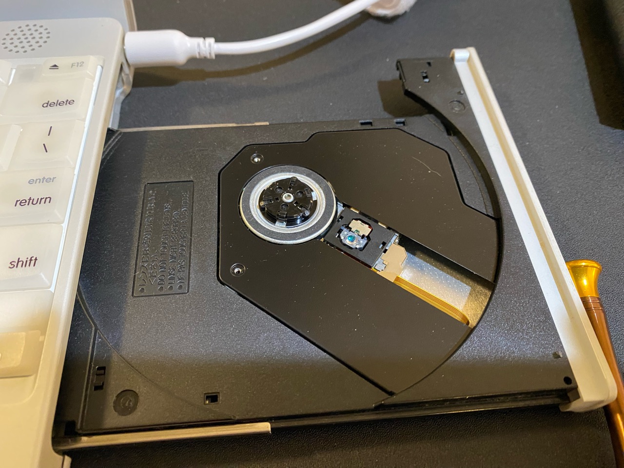

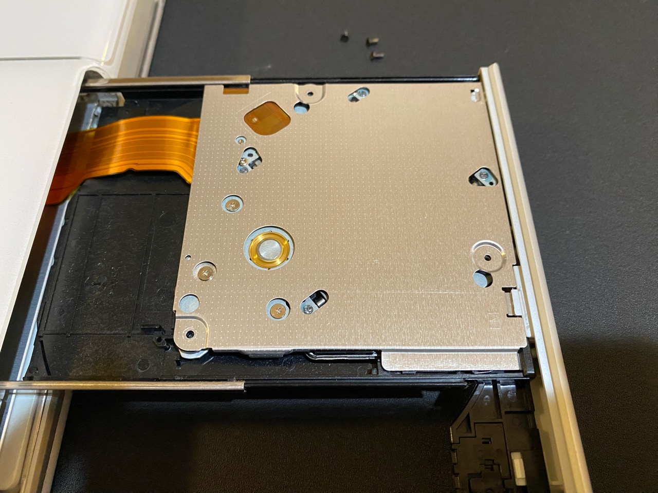

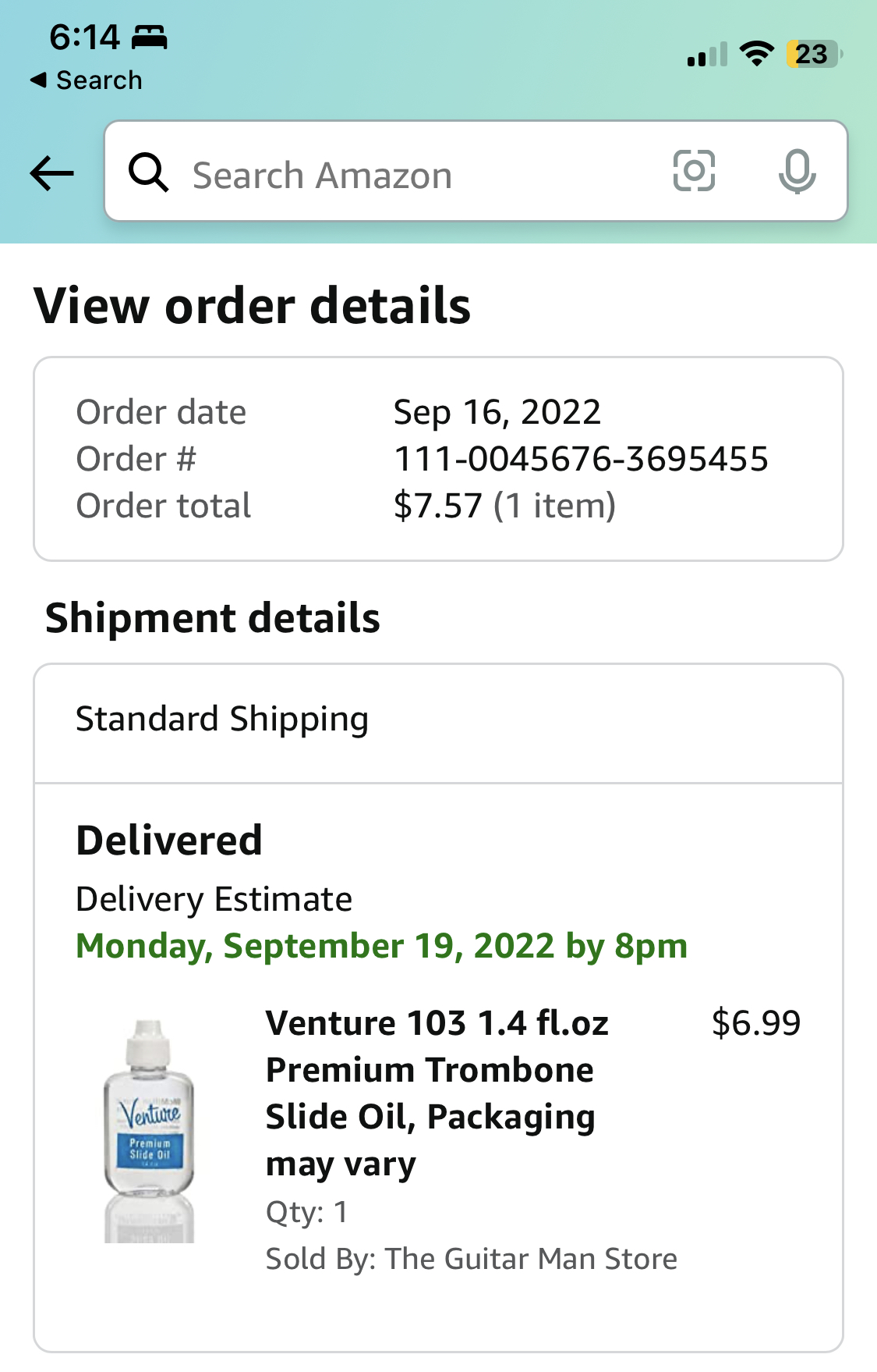

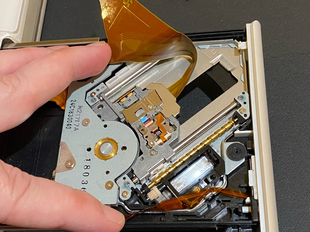

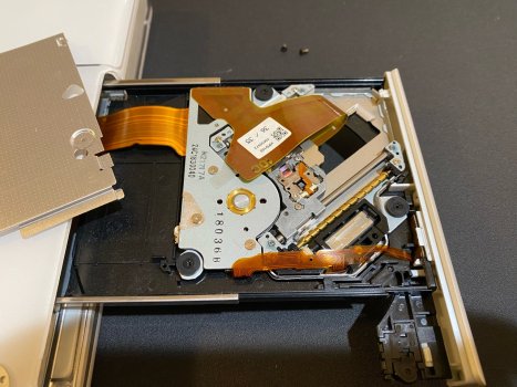

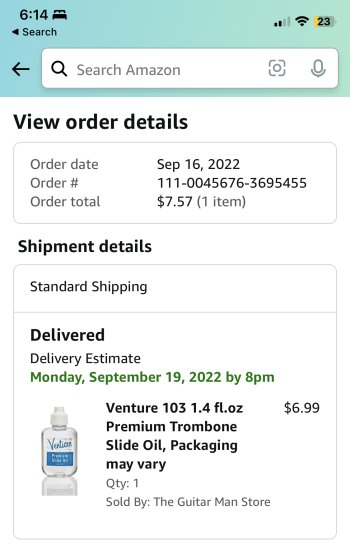

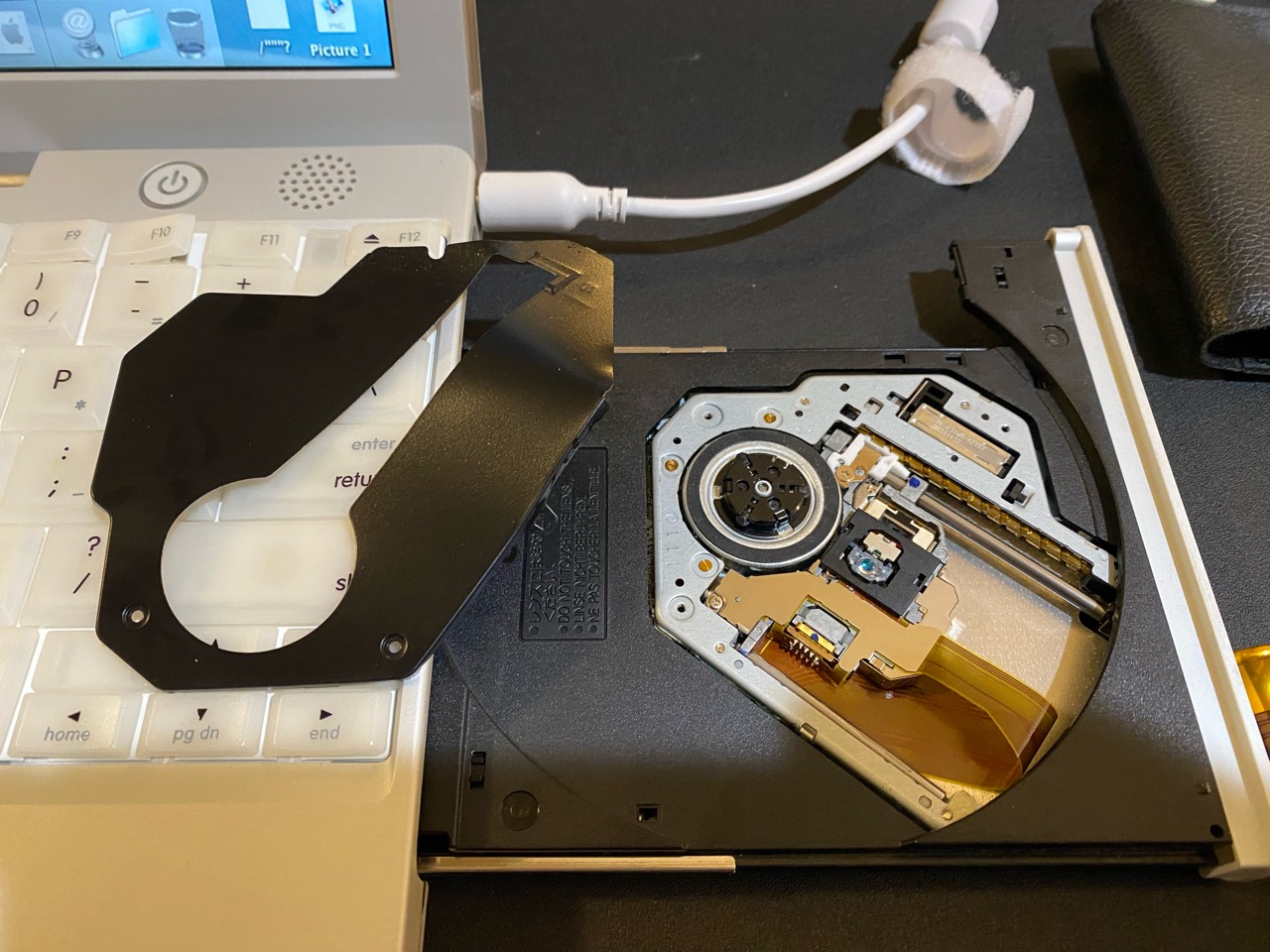

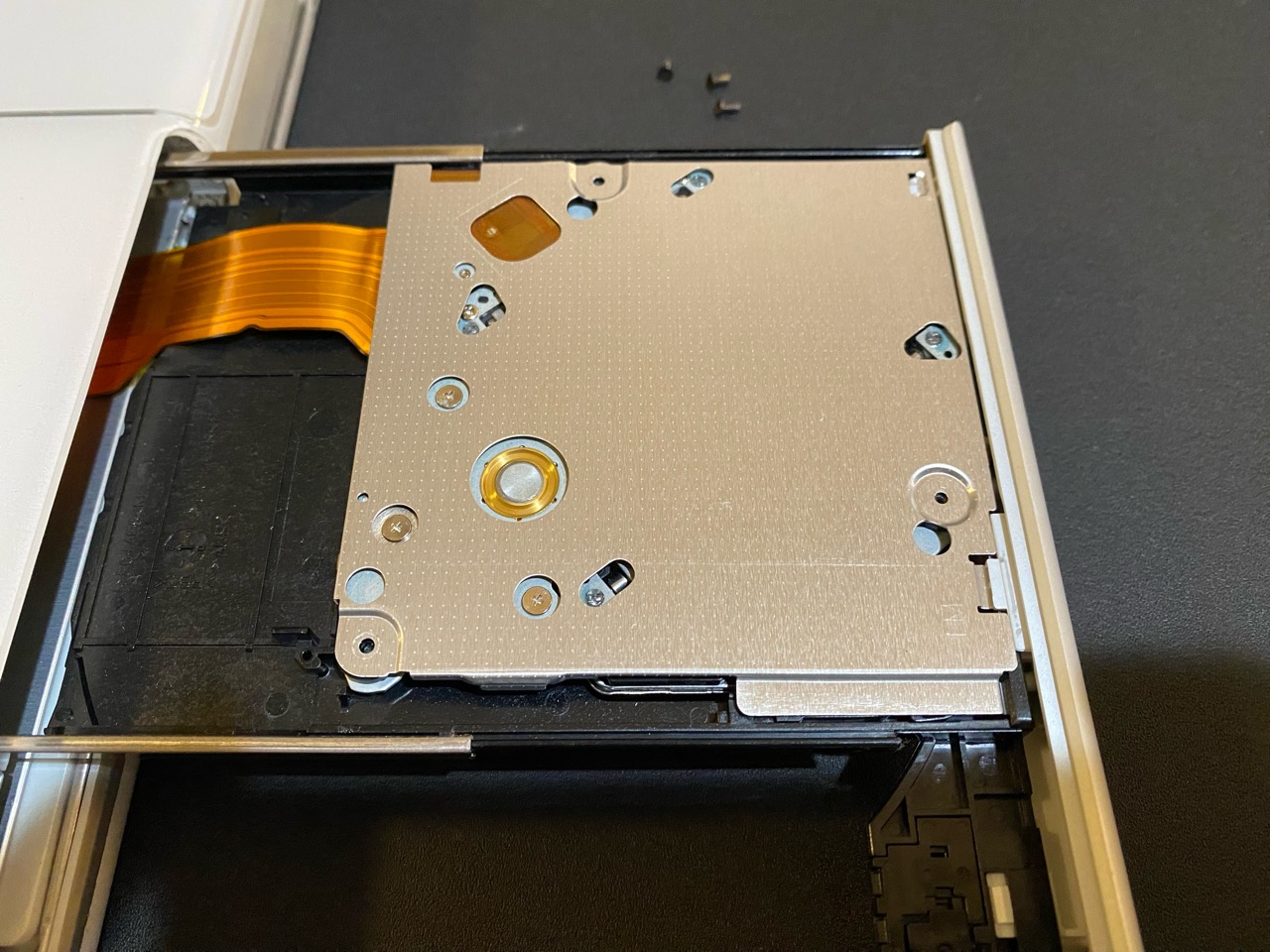

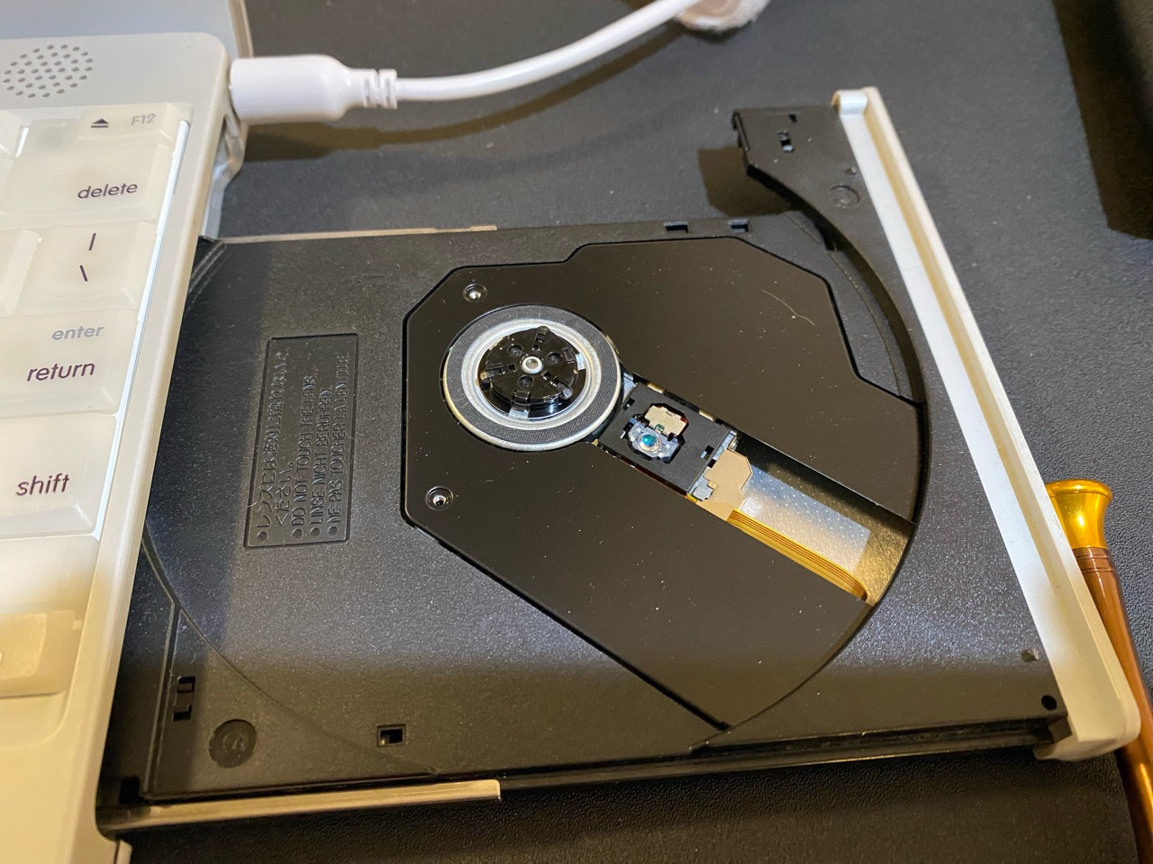

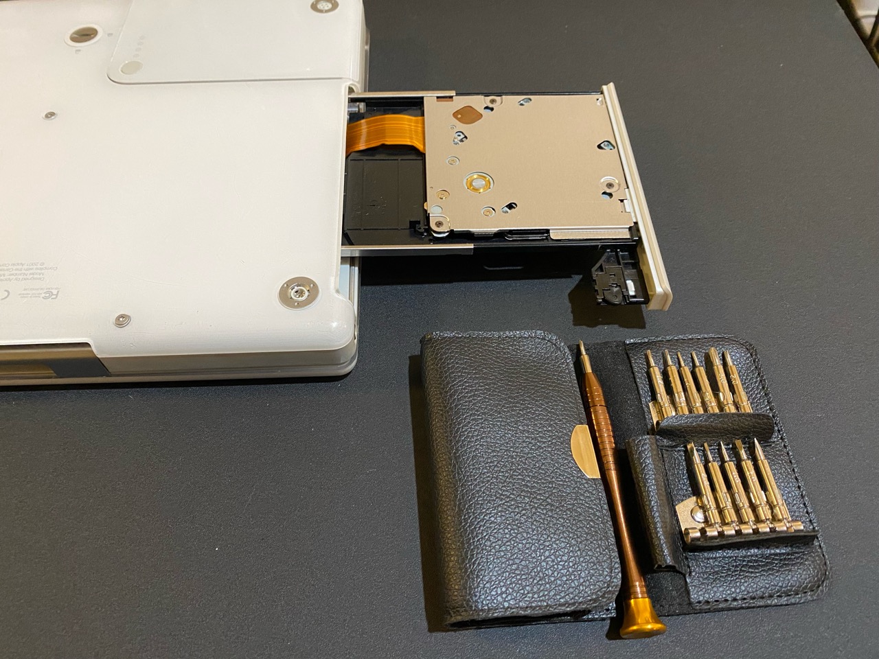

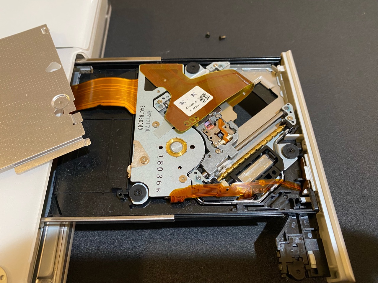

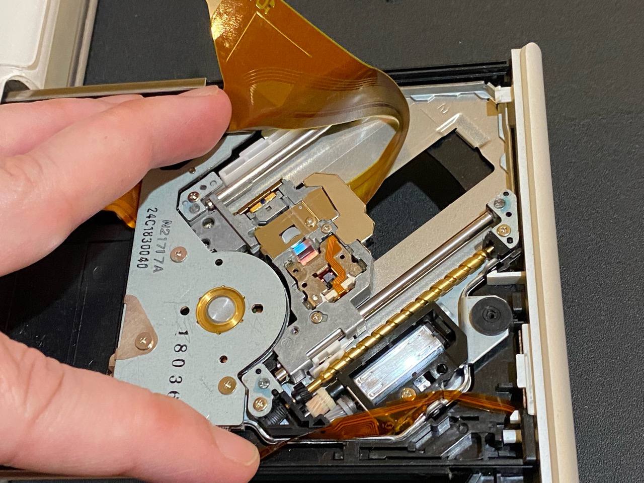

I should also mention that you can sometimes rehabilitate these old optical drives by cleaning and lubricating anything that looks like a linear rail or a gear.

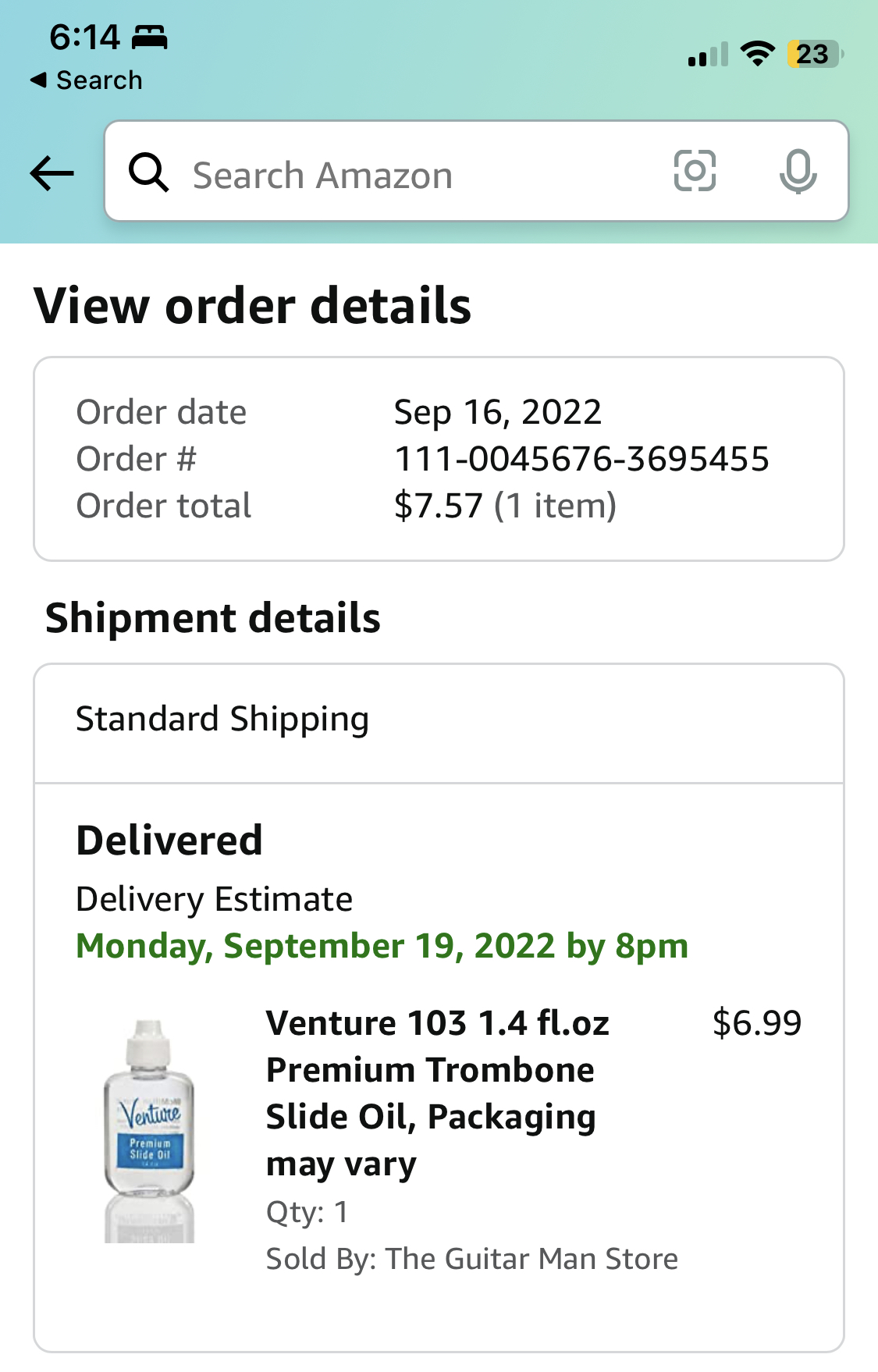

I use alcohol and a q-tip to clean, then use a few drops of “slide oil” (extremely low viscosity oil used for French horns, trumpets, trombones etc) to lubricate. This stuff is handy, buy a bottle from Amazon.
A tip: during reassembly, there was a small metal tab on the shield which was getting in the way and preventing the drive from closing all the way. It turns out it is easy to trim this shield with a pair of common household scissors.

On this particular drive, I also had to access the top side, which ended up being a permanent modification, because I bent the metal shield while removing it. Oh well.

Anyways, I was able to reinstall Tiger with the help of the TiBook. Installed to the iBook's hard drive over Firewire, then booted the TiBook from the drive to update Tiger. As the iBook came with 10.4.2, and the install media was Tiger 10.4 I wasn't sure if it was going to work.
After updating to 10.4.11 and installing other updates, I rebooted the iBook and lo and behold - Tiger loaded just as expected 🙂 Currently in the process of reinstalling the bundled software from the disk image of Installation Disk 2.
Thank you to everyone, and especially cellularmitosis for reminding me of this installation route.
