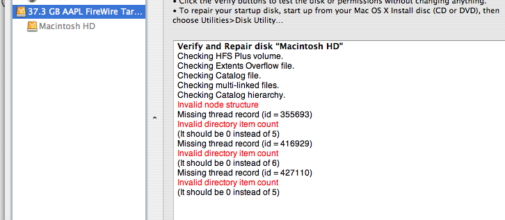

Between mowing the lawn - and having to buy a new lawn mower (and getting a new weed eater as well 😀 ) I ran the archive and install. The iBook wouldn't boot. So I restarted in fire wire mode again, ran "Repair Disk" and started getting errors. Here's a screen shot:
Is it logic board, or hard drive?

Prob is logic board then. If it were me, I would just get my files off in transer mode, and then try a clean install one more time.
