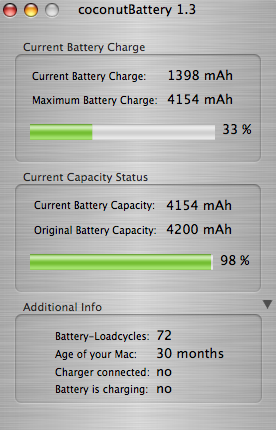

Get a program called coconutBattery. It will give you some info on your battery. You can get the Current battery capacity and the original battery capacity. Honestly, I don't think this is your problem, but it can't hurt to check.

The battery is at 98% still as far as what it can hold. Maybe its time to let Apple service it under AppleCare. I just really hate dealing with my local apple store, 9 out of 10 times they think they know more than what they really do.

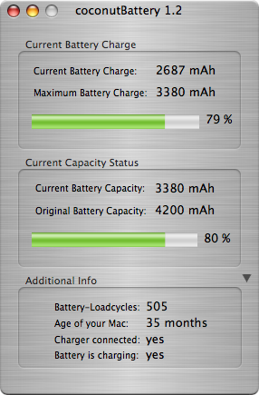

Hey guys...what's the loadscycle😕 thing?
I got cocnut running on my 3 years old PB and it shows over 500 hundre cycles????????? Is that bad or normal???? In Ed H's coconut report it show only 72! And my battery has 80% left off the original...Does that sound pretty normal to you...
Thanks for yor help🙂
PS
If that is wrong ( like I'm starting to believe...) any advice on how to improve it?

your coconut readings are fine, don't worry. the top meter is just your charge while the bottom is the overall life charge of your battery. it can hold 80% of what it was made to. This is normal, batteries die slowly.
A cycle means using 100% of the battery's capacity once, essentially. How much do you use your battery? There isn't any "bad or normal" for this statistic. If you've had the computer for three years, and you've used the battery for an equivalent of about once every two days or so, then yes, this number sounds about right. And these batteries are typically good for 300-350 charges. So if you're at 80% of original capacity after 500 charges, you're exceptionally fortunate.
