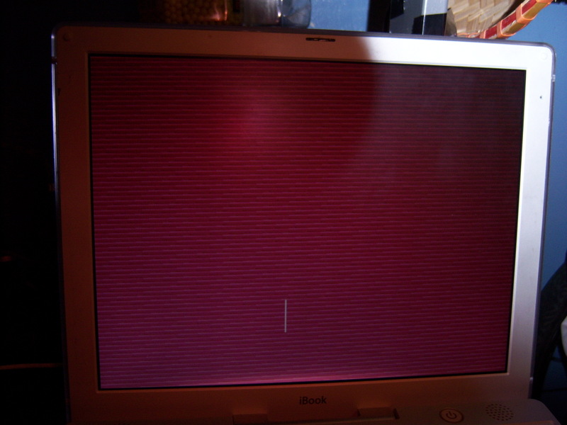

H Hsean macrumors newbie Original poster Nov 19, 2008 #1 So I turn my Ibook on sometimes it runs but the screen stays off but other times it starts fine but this happens after abit, can anyone tell me why? heres a picture. Attachments 100_0350.jpg 127.2 KB · Views: 147

shady825 macrumors 68000 Nov 20, 2008 #3 Hsean said: Also, if I tap it, it also does it. Click to expand... if your tapping it and it happens then its obviously some sort of loose connection

California macrumors 68040 Nov 20, 2008 #4 back video on logic board. You need to solder the chip. Happens because the ibook's logic board "flexes" after carrying around after time.

H Hsean macrumors newbie Original poster Nov 20, 2008 #5 Thanks for the help, how far is that inskide this thing? and where abouts is it located
California macrumors 68040 Nov 20, 2008 #6 Go to xlr8yourmac.com and check around for the ibook video chip problem.

H Hsean macrumors newbie Original poster Nov 20, 2008 #8 I got it out, I think I located the thing, it has yellow on it, I saw a heat gun would fix this and what not, I have to take this yellow stuff off'
