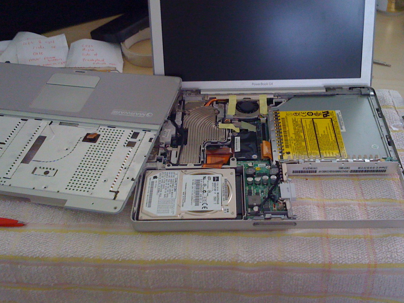

I would definitely keep it. Max out the RAM and put a faster and larger hard drive into it. I have a Powerbook G4 and the hard drive went so I replaced it using instructions from http://www.ifixit.com/Guide/Mac/. It is a little tricky, mainly because of all of the different screws, but the guides are really detailed and work. Remember to take your time 🙂

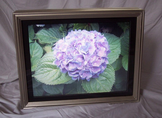

Rip the guts out along with the display. Mount it in a sweet enclosure and make a digital photo frame.
Here's one I made....
Also, I have connections on the back for Ethernet, USB and headphones. So I can access it on my network or load more photos via Ethernet or thumb drive. I can also plug in speakers and use it as an iTunes Jukebox. It's great.
Yeah I did the same thing with my 600mhz G3. Until it got knocked over and f'ed up the motherboard 🙁. Had wireless and speakers attached so I could control it Chicken of the VNC and upload more photos/music. Great mod to do!
