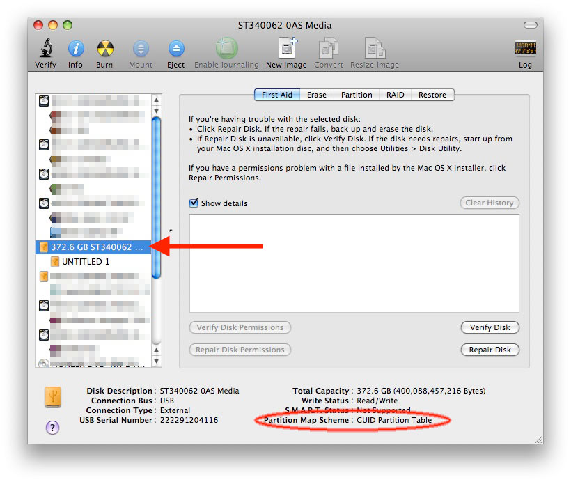

Did you by chance format the drive before backing up to it and forget to give it the right Partion Table Map? To boot from the drive successfully on your type of Mac, it needs to be formatted using an Apple Partition Map (APM) partition scheme.
If you did not change it as part of the formatting, it is probably set to either "GUID" (for Intel Macs) or even "MBR" for PCs. You iBook (being PowerPC processor based) will NOT boot from either of those 2 partition schemes. Oh, and because it is not viewed as a valid bootable disk, it will not show up in the "Option" key startup listing either.
If you can see the disk in Disk Utility, click the whole drive once in the left column (not the named partition- the line that list the whole drive) and look at the info at the bottom of the page-- it will tell you what Partition Map Scheme is established on the drive. See below, but note that where my example says GUID, yours will need to say Apple Partition Map to work as a boot drive. If the partition map is the problem, the drive must be erased to re-establish the correct type- just ask if you need a little guide to changing it.

Right, according to Disk Utility, it is an "Apple_HFS" partition scheme. Should it be something else?
