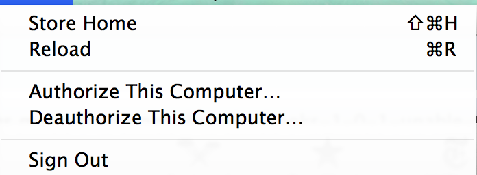

when i enter credentials, it tells me apple account creation is unavailable on this device
however, the create account page works fine, just unable to sign in

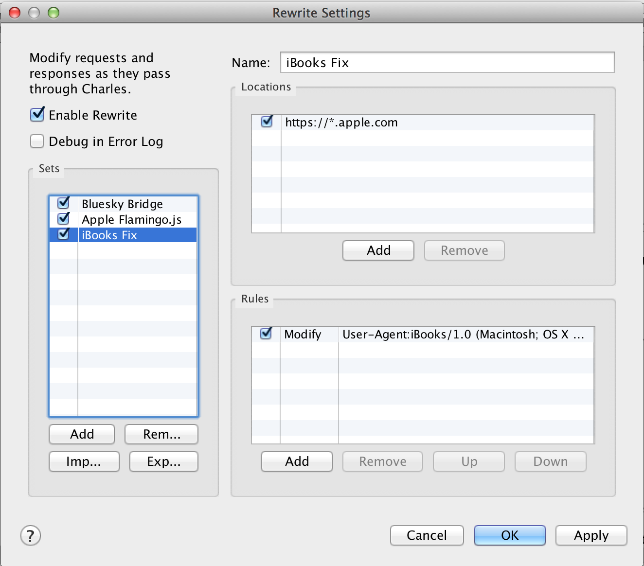

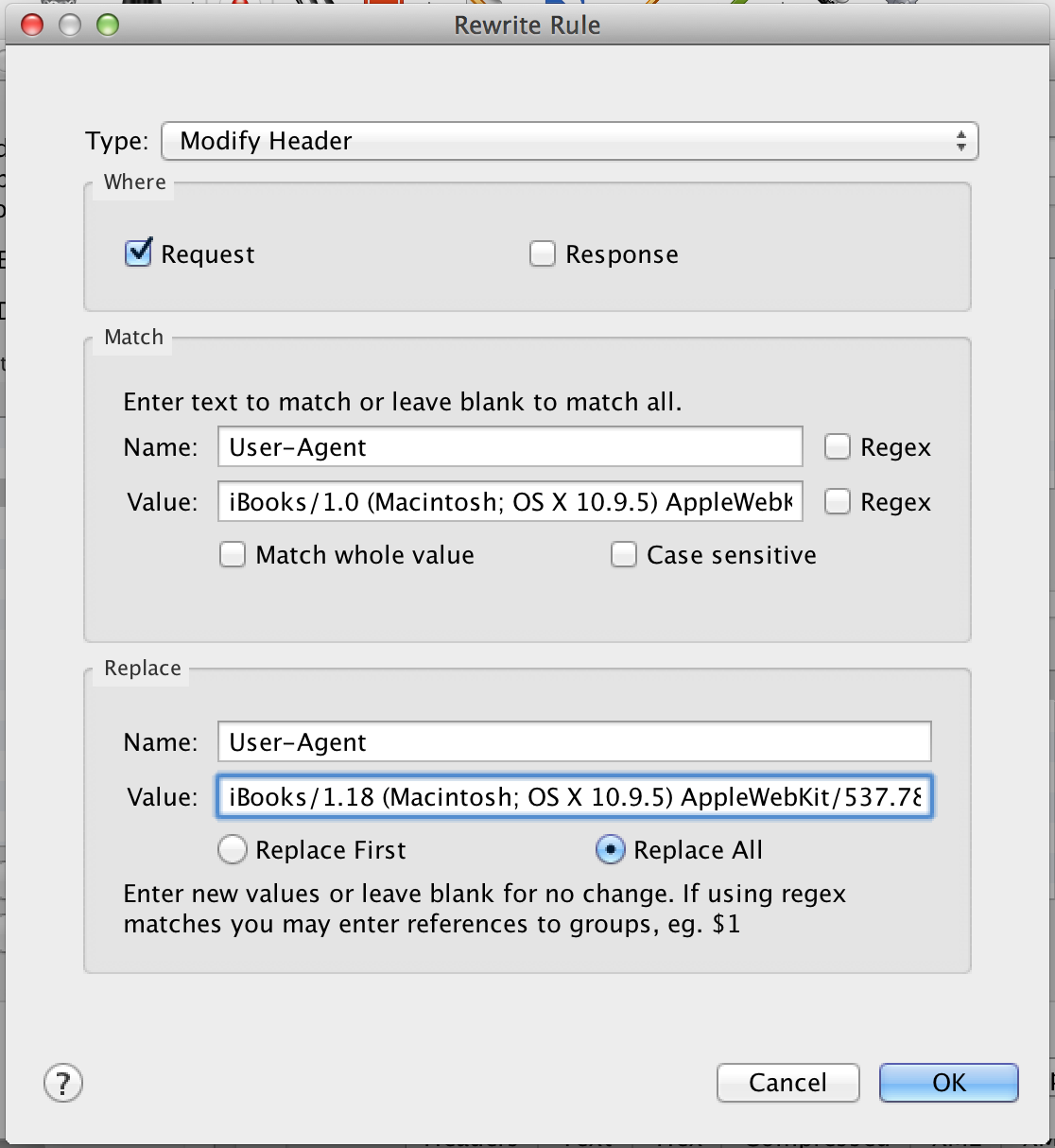

after 6 months, i finally found the solution: use charles proxy to rewrite the User-Agent request header from ibooks 1.0 to ibooks 1.18 (you dont have to change the mac os x version)
in the response headers you can see an error message talking about needing a newer other client for account creation, so i looked up the version number for a version of ibooks from os x 10.14, and that was it

if using charles, i forgot to mention you need to enable ssl proxying with *.itunes.apple.com.

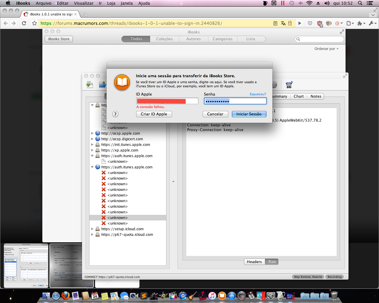

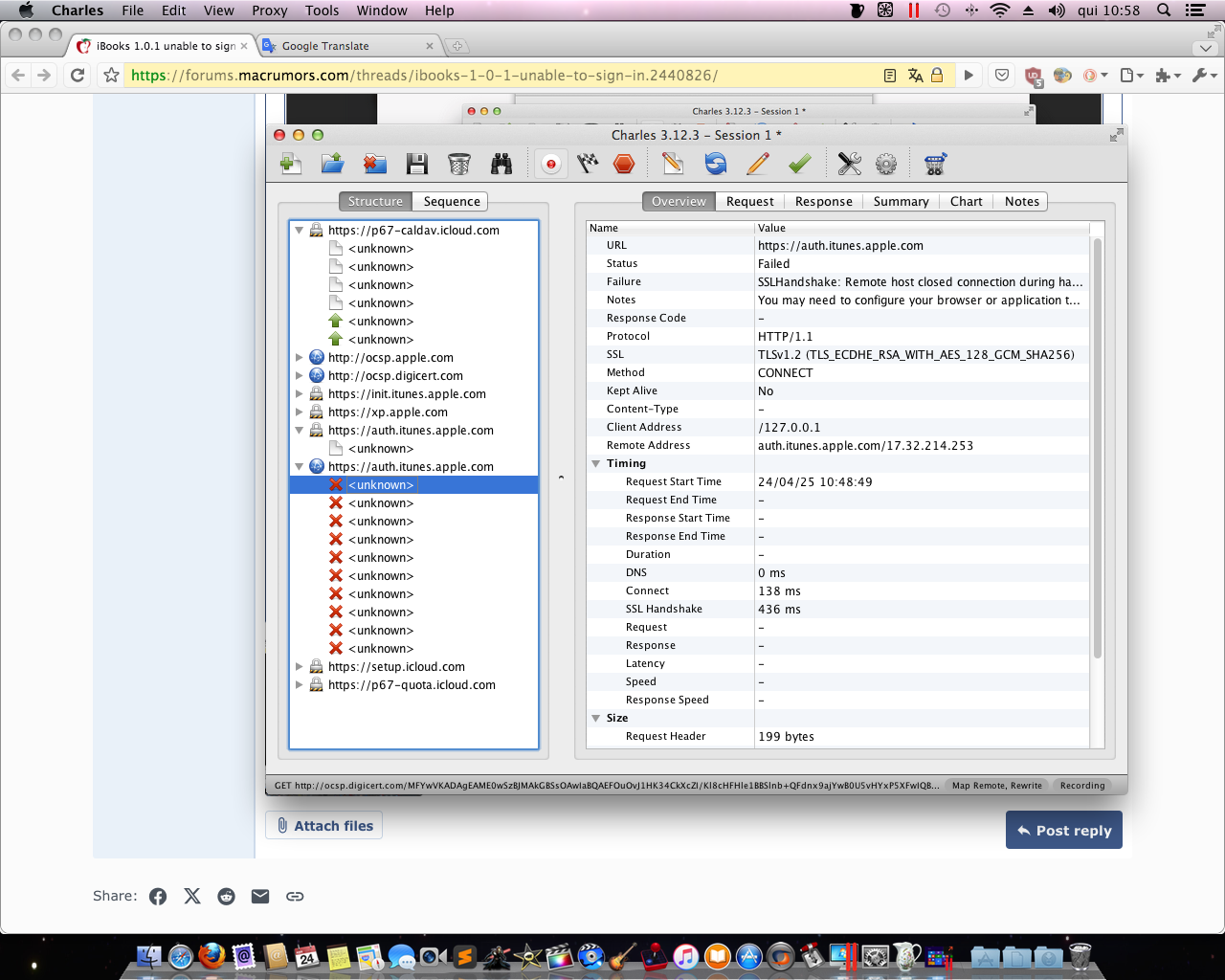

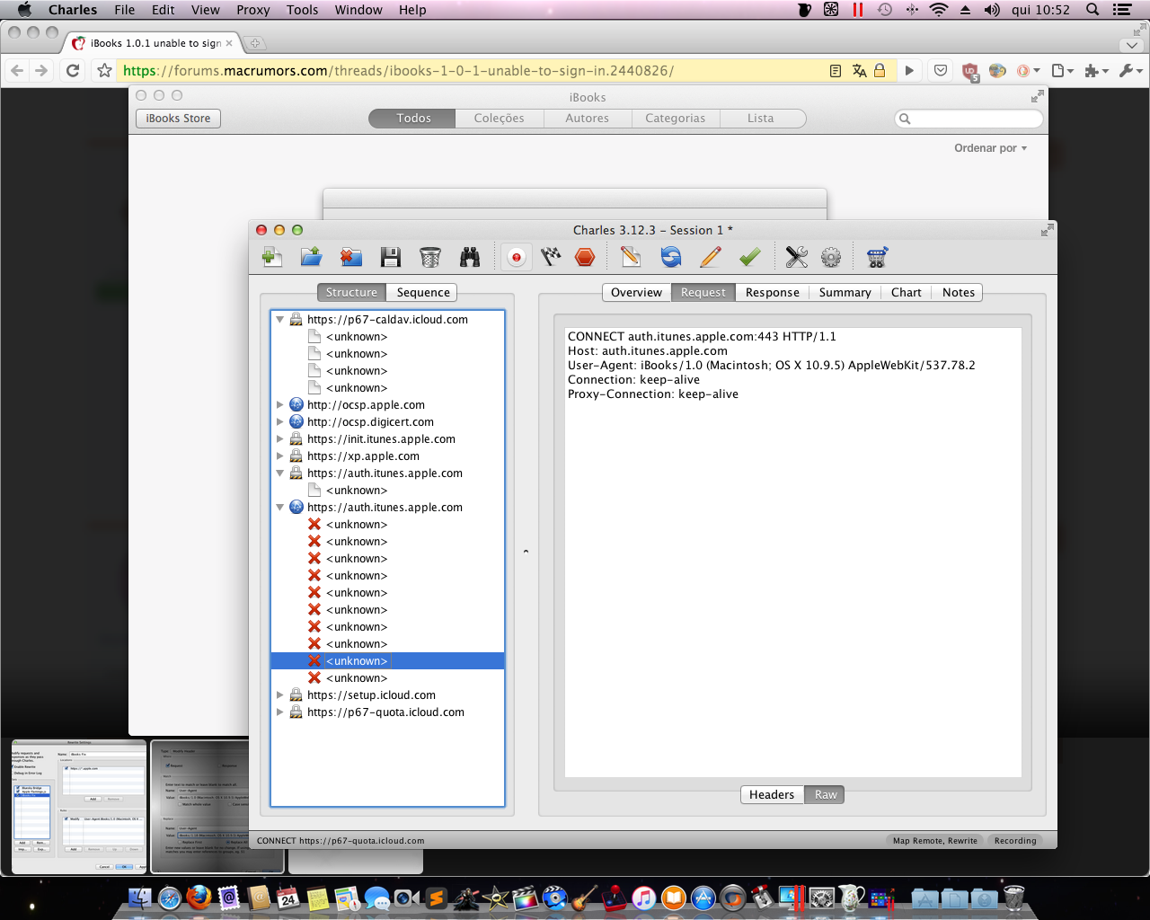

So after activating the ssl proxy, I'm getting a different error as per the print... am I missing something?
did you set up the rewrite rule to modify the user agent header? from what i can see in the images, you are still sending the xml request using the ibooks 1.0 user agent. also, it seems that you dont have the charles certificate installed, so please do that first in order for anything to work. i translated your error message and it says "connection failed" which likely suggests you dont have the certificate.
