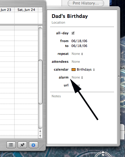

The special setting for birthdays under iCal offers no alarm option when you go into details for the full-day event.
It doesn't?
attachment.php
nope... the ones that pull in directly to iCal via Address Book don't have Alarms associated with them for some bizarre reason.

Ah - I never used the Address Book link...always just put them in to repeat every year as an all day event. 🙂
