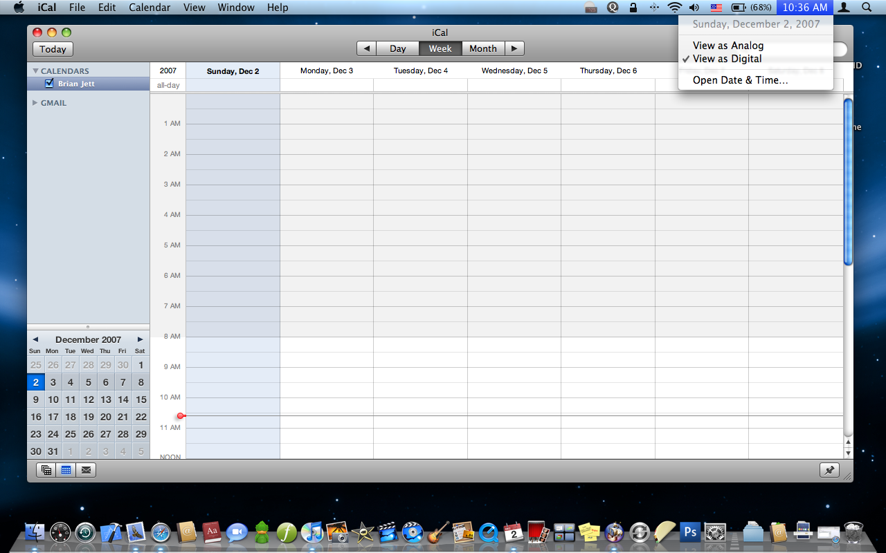

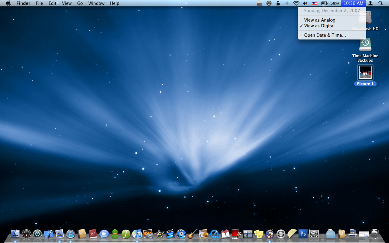

I just noticed this today, the second of december, that iCal is displaying DEC 1 on the dock when iCal is closed, but when i open iCal it changes to DEC 2.
I have no idea how to fix this. Any help would be appreciated.
Screenshot with iCal closed and one with it open:
