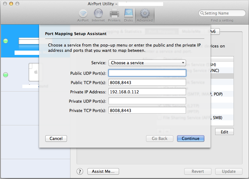

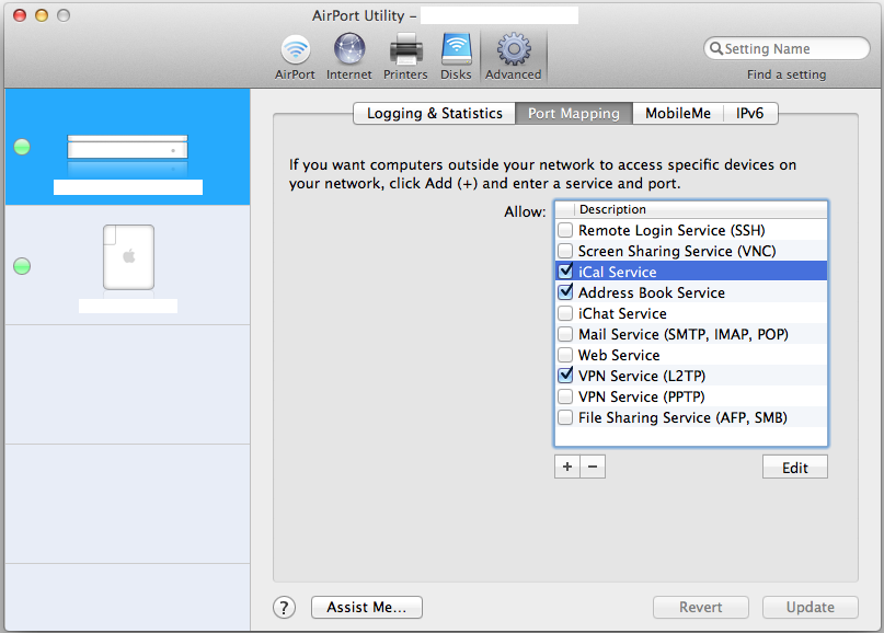

I've turned on the iCal and VPN services on on the server and, as I said, everything works properly when connected to the home network. I've tried to set the port mapping correctly (see attached screenshots below). The internal IP address shown is the intranet IP address for the server.

You can see from the images above that I THINK I have the ports opened properly on the airport extreme.

The iPhones were a different story. I was able to switch the SSL slider, and the port changed from 80 to 443. No connection. However, looking at my airport utility, it clearly stated that the iCal ports were 8008 and 8443. I manually changed the port to 8443, and now it all seems to work via 3G as well as home wireless network. The real test will be to see if it still works tomorrow, I guess.
