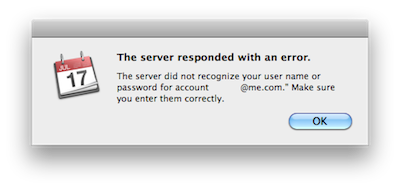

I'm having the exact same problem. This happened couple weeks ago, but I haven't made any new additions to my calendars so not had to worry much about it. However, I just rebuilt my Mac, and I'm now unable to get any of my calendars synced from MobileMe to my Mac's iCal.
I get the error shown in the attachment. Everything else MobileMe wise works fine.

I managed to sort mine too: for some reason, iCal wasn't setup properly for my MobileMe account when it was all setup in the MobileMe preference in System Preferences. Basically, in iCal's preferences, under Accounts, my MobileMe password was empty. Strange, seeing as I thought it would have been all done automatically.
