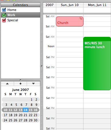

In iCal none of my times display correctly for the day. it either says Noon, midnight, Sat AM, Sat PM instead of numbers for the correct time.
I did use monolingual to remove some langauge stuff, but thats all I did that I can recall that would of modified these settings. I am willing to reinstall if needed, but was wondering if there was another way.
OK, here it is, thank you for your reply.

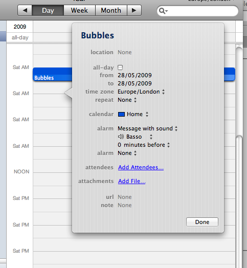

I've just hit the same problem. I have just added (for the first time ever) a couple of appointments directly from Mail.
It is not just the time of day down the side of the display that doesn't show up, I can't see or edit the time of events either (see screenshot). The time is definitely stored, because when I sync with my mobile phone (a Sony Ericsson) events that are newly transferred to the phone have the correct time. It seems that just the iCal user interface doesn't have any awareness of time any longer.
If I log in as another user, iCal handles the time correctly.
I have tried moving ~/Library/Preferences/com.apple.iCal.plist and re-starting iCal, but that didn't help
Any ideas anyone? I am running 10.5.6 on a MacBook Pro.
