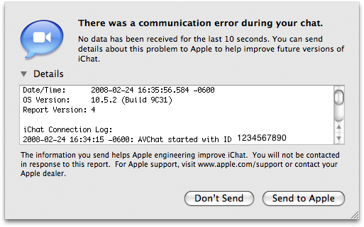

this extremely frustrating because I'm already on my second iMac and its only been 1 month. Everytime I go to video chat someone using iChat it will start up and not work after 2 seconds and give the error message below. iChat works with text and audio chat. I have a wireless connection and have a comcast router. Anyone know how to fix this?!!

My friend was having a similar problem, and we found one solution. He went to system preferences, network, assist me. Once OS X configured his network settings everything worked perfectly and still does. Try it.
Make sure you have the correct ports open for video on your router. If you are using the Leopard firewall (System Preferences->Security->Firewall) make sure it allows all incoming connections. For the ports, check this out http://docs.info.apple.com/article.html?artnum=93208
I tried to follow the instructions from your link, but there doesn't seem to be a Firewall tab in the Sharing section or a "New" button in the Security>Firewall area... I am running Leopard.
Sorry, I meant to use the Apple link to check to make sure those ports are open on your internet router, not Mac OS.
Make sure 'Internet Sharing' is OFF

I was at my wits end, before I tried turning off 'Internet Sharing', which I had used to share at Ethernet connection to other devices over AirPort while I was traveling.
Voila! With Internet Sharing off, my video chats connected every time. With Internet Sharing on, they always failed with error 8 or error 4.
So... if you have having trouble connecting to iChat video or audio chats, make sure Internet Sharing is off (System Preferences/Sharing).
This is all under OS X 10.5.7.
This did it

I had internet sharing enabled and didn't realize it now my video works perfect...apple really needs to fix this
