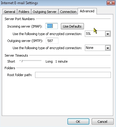

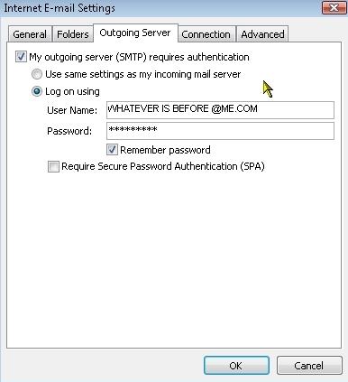

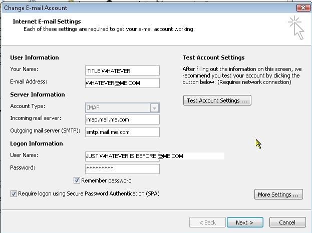

Outlook 2007 setup for me.com mail
Both posts from kwissylawrencek and cmartinez helped.
For 2007 users, see the three attached screenshots for settings
As cmartinez suggested, I HAD TO CHANGE my iCloud password... remember to login to iCloud with your APPLE ID and password to change this. Update the password in Outlook once you've done that and walla.
