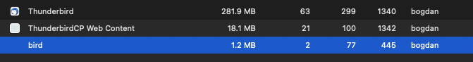

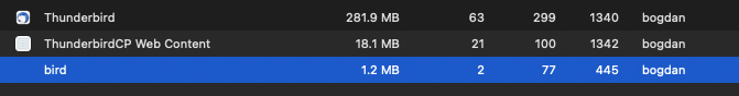

What are you talking about?!?
Open Activity Monitor and see how much memory bird is using on your system. Here is mine 1.2MB

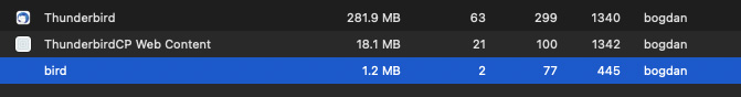

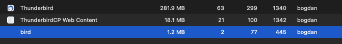

My bird memory usage is normally 4.2MB.
When I hear the Mac's fans running, I check bird. Then I notice the high memory usage. I kill the bird process and the Mac's fans go silent again...
