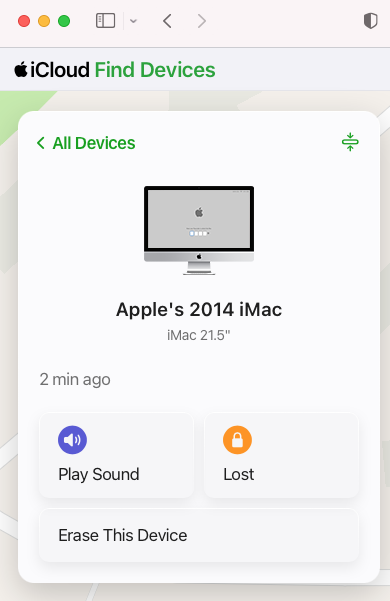

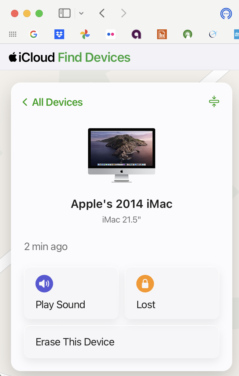

Recently revived some salvaged iMacs (pulled HDD, failed HDD, failed GPU, Incorrect macOS installation). After repair and adding them to a test icloud account, I see this pic for the computer with an icloud sign in code entry box
These computers sign into my test icloud account fine. Can locate them with Find My. Sign out and back into icloud etc.

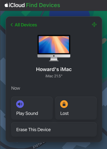

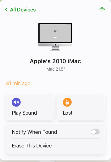

My other macs looks like this in icloud.com Find Devices
Screen Shot 2025-01-22 at 8.23.56 PM.pngScreen Shot 2025-01-22 at 8.24.10 PM.png
Anyone know why? Pinging prior owners to check if these macs with the icloud code pic are visible on their iclioud.com Find Devices.

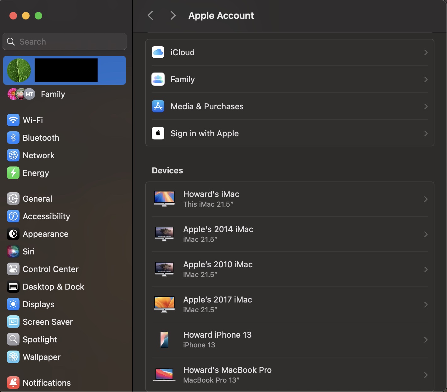

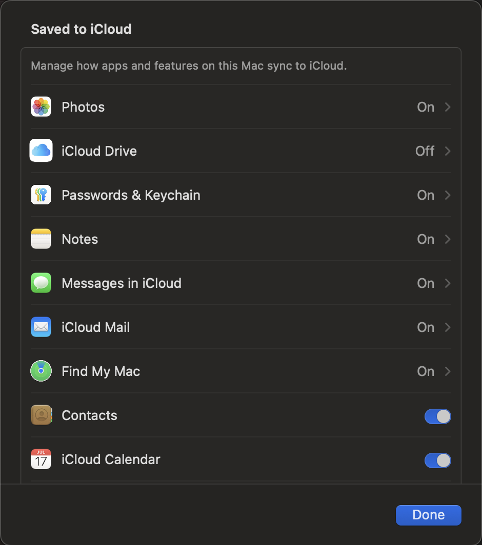

  2. all 3 macs have find my turned on (System Preferences iCloud settings) Privacy and Security location enabled for Find My to work. All 3 macs can be found on icloud.com

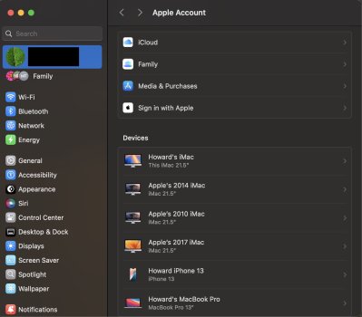

  3. 2 macs shows iCloud Find My is off in System Preference Device listing's detailed view despite #2. One of the mac has been signed into icloud for months

I've never seen that image before, but looks like it thinks the Mac is locked. (In Lost Mode?)
The image looks normal for my Mac, and the URL to the image is:
I took a guess and changed 'online' to 'locked', and sure enough, there's the image with the lock:
I don't want to put my Mac in Lost mode to find out if that's what it is, but might be something to look into. Perhaps putting them in lost mode and taking them out will fix it. How do they appear under Devices in your Apple Account (https://account.apple.com/account/manage/section/devices)?

Good hint, more info below and clarify 'online'/'locked'
OCLP
Yes, most of these macs were on OCLP. OCLP maybe confusing icloud? If server keeps tracks of model + macOS to determine particular version of icloud protocol specific to macOS versions, I suppose OCLP can potentially be confusing. I'll outline some observations below (still trying to get a more deterministic failure triggers)

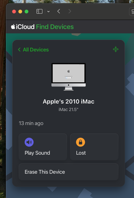

Not sure what you mean by 'online' to 'locked'. I'm only aware of Activation Lock ( link ). Activation lock is achieved by turning Find My Mac on or off (through UI #1). If turned on, mac shows up in all 5 above UIs and disappears if turned off. Maybe you are on >= M1 and UI is yet different again?

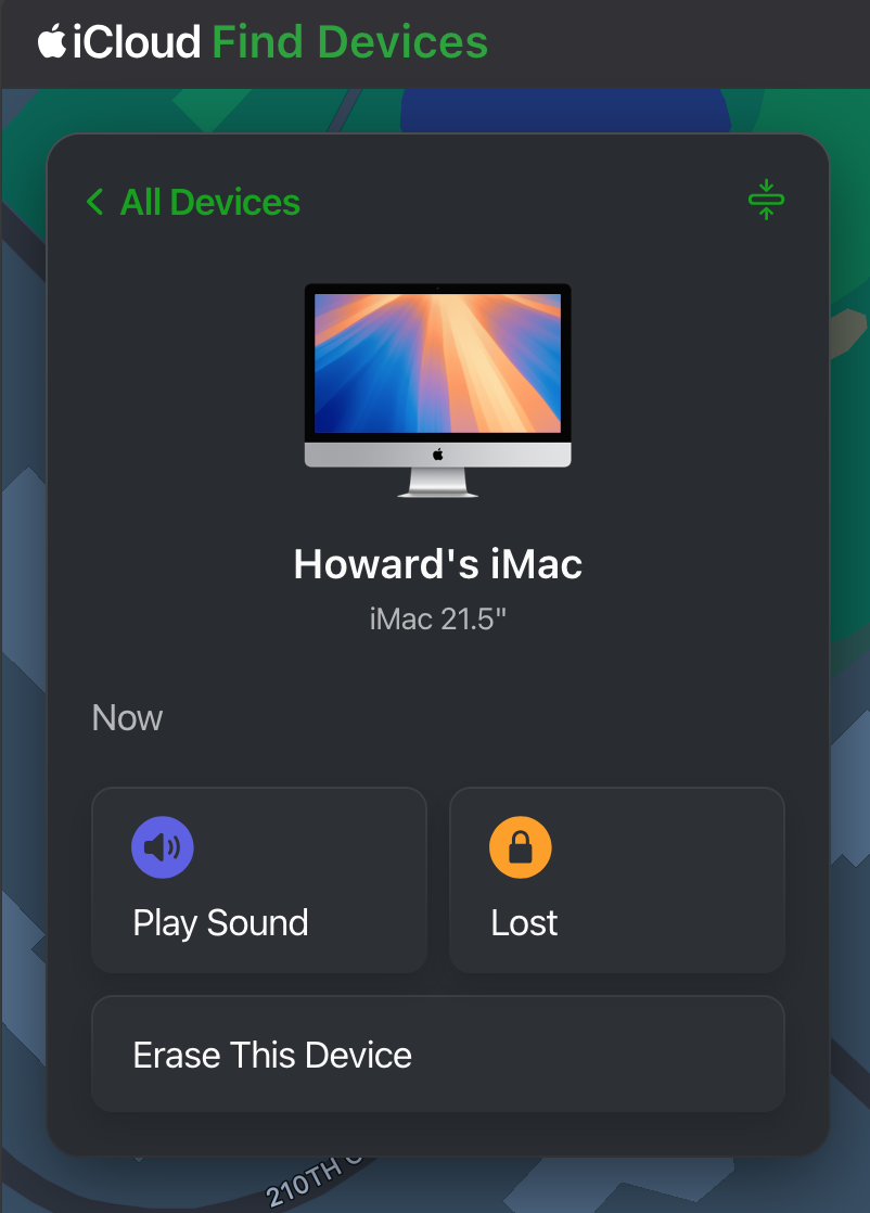

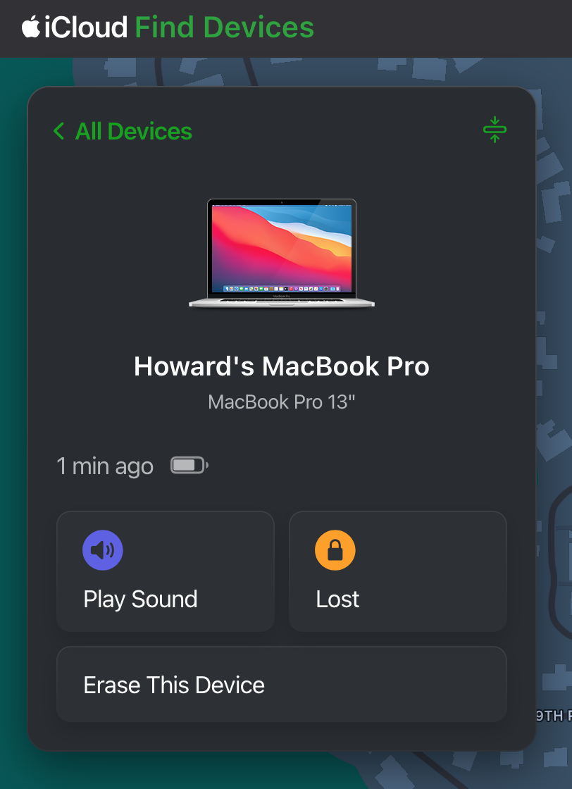

For me, to see the 'lock' icon, Find My has to be turn on. Even stranger is this locked icon only appears in UI #3 on the mac with this issue. If UI #3 is viewed by another mac without this problem (on the same icloud account of course). It shows normal. Pic on left is from Big Sur Safari icloud.com/find on the 2010 iMac running OCLP Sequoia and Pic on the right is from Big Sur Safari icloud.com/find on a MBP 11,1. I have a iMac 14,4 on Big Sur Safari that behaves the same (doing a test to wipe OCLP completely and just run network recovery installed macOS Big Sur to see if anything changes)
Screenshot 2025-01-23 at 12.27.07 PM.pngScreen Shot 2025-01-23 at 12.28.58 PM.png

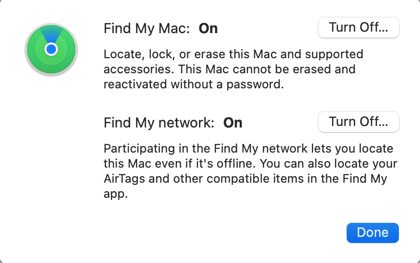

  • Mac Details ( click '>' on post Ventura UI) on UI #1 will show OCLP Macs with Find My Mac turned on as off. Since its turn on, all 5 UIs above shows Mac's location on map. But UI #1 detail shows it as off

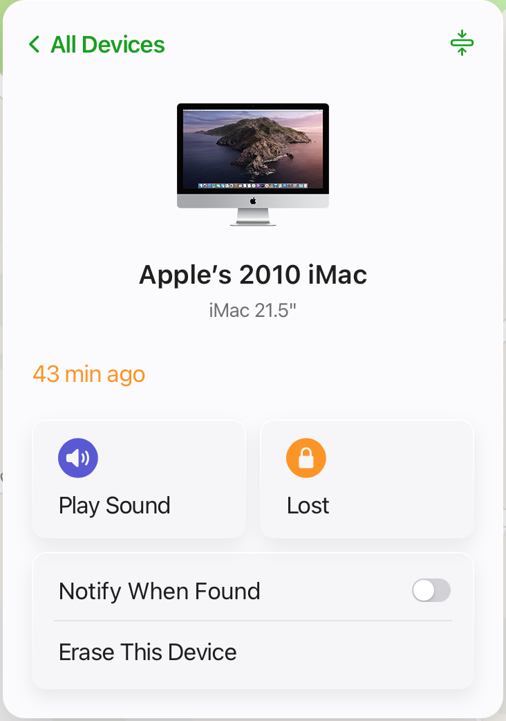

After all this, back to a locked mac icon on cloud.com/find (not under All Devices, only when clicking on the device)

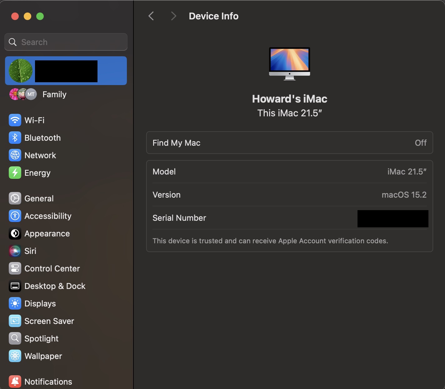

After 3 level of Apple support and 1.5 hours. They've filed a bug for the devs to look into. 2 main anomolies
1. Mac signed into Find My Mac (and fully working by checking against icloud.com/find and Find My app on multiple computers and iPhones in the account) but shows not Find My Mac as off in the System Preferences iCloud ID list
Screenshot 2025-01-23 at 8.42.23 PM.jpgScreenshot 2025-01-23 at 8.42.33 PM.jpgScreenshot 2025-01-23 at 8.42.54 PM.png
2. Why some macs are shown with lock image in icloud.com/find on some Macs while other Macs shows normal image
Screen Shot 2025-01-23 at 5.19.54 PM.pngScreenshot 2025-01-23 at 5.19.08 PM.png
