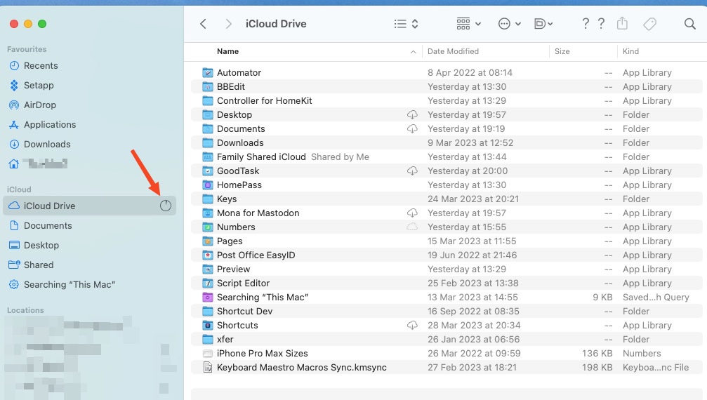

Is it usual for the iCloud sync indicator to hardly ever move? It tends to stick like this most of the time and choosing the 'download now' option on the folders with the download indicator makes no difference.
Should I be concerned?

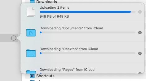

No matter what I do iCloud sync still stalls:

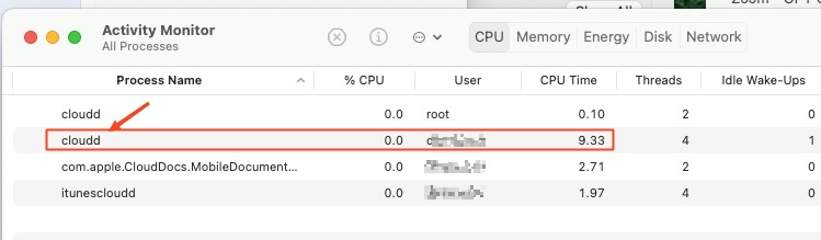

The only way to get it going again is to kill the 'cloudd' process which is running under my username.
And once again it stalls again shortly after. Does anyone have any ideas as to where I can go next?
