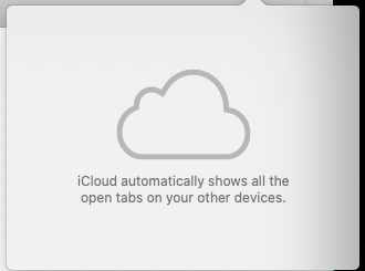

I've had this same issue for the past few months and just now attempted to fix it. What worked was 1) removing the device with the wrong tabs (M1 MacBook Pro here) from iCloud (from the MacBook) 2) When removed, go to iCloud.com and ensure it is removed from your account 3) Check iPhone iCloud list to ensure it's gone 4) Sign into iCloud again in MacBook settings. This worked for me and now my tabs are syncing correctly.
I've tried removing all devices and signing back into iCloud too... I don't get any phantom tabs. I just don't get any tabs at all! This seems to have been the case for the last few months for me.
