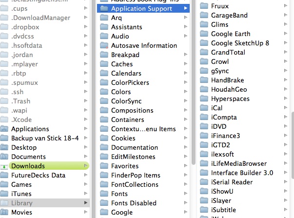

Found Library folder, but no iCloud folder?
I managed to unhide the library folder, but it contains no iCloud folder.
Tried adding one manually and then tried to log-in to iCloud again, but alas, didn't work either.
More suggestions?
More suggestions?
It should be under Application Support which you are not showing. Looks at the post that gave your the path.
Lastly, I am not having this problem I am just trying to help with the path question.
I changed the image in my post to the proper folder. As you can see it is nonexistent.
