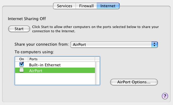

First, I am assuming that you have Internet Sharing designated as in the image below (only your button should say "Stop").
If so, I don't think it really matters what your Ethernet TCP/IP settings are - they should be overrided by the internet sharing. Your PC should be set up as DHCP, I believe, to get an address from your Mac.

It looks like that a bit...
except it says 'Sharing your Airport connection' 'You are connected to the internet over airport. This connection will be shared with computers connected to built in ethernet.' Im running 10.2.8 by the way. The PC isn't recieving any DHCP info though. It's using a crossover cable.
