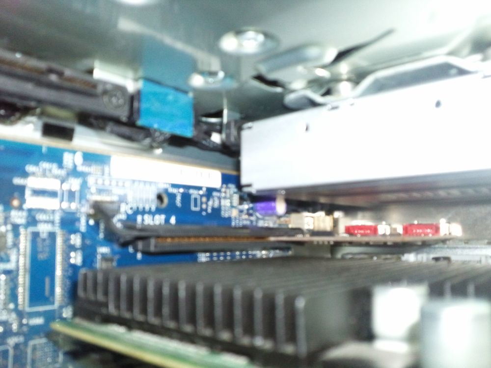

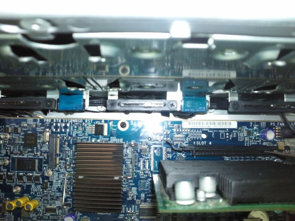

Hey Desmo1098,
We had tested our MB982IP-1S to our own Mac Pro and we found no issues with the mounting or recognizing of the unit. We think that one other cause could be with the insertion of the SSD/HDD where it may not be inserted correctly and thus lead to the issue. Also, we are motoring the returns on this product closely, and have not seen a significant amount to say that this is a issue with many Mac Pro users. Do you know which Mac Pro do you have?? We are currently looking into whether the internal structure of the Mac Pro's are different by Apples' revisions.
Hope this helps!

We have done some extensive research on the issue with the MB982IP-1S in combination with the Mac Pro. We have found that the SATA connection between the MB982IP-1S and the Mac Pro is causing the issue. This is because of two things; the female SATA connector on the Mac Pro is much shorter than any other system that we have seen, second we have found that a very small amount of the SATA connectors have some sort of residue on the actual SATA connector on the MB982IP-1S maybe making a bad connection. The supplier of the SATA connector has been notified of the issue. We have also told our production line to check the connector to address any issues. Some of our customers that have had this issue have found that cleaning the SATA connector on the MB982IP-1S with rubbing alcohol and a toothbrush have solved the problem. We recommend trying this solution to fix the problem, if problem still persists please contact us for further instructions.
