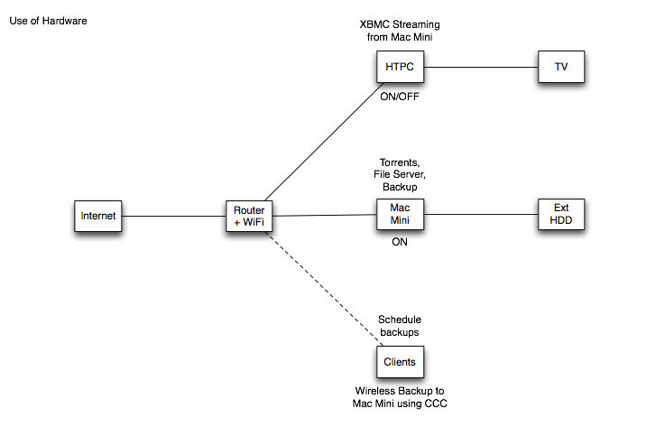

Ok a little bit more than you are doing, but gives the same idea. I was working on this last night!
I would stay away from NAS network drives.....use that old computer! 🙂. Ubuntu 11.10 is doing well for me! I agree with Gav2k though, do an initial transfer via USB.
In the picture, the Mac Mini is an old one from the last decade, so can not support HD video. It is basically my file server - nice and quiet!
