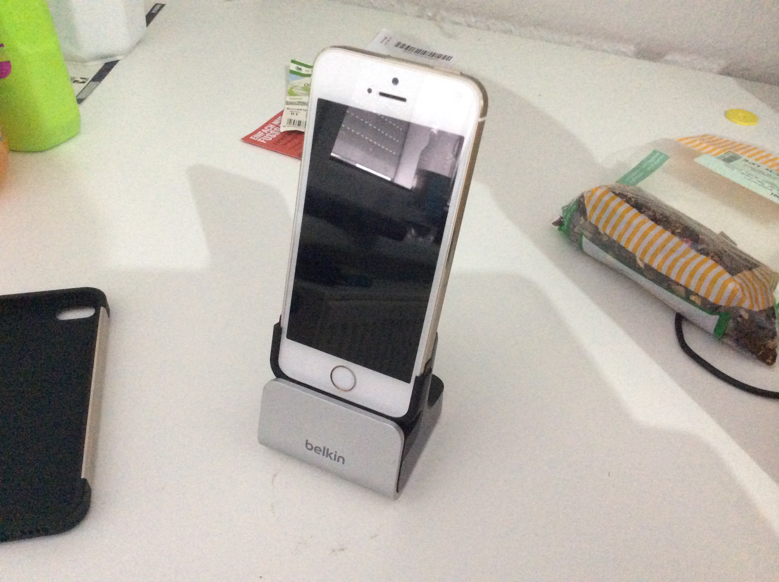

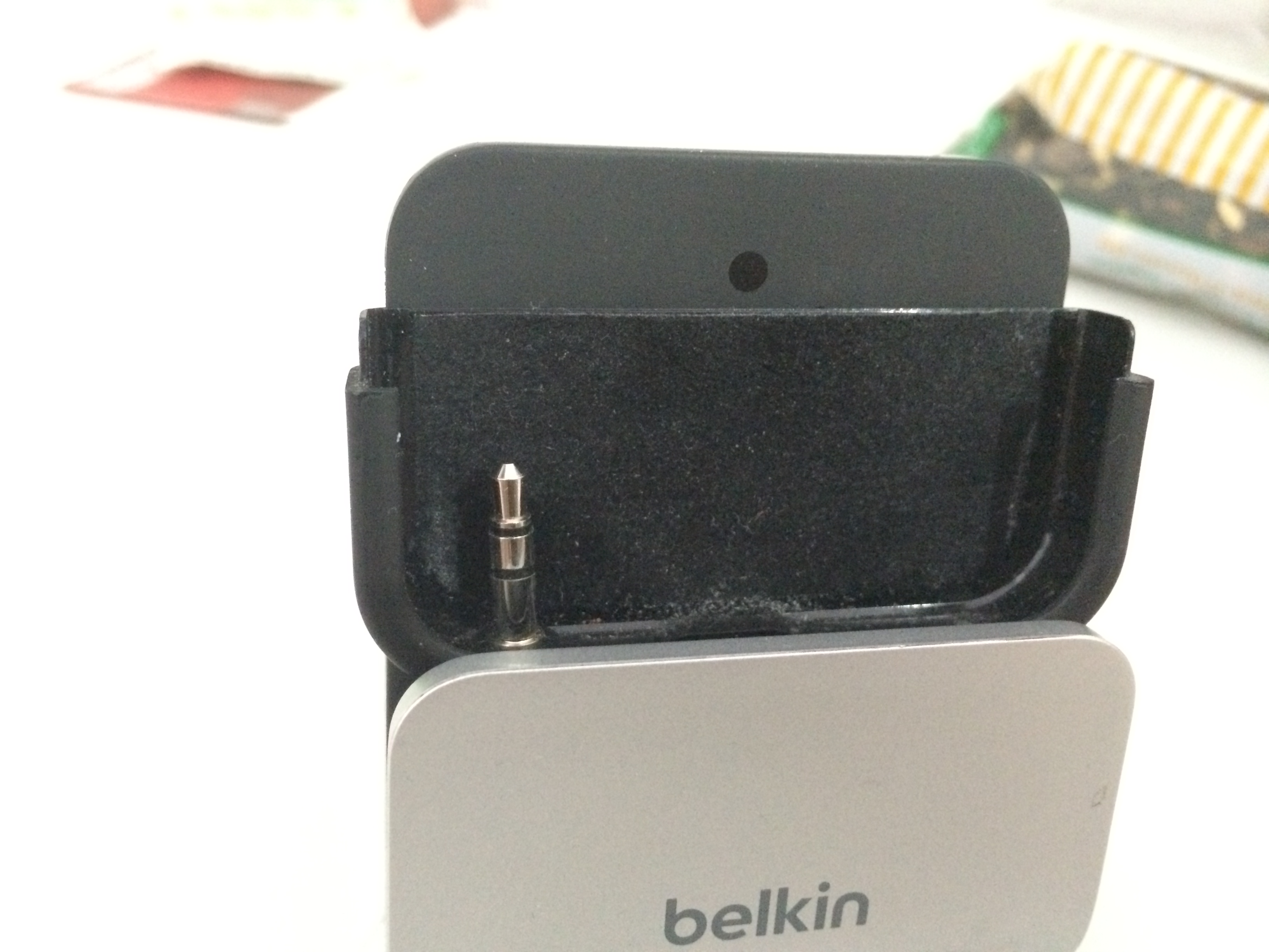

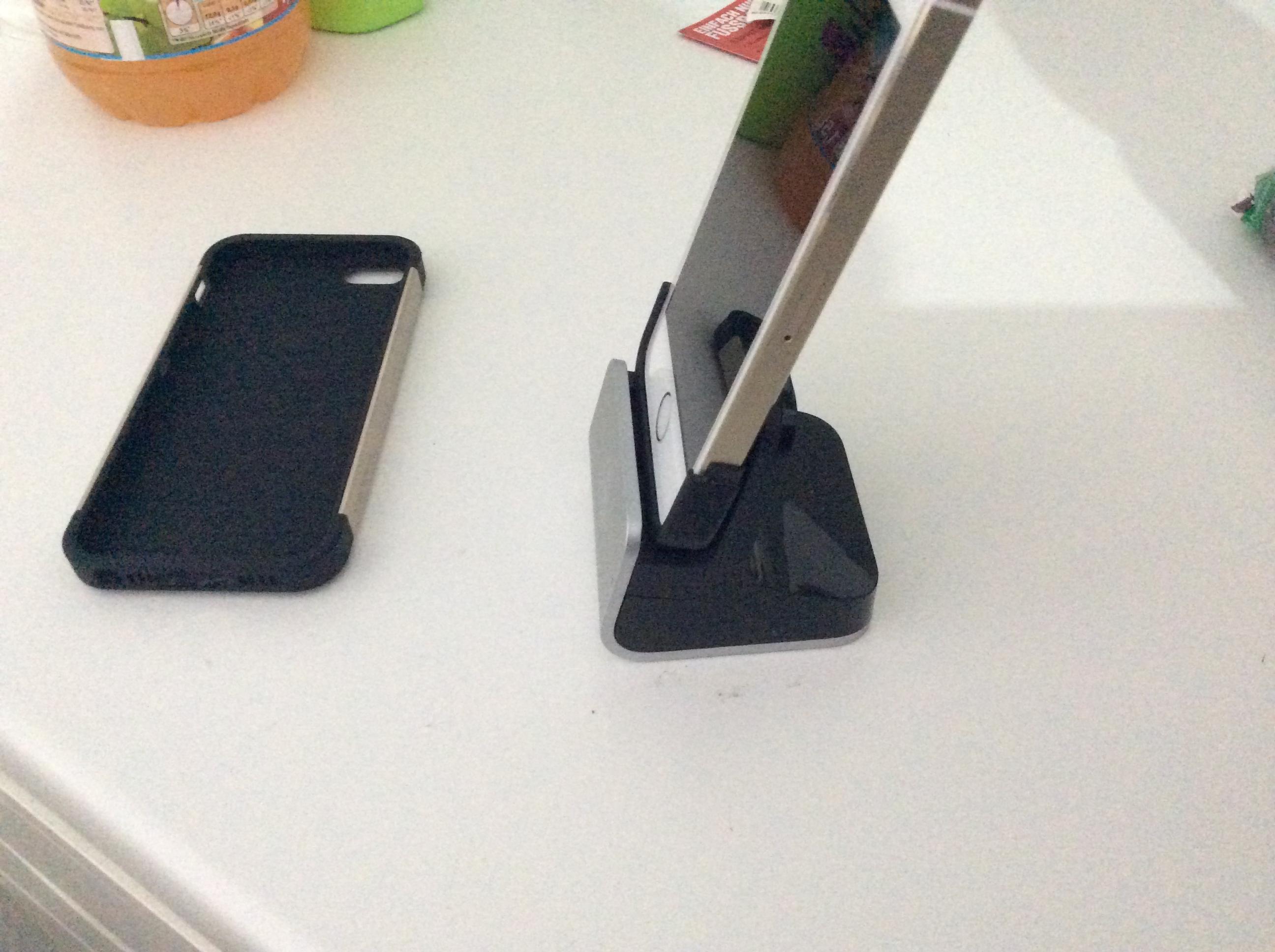

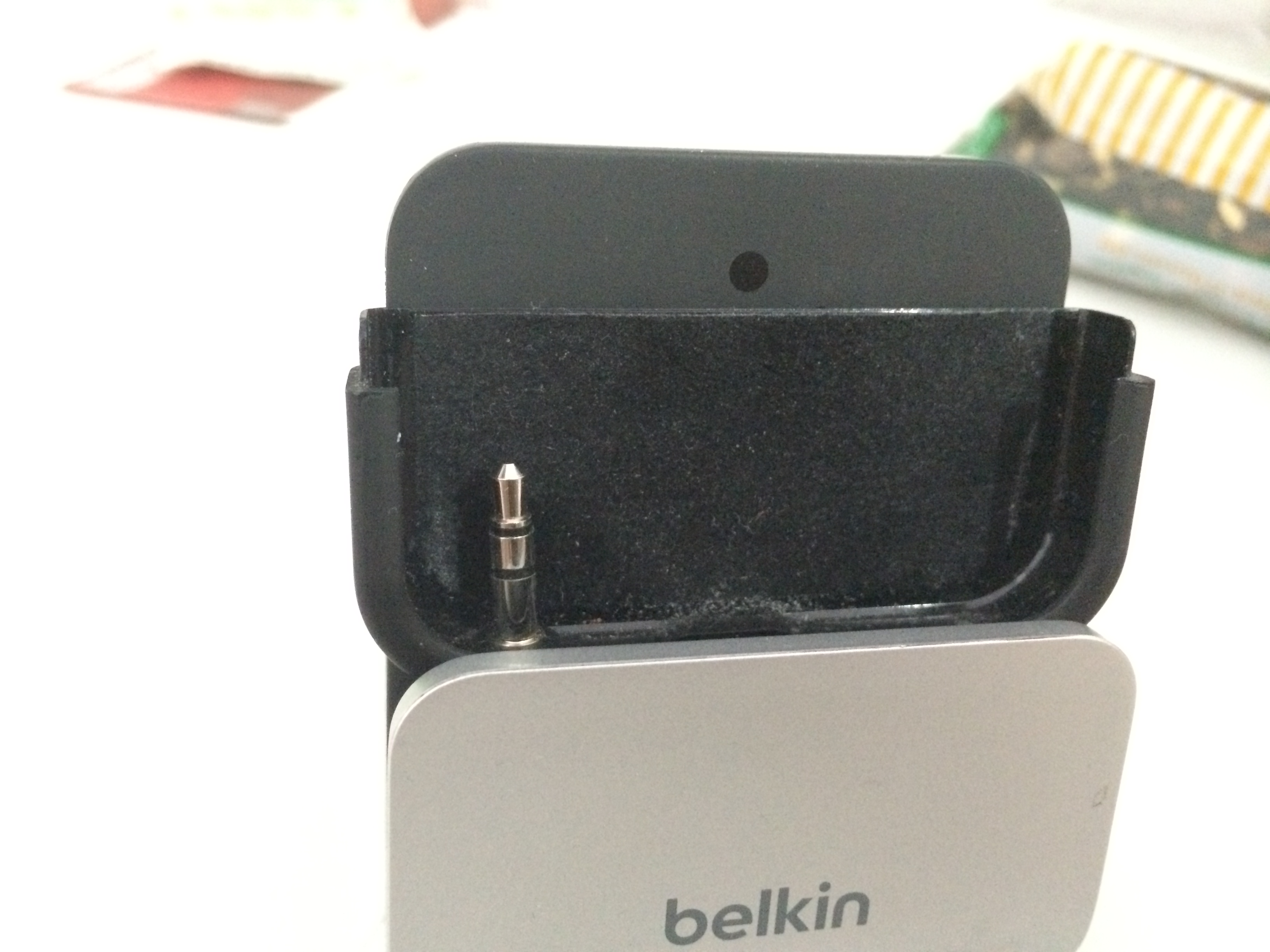

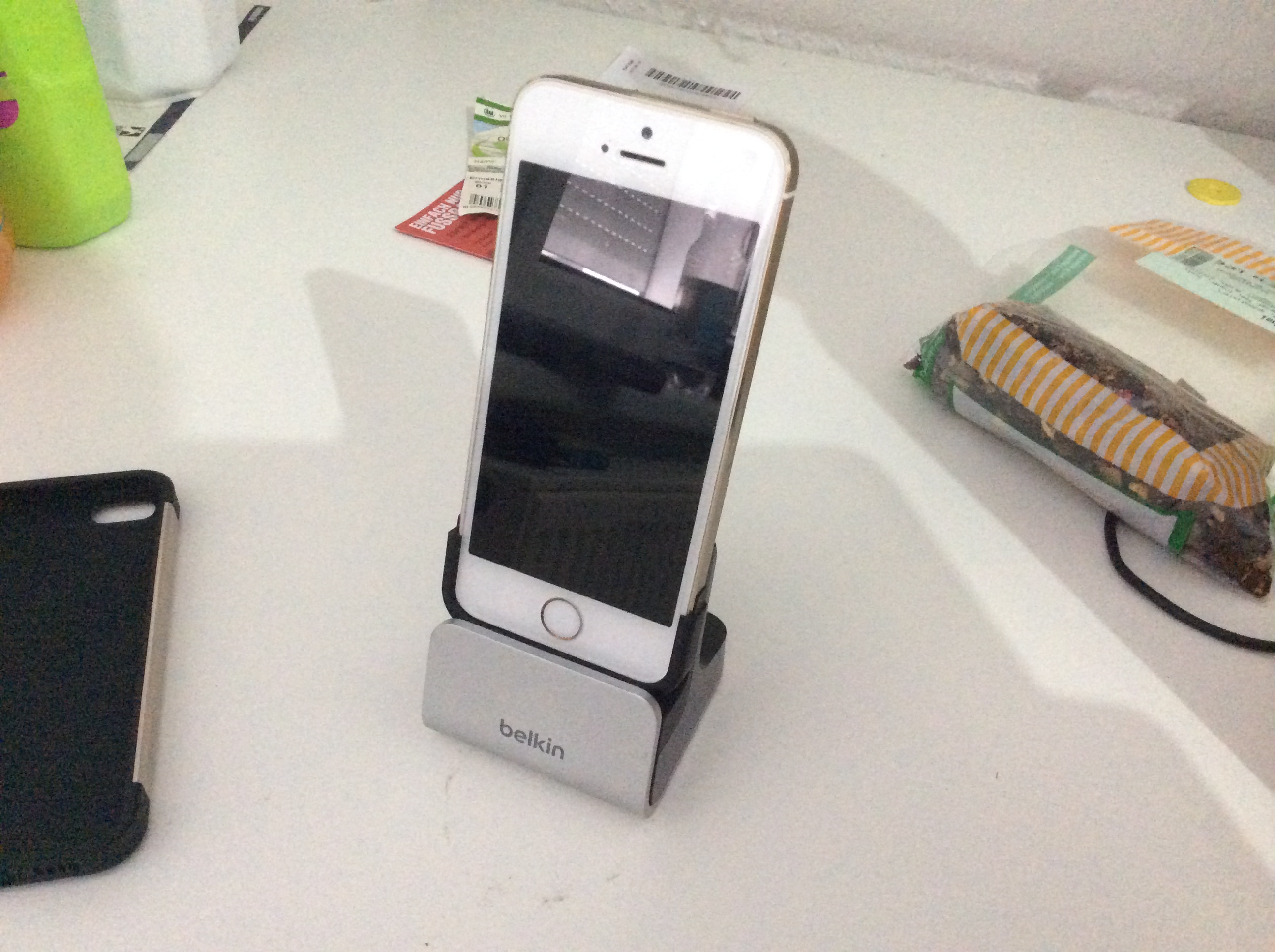

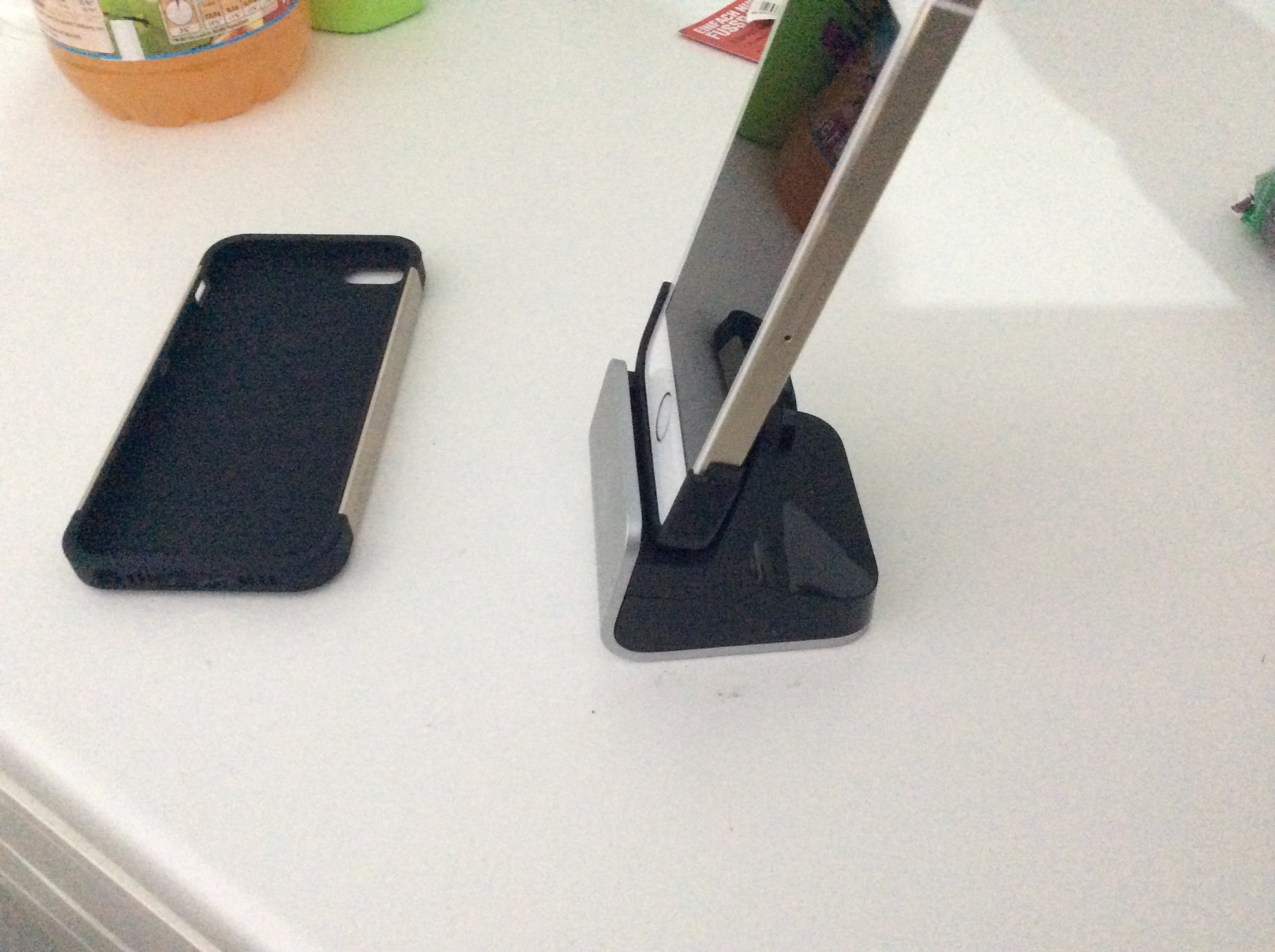

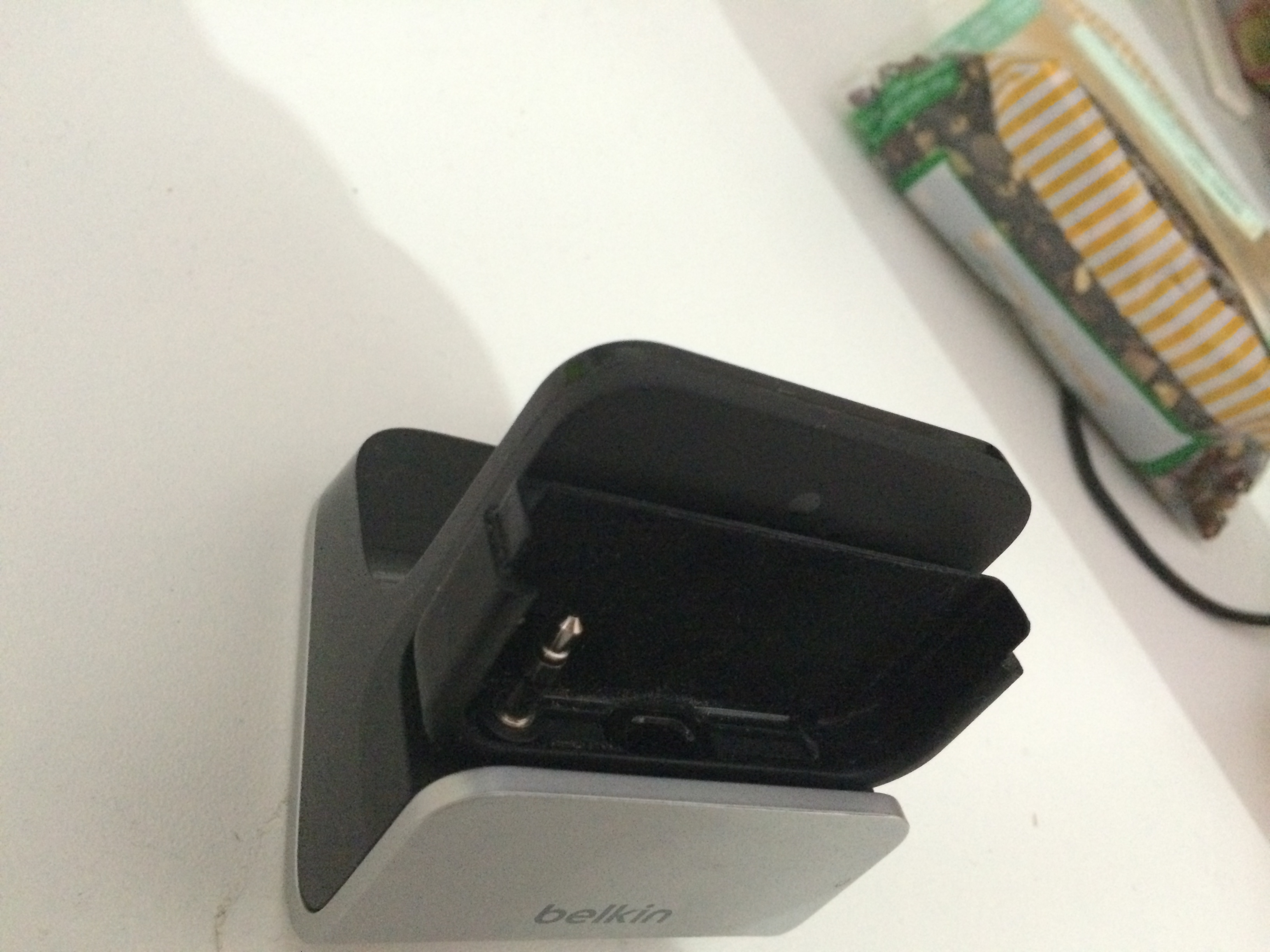

I made q quick mock up of my idea which I combined with your idea. I have a case that's separated into two parts and a Belkin dock.
I attached images of the concept. It's pretty solid fastened in the case, and when the case is glued or fixed to the dock, it should hold the iPhone secure
(Sorry for the image quality, used my iPhone and iPad for this pictures )
Thanks for taking the time to post the photos. Your setup looks like it would work well. I will look for an appropriate case on Amazon.

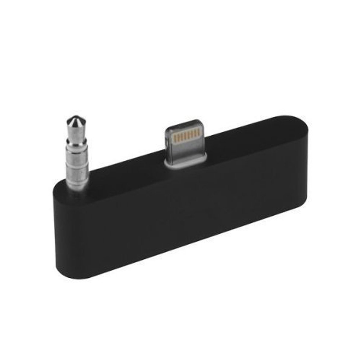

It's time to place my bet. I ordered a dock and an adaptor from Amazon.
Each is under $8 and free shipping with Amazon Prime.
My plan is to fabricate a metal bracket, glue the dock or adaptor to it, attach the metal bracket to the top of the car stereo housing (I will need to cut a small slot in the stereo face kit - the plastic spacer that cover the extra space between the stereo and the car stereo space).
I have a JVC KW-R800BT which has 2 USB ports, one in front, and the other in back. The back port currently has a BT dongle which is tiny and so I think I could move to the front, and use the back USB port for the dock. That way I can run the dock connector (USB to 8 pin) through the face plate which give me a cleaner look. Above the stereo is a good location for the dock as it places the phone higher for navigation.
I wish there were a dock or connector like the one I ordered but with a lightning connector for the back so I only need to drill a small hole for the face plate.
Well, the docks and adaptor arrived. I am not sure either one works. They both require a lot of effort to insert the phone, more so than typically can be done one handed, unless the dock is attached to a solid surface, like on top of the dash board. The other problem is that the stereo/headphone plug takes over the sound output, so I would have to use a patch cable and conned it to the aux in of the stereo. Worst of all, that means I can't use the digital connection feature of the car stereo available through the lighting-USB cable. I may be able to make it work by modifying the dock or connector. Even if I resolve that problem, the amount of effort required to insert the phone remains.

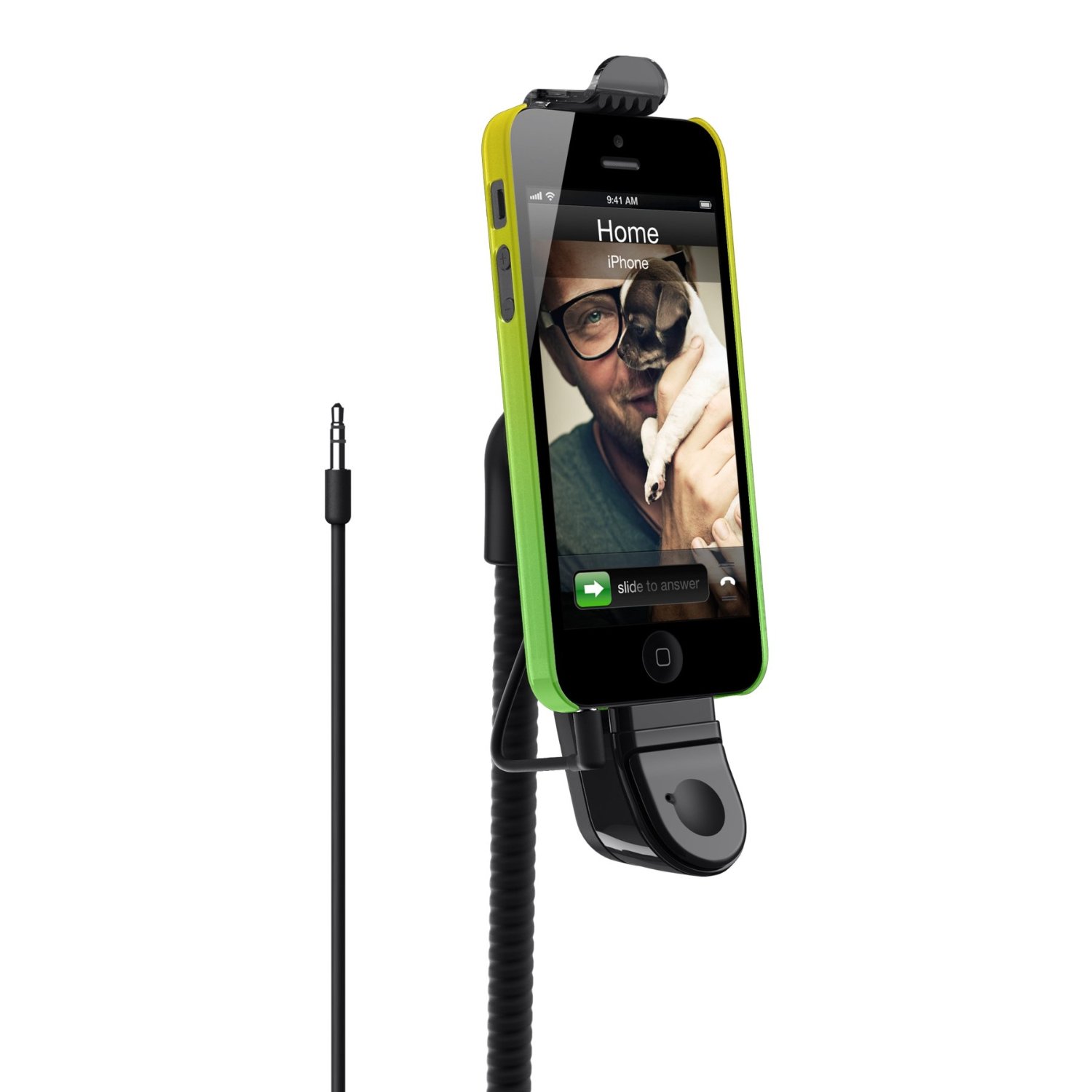

Then I saw this Belkin TuneBase Hands-Free with Auxilary Cable
It looks really good, BUT I am not sure if its Lighting connection is fully functional, i.e. it will talk to my phone and my stereo the way a standard Lightning cable should. If it does, and that the built in microphone at the base doesn't interfere, I am set.
