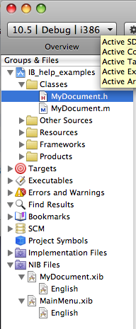

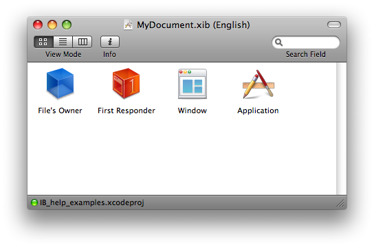

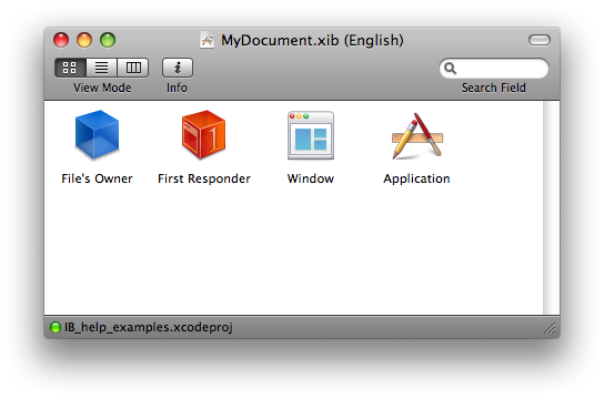

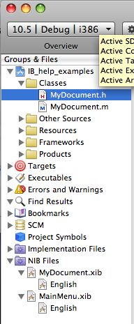

Just following along with Apple's documentation.
Her is the setUp.
My question is this. If I make File's owner ( which has the ivars I wish to use) "MyDocument" then the app works as I expect it.
But, **why** is MyDocument the File's owner. ( By this I mean when I bind the value of a text field in IB to the keyPath of the ivar in MyDocument) Is it the fact that MyDocument.h and the nib file are the same name? Sorry is this causes laughter 🙂
Or to state it another way, I know that the File's owner is the object that contains the outlets I need to bind to, ( if that is the correct terminology) , but I want to make sure I understand the relationship ( from the diagrams I posted) between MyDocument.Xib and MyDocument.h/m. I choose MyDocument as the File's owner because the name was the same...is this the correct reason?
thanks in advance.
In Interface builder, look at the class pane in the inspector for File's owner. An object of this class is instantiated and set as File's owner. This is usually set to MyDocument when you create a new project.
OK...so this is an arbitrary decision? But, most importantly, I guess, is that it tells one which connections/outlets will be exposed to the various "view" elements at runtime? ( If that makes any sense?) Or...a really dumb question. **Why** choose MyDocument as the File's owner as opposed to some other File? I think part of the difficulty I am having is clearly visualizing in my mind the connection File's owner has with the nib file.
So File's Owner is not an object archived in the Nib or instantiated when the Nib is loaded.
It's just a proxy to an object that will be set at runtime. So what object is it a proxy for? Well, that is up to the object that loads your Nib. Whomever loads your Nib will set the owner either to itself or some other object it is working with.
When you set the "class" of File's Owner in IB, you are not creating an object of that class. Or even guaranteeing that the file's owner will be of that class. All you are doing there is giving IB something to read so it knows what outlets and actions *should* be available on File's Owner when the Nib is actually loaded.
It is very possible that the actual File's Owner may be of a different class than what you specified in IB. In most cases that's a bug in your code or a mistake you made in IB. And in those cases if you connected an outlet of File's Owner in IB and the actual owner does not have that outlet you will get a runtime error.
So that's the general idea of File's Owner. Now specifically in NSDocument, if you do not override the method (makeWindowControllers) that creates window controller(s) for the document, then by default it will create a single NSWindowController.
That NSWindowController asks your NSDocument subclass for a Nib name (windowNibName), and then loads that Nib and sets your document as the owner of that Nib. If you are working from Apple's template for Document based Cocoa app, then you will see there is a windowNibName defined in "MyDocument" that returns the Nib name that is loaded for each document.
