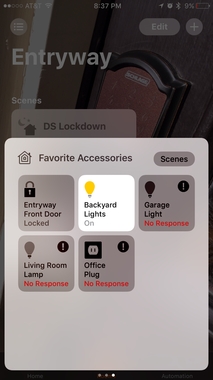

I don't know what happened. All three of my plugs are dead right after 0.8.84. I hard reset them earlier and re paired to HomeKit. Nothing. All three ihome plugs are not responding. My lock and outdoor iDevices switch are fine though.
Apple makes it hard to narrow done issues because for me it will report that the "accessory is not responding" however depending on the accessory I know its actually HomeKit not operating properly. Ecobee for example will show no response but the native app will work fine. Sometimes rebooting my iPhone (although that makes NO sense) will fix a problem with a single accessory even though the rest are working perfectly.
I think the native app with the iHome devices leverages HomeKit so that makes it even more difficult to figure out.
Can you see the smart plugs on your local network under wireless clients?
