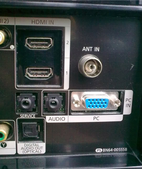

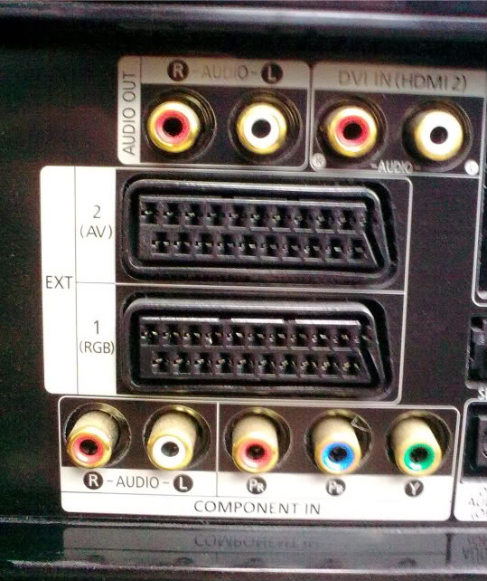

This is what the back of my TV looks like.....
I've looked at the cables on monoprice, but International shipping is $26, so that bumps up the price even more. I'd ideally like to find which generic cables I need so I can buy from ebay or amazon in the UK (if possible?)

Edit: Put the HDMI cable in HDMI 2 on the back of your TV, and the Audio cables right next to it in DVI IN (HDMI 2). Also you'll need this type of audio cable to connect your headphone jack to the red & white audio inputs on the tv: http://bit.ly/1UjdjM (UK ebay)

From what I can tell from the pics you posted of the back of your system that is not the correct audio cable. It appears to me that a stero-mini to stero mini cable will only work with the VGA connection, for the audio cable if you are using HDMI I believe you will need a stero-mini to RCA cable like the one pictured below. This audio cable plugged into the RCA inputs labeled audio-in for HDMI 2 along with the HDMI cord plugged into the #2 HDMI slot should give you the system you desire.
