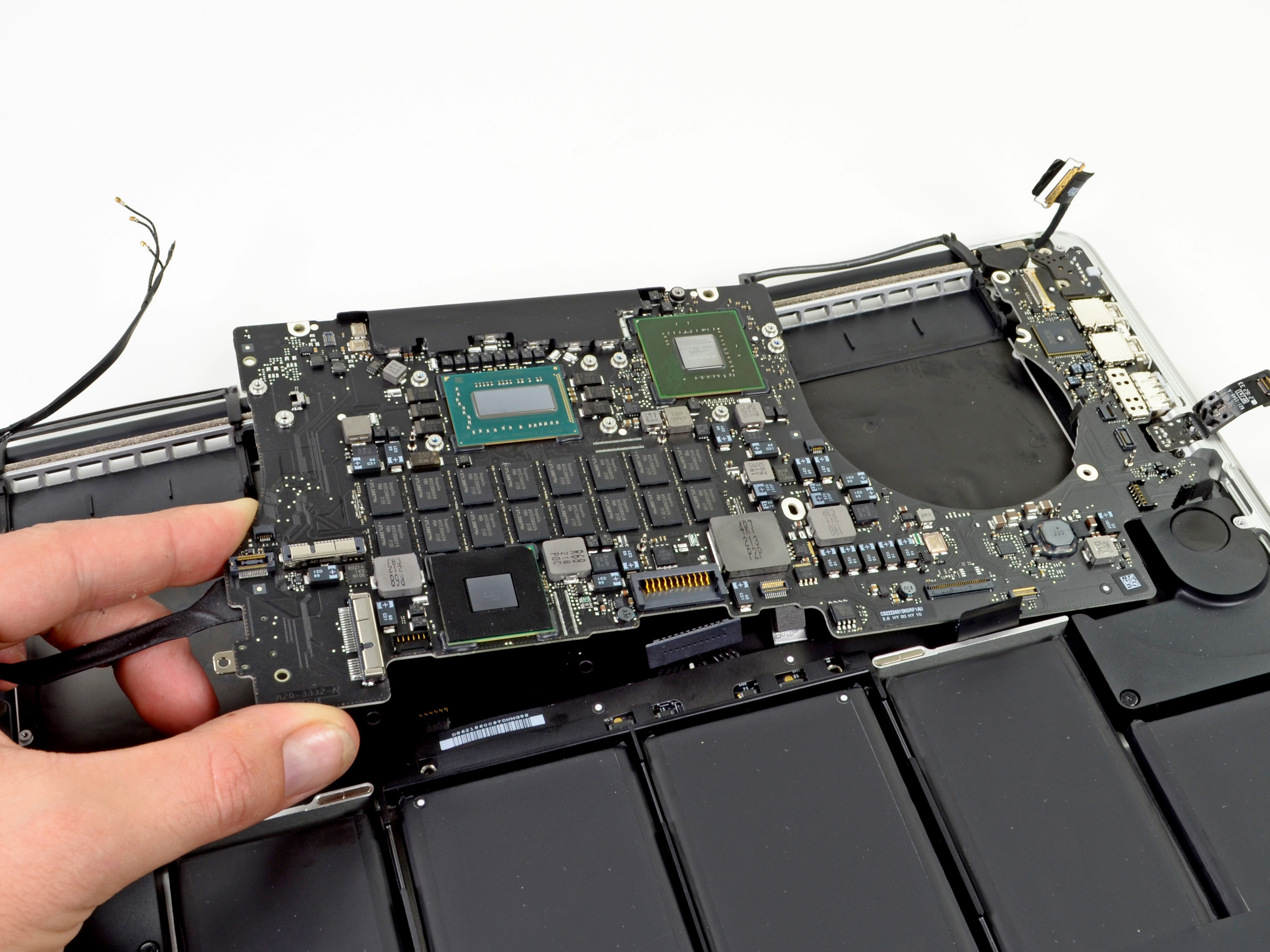

my best friend google told me that the minimum fan speed for the MBP's is 2000 rpm.
But what I noticed is that my left fan always spins faster then 2000 rpm (about 8%).
(I'm using the iGPU (HD 4000), not the GT650M (which is located at the left fan, as far as I know) see image below, rMBP upside down, so right is left 🙂 )
Does anyone know why my left fan won't spin @±2000rpm?
(@rMBP users, can you guys post your idle fan speeds? thanks
ps: max fan speeds are also welcome, they should be ±6000 rpm
right: 5498 ~ left: 5965)
(2.6GHz i7)

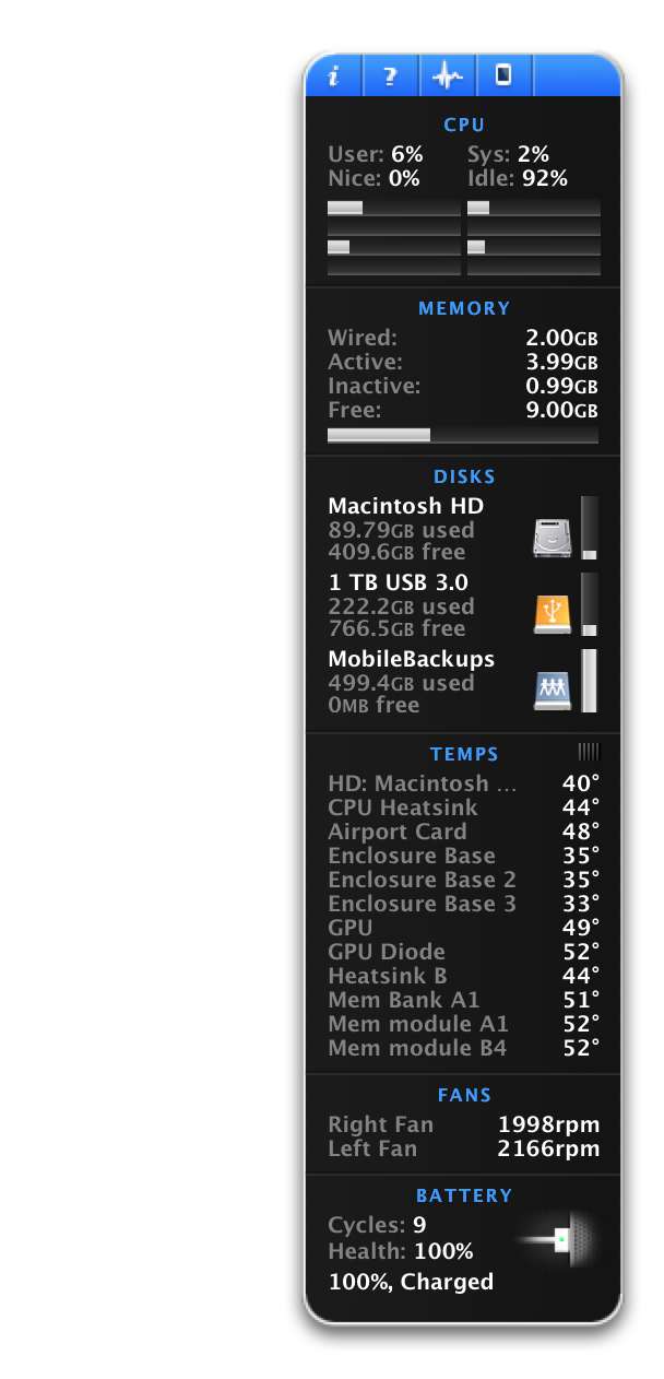

Right Fan : 1997
Left Fan : 2164
Courtesy: iStatPro
GPU : Integrated
CPU Temp : 33 C
GPU Temp: 35 C
Usage : Spotify ; Outlook ; Excel ; and Safari with a few tabs.
Standard mac behavior.
The fans will normally run at about 2K.
This app can control the speeds but it can only set the minimum fan speed, not the max.
Complete speculation but if you're questioning the difference in speeds, could it be the shape of the heatsink covering both CPU and GPU? The CPU is centred but the GPU is off to the left, right?
Yes, but, I used gfxCardStatus to make sure I was only running on the integrated graphics...
So the GPU shouldn't be warming up...

The heat pipe design of the rMBP is unbalanced. The GPU shares the same heat pipe as the CPU, so the one side will be hotter; causing the one fan to run faster.
The cMBP, on the other hand, has the heat pipes centered between the CPU and GPU. The heat transfer is evenly distributed. Consequently, the two fans run at nearly the same speed.
The fans speeds are offset in an attempt to reduce the pitch of fans running at the same time. Fan blades are asymmetrical as well for the same reason, to reduce noise.
