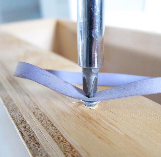

I just remembered that I tried examining the fan several months ago, but the fan screw is stripped..now I remember why I didn't replace it before. So, if the fan is dead and can't be replaced is the only other option to replace the motherboard?
Try removing the stripped screw with a rubber band or by gently sawing a line into it and removing it with a flathead screwdriver?

Thanks for the suggestions. I was able to get the screw out! The rubberband trick didn't work, but I was able to use a small knife and carve a groove until I was able to turn the screw with the knife. Inside the fan was a big dust ball. CPU is surprisingly cool now, ~50c, but I did have it off for a bit while working on the fan and it was on a cool surface. I'll just wait and see if the fan comes on now.
