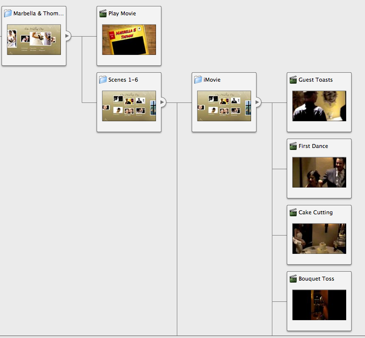

I have an iDVD project created. On the main menu, the options are to "Play Movie, or go to "scene selection". The option for "Play Movie" (see screen shot below) has a short couple second image that was part of the theme i had selected in iMovie. I like the theme/layout i have no from iDVD much better... but cannot figure out how to remove that image. It looks cheesy to me now. Selecting and deleting that box/item removes the menu option of "Play Movie". I want play movie to just go right away to the movie.
I"ve tried searching this in iDVD help and online, but can't find this. Any help appreciated.
If you exit that Map view and go back to the main Project window, you should be able to just drop an image of your choice to replace it with.
As an aside, the very first box(on the left) in that view contains a copy of your video. This mean that it will auto play the video, without showing the Menu, when inserted into a dvd player. To stop that, just click and drag it out of the box.

Thanks for the reply Dave,
I finally did figure out how to replace that, thanks. And thanks for the aside about the first box causing auto play.... it seems odd that it would do that by default, causing confusion about why the menu system does appear. Yes, i had shared it from iMovie... which i guess is the cause, and was also the cause of the other cartoon theme effects that i had wanted to remove.
