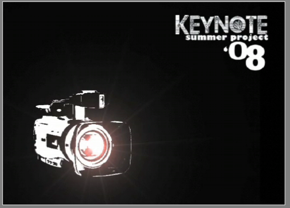

Ok, so I've read some stuff about the encoding in iDVD upon burning to a disk, but I still haven't quite figured it out. Whenever I hit 'play' and watch the preview, it looks good. But when I burn it, there is a loss in quality. I have the encoding set to Best Quality but that didn't help much as far as I can tell.
So is there anyway to burn the disk without the quality loss? Thanks.

The DVD isn't that long: there is a 15 second intro video (which is what I mainly notice because it's a graphic in motion) and then 3 videos about 4-5 minutes each.
And I have watched the DVD on my computer in the same resolution, it doesn't look as crisp as before it's burned. Here are two screenshots of the quality before and after burning:
Before:
After:
Before:
After:
Hmmm, I see what you mean. It seems like your resolution stays the same, but the compression is making the objects look softer. It may be unavoidable as iDVD might be using a "consumer" algorithm for its MPEG2 compression so that it takes less time on "consumer" strength computers. On a CRT screen you probably could not tell the difference, but on an LCD up close it could be a different story.
